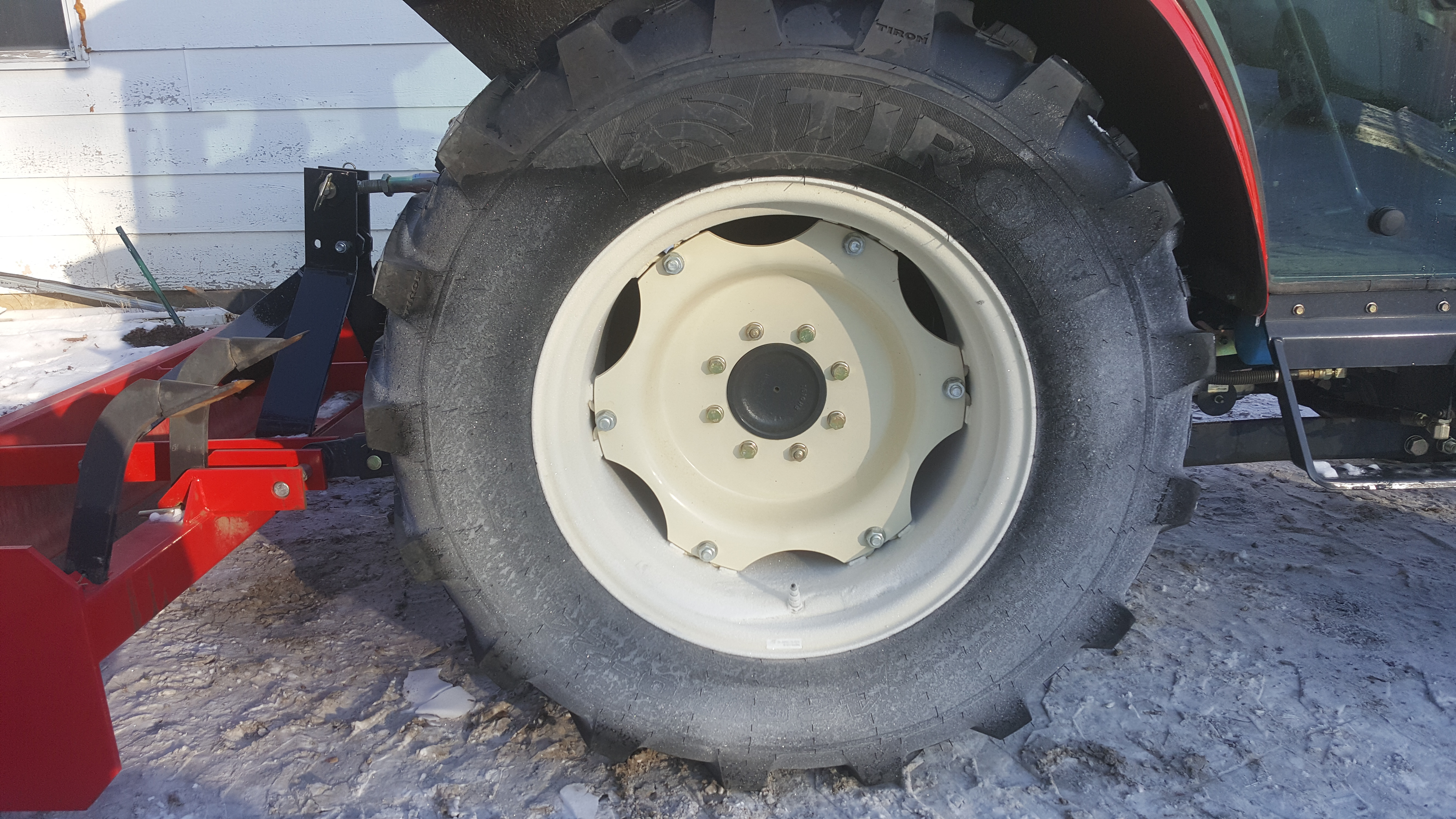

I believe most tractors come shipped with their tires set to the narrowest spacing. It's a shipping thing. Fit more cargo (tractors) into less space. I believe it's then up to the receiving dealer to adjust the spacing on tractors sitting on their lots.
If you look at the rims of the tractor you're looking at, it should be pretty obvious by looking at the rim pattern that they either can, or can't be widened by flipping them.
Here's a pic of my back rim, pretty obvious on this one:
I don't have as good a closeup of the front rim, sorry. But you should be able to see the center section of the rim is offset (or dished):

Thanks for the pics supporting the explanation Slim. I measured the mounting face to the tire edge on both sides and found negligible difference. Will leave as is unless I decide to do spacers at some point. Appreciate all the responses.

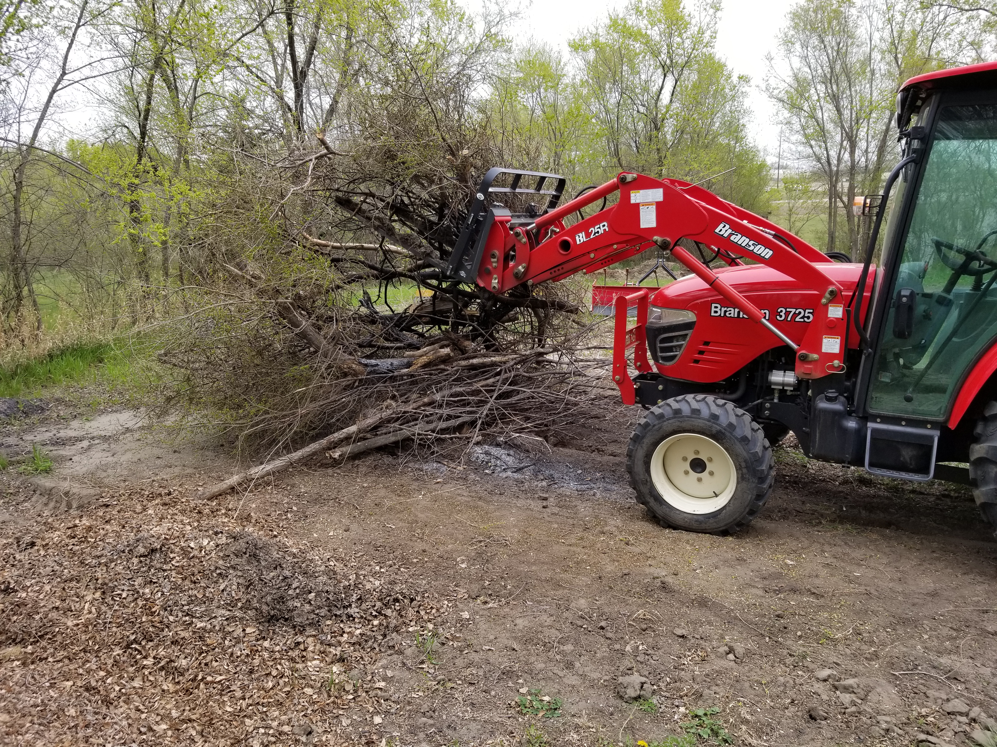

I've found if you mash a pile of brush with the forks and move back and forth a foot a could times, the brush gets locked together really well and can be carried without losing much of it.
I'd like a grapple but similarly I can't quite justify it (yet?) especially with how well the forks manage.
(For brush, I set them at max width; the forks are 48".)
Thanks for the replies. Same boat here... cost:benefit. I do pretty well with brush just using the forks though I know the grapple guys love them.
