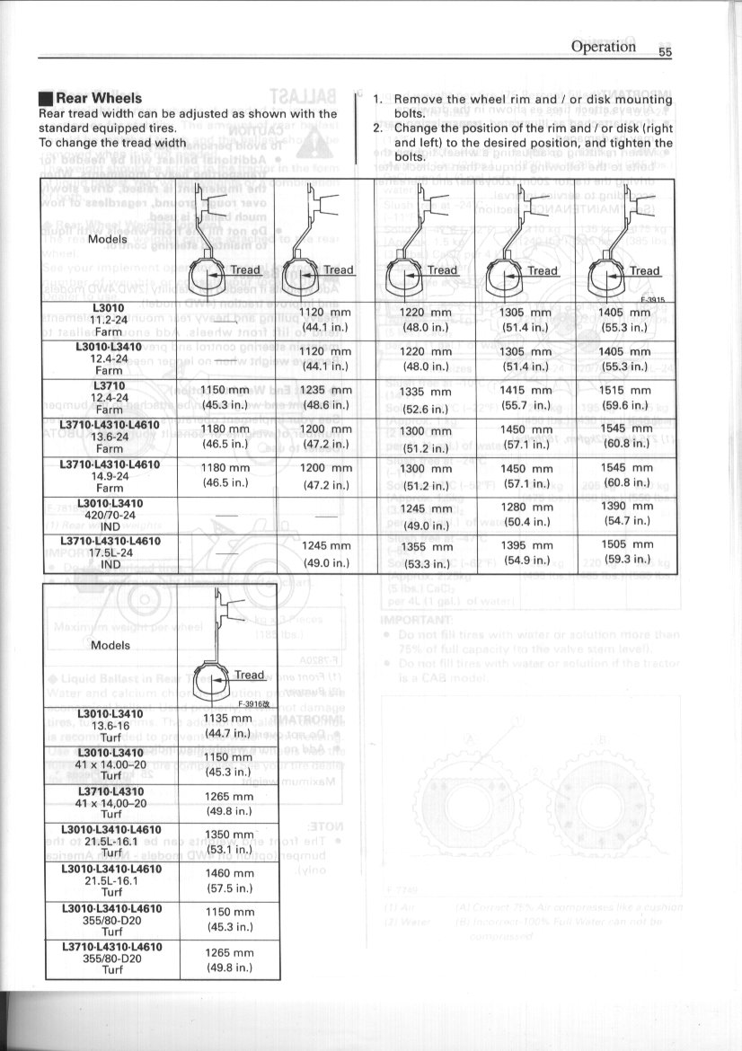

I am considering either a L3410 +FEL w/ HD bucket or L3710 + FEL w/HD bucket. Could someone report the overall width on these tractors w/ R4 tires ? I know the HD buckets are only 60" vs 66" on the std bucket. I think my facts are correct. Also, with the HD bucket running a few inches more narrower than the rear tire width, does this pose a big problem when clearing snow? Is there a noticeable difference using the HD bucket over the std bucket, lets say, when scratching 3' off surface or pulling bushes out in reverse with toothbar attached?

Here is some info I came across on tire widths.

don't forget to add the width of the tire to the dimension in the chart. The L3410 R4's are 420-70-24's and measure about 15 inches across. The L3710 R4's are wider still by an inch or so.
Mine are out all the way and it is pretty wide...(and stable).
John Bud
   / Rear Tire Width on L3410 and L3710 #5
My 3710 rear tire width with R4's is 66" and are set at the narrowest width. The standard kubota bucket (66") is of very good quality and I have had not complaints. I too use a toothbar and the standard bucket works well. I have never seen a HD bucket. If I had to do over, I would probably get a Woods loader with the optional quick-attach bucket. The Woods buckets also seem to be well built. I prefer to have the bucket at least as wide as the rear tires.
