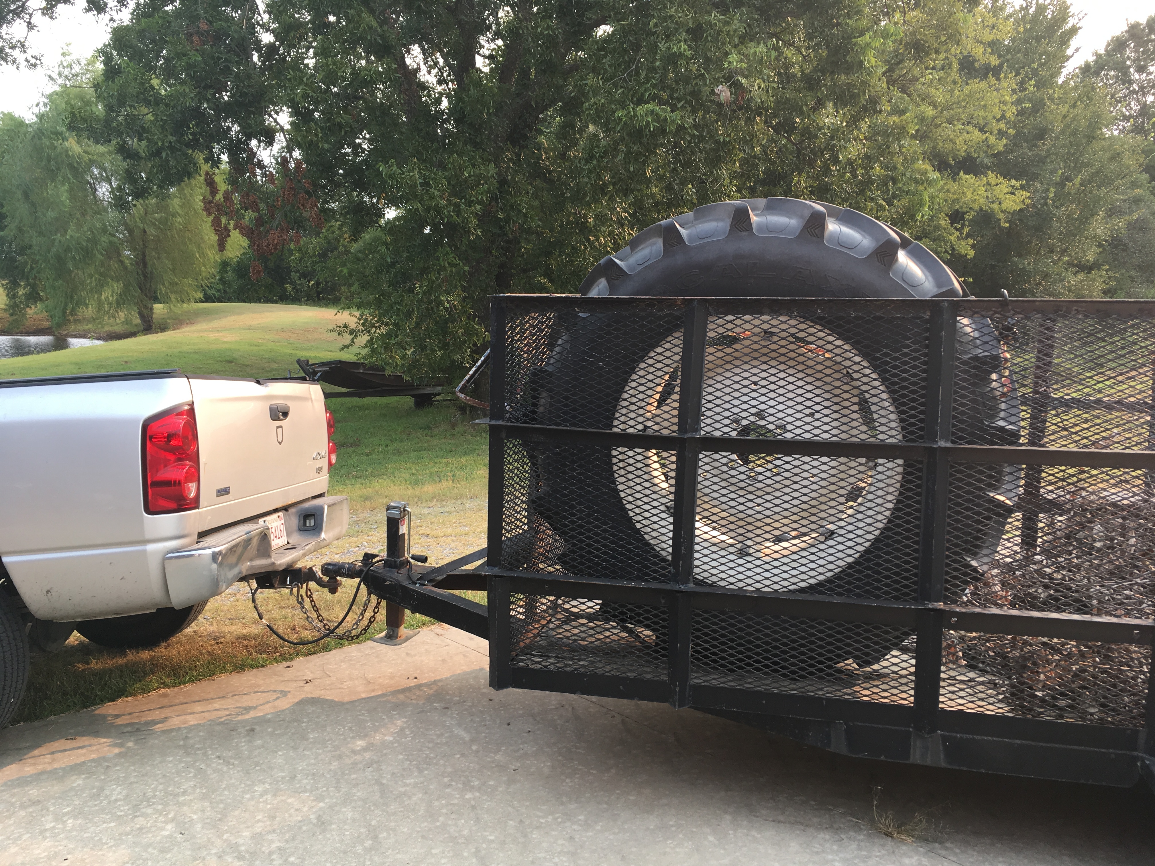

Can't find the front and rear tire bolt torque rating anywhere in the operators manual. Front tire is 14.9x24, 24 mm bolt. Rear tire is 18.6x34, bolt is 27mm. Tractor is a NH TD5050 rated at 95 HP. Anyone have any info on this guy?

Thanks oldtink - yes it took a 24 & 27mm socket to remove the lug bolts and take the tire off. I got the tire patched, it cost $45 and took him about 30 mins. Wow that's a process to remove the tire from the rim - I don't think I ever want to do that, well worth the 45 to let him do it. I was informed for about $100 they will come to you, that would be nice not having to lug that huge tire around. I called several dealers. One gave me an answer - 600ftlb - but that sounded high. 1 said I had to come to them and read it out of the book - no answers over the phone and 2 more didn't call back. I believe the shop manual is $300 and I can't find it in the operators manual.
