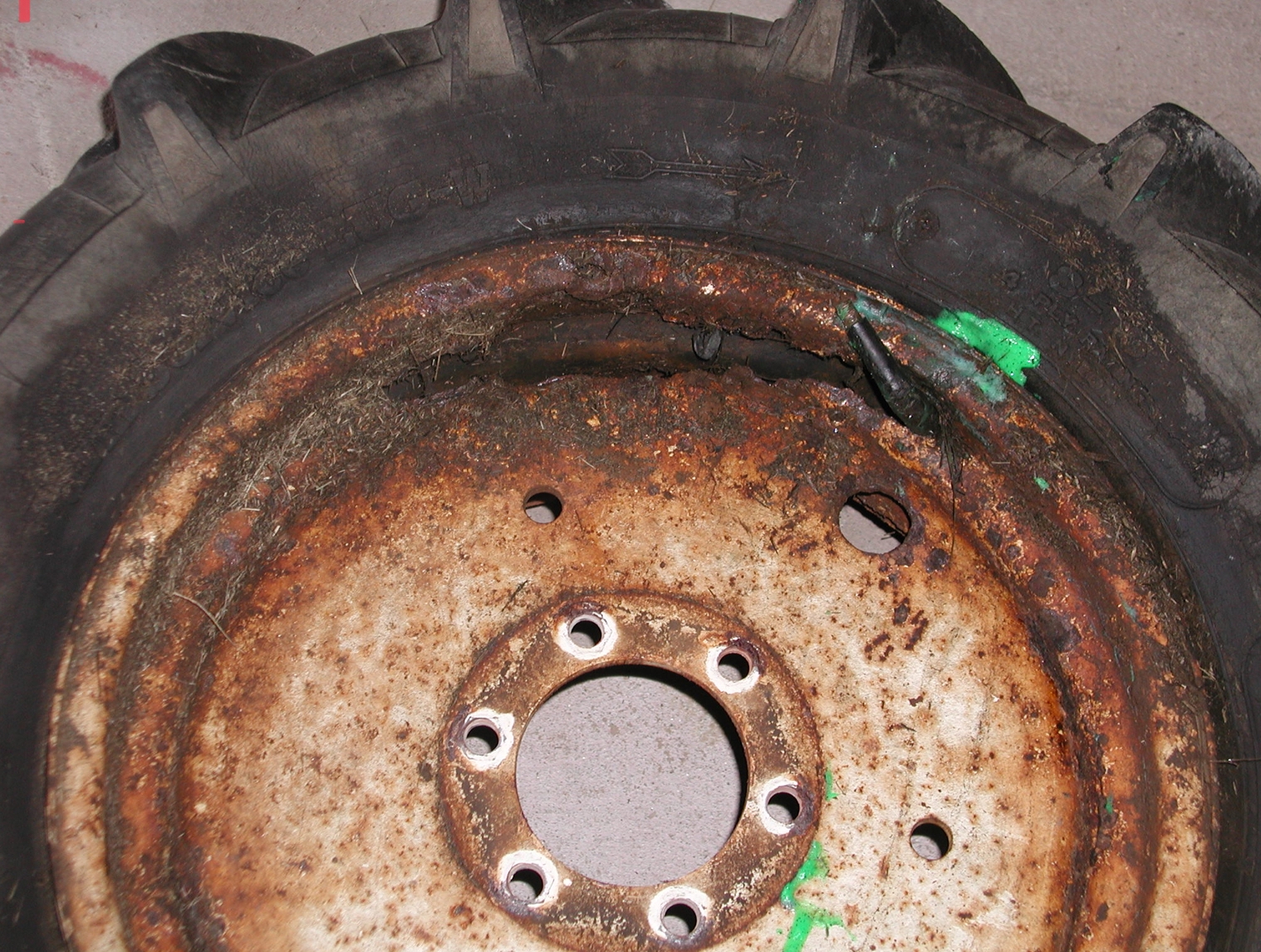

I use water and antifreeze, my Father and Grandfather didn’t and have either had to repair rims or replace them altogether because what they used cause major rusting of the wheel when the tube is punctured. Generally the worst around the valve stem.
I’d rather run around dry and add weights than deal with rusty rims.
This one‘s not mine but an example of why you might want to avoid weight that can also cause corrosion.

Likely not due to water but rather due to calcium chloride which is ver corrosive.
