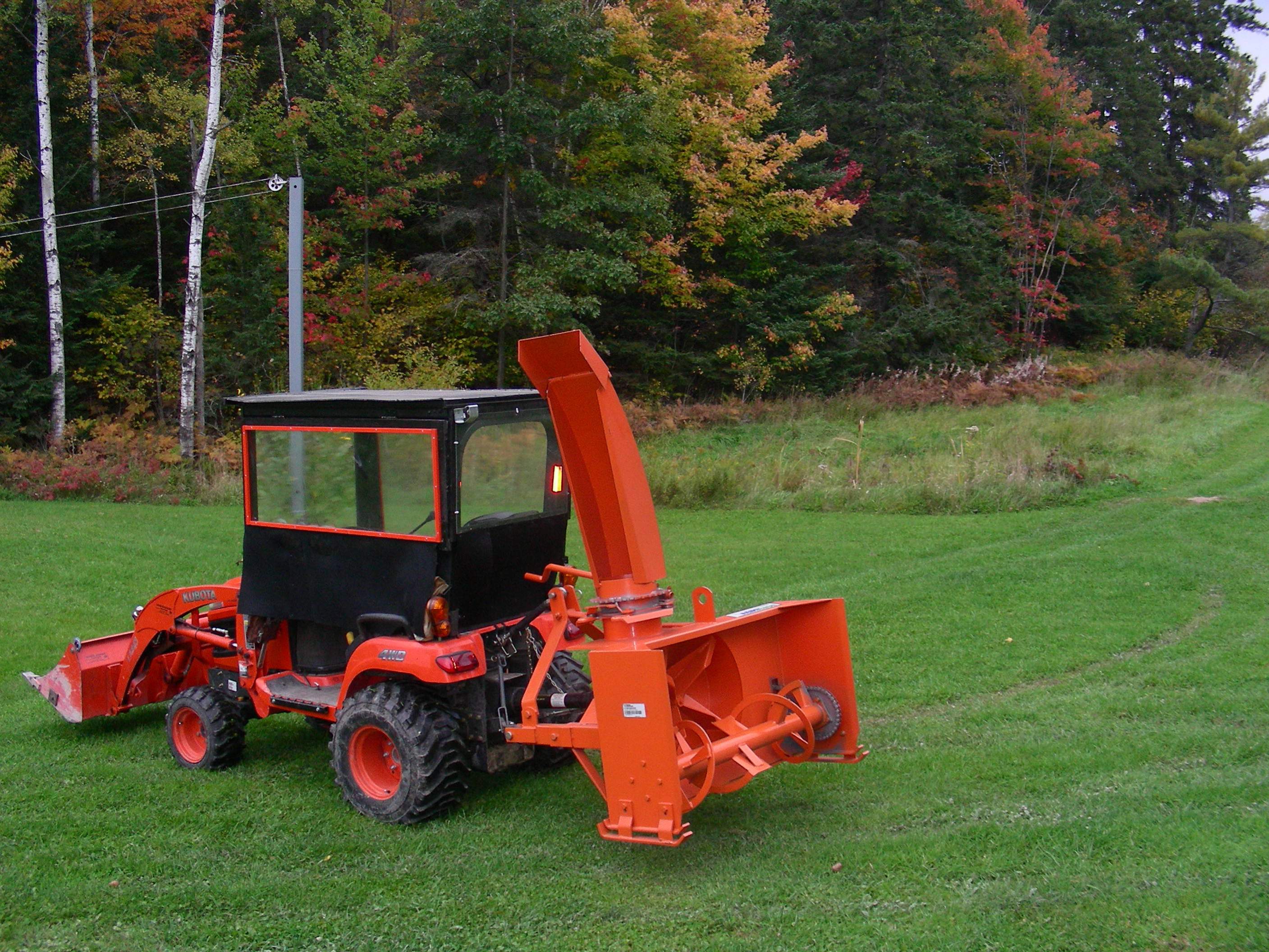

I went with a 51 inch rear snowblower see picture, 2 seasons now, I don't mind the rear facing aspect because it is far to advantageous to have bucket still usable . At times when pushing back my banks or fine tuning around obstacles, need the bucket...or back dragging sidewalks down to concrete , or digging in areas you are not sure if anything is on ground that would otherwise clog blower............mine is an AgriEase
