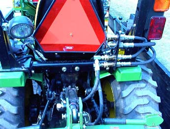

Hey, I'm interested to add rear SCV for ,say, 3pt hydraulic top & tilt cylinders. Would JD offer this option as a add-on DIY kit? Any idea what would be a fair price for this rear SCV kit? I'm interested to use a diverter valve and loader joy sticks to control the rear SCV functions.

JD does not offer a rear SCV kit for the 4115, they do however offer a kit to plumb the Mid-SCV to the rear. The best bet for a TnT setup would be through CCM . They offer a nice kit with a joystick type valve that mounts on the ROPS. You will still probably need to get the Power Beyond kit from JD to supply fliud to the new valve.
I have a Diverter on my FEL curl ciurcit to operate my FEL Snowplow and soon to be grapple, I think the plumbing required for 2 of them to operate a TnT setup would be a nightmare. and would end up costing more than the CCm kit in the end.

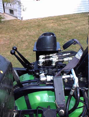

I just added my own dual SCV and tied into the power beyond connection points. This added two sets of outlets in the back. See attached picture.

Back Connections

Nice looking setup Randy!
You still needed the Power Beyond kit from JD correct? I have been wanting to do this also but cannot find a SCV that I like, They all seem to be huge!
