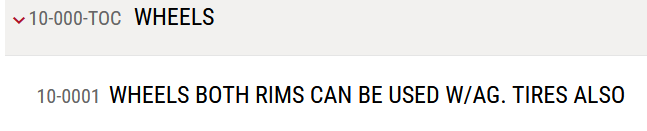

those tire measurements are correct btw and ag tires will fit same rims also.
