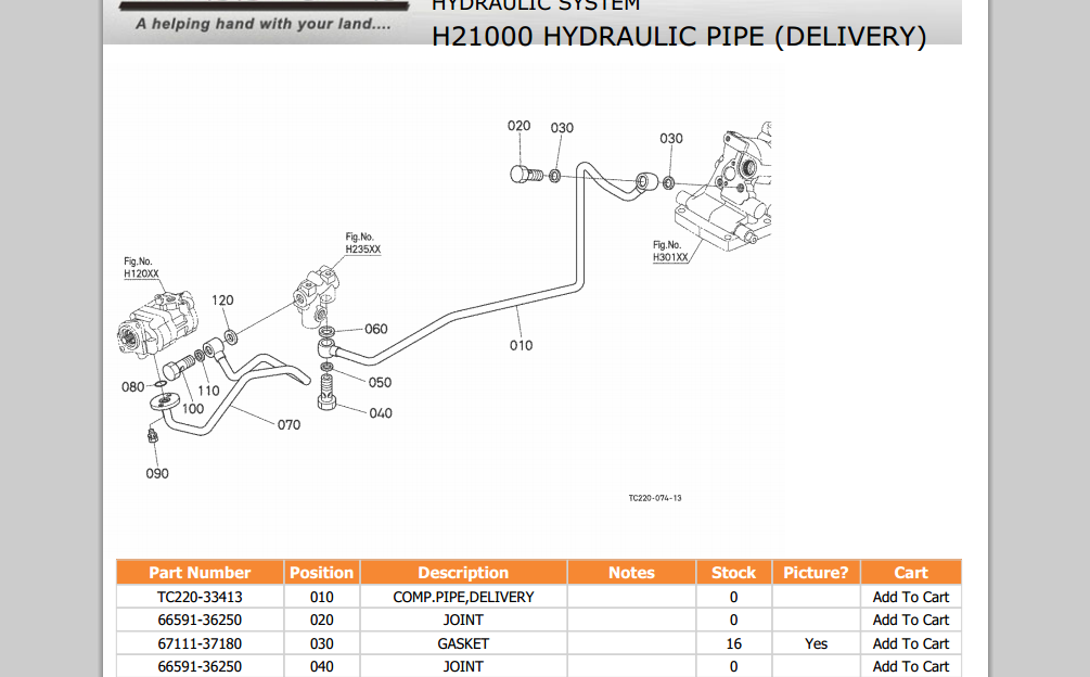

I've looked at a lot of posts about rear remote hydraulics but haven't found what I need. I've got an L3200 with a FEL. I see a need for a single rear remote but want a second in case I need it in the future. I'm thinking a "Float" on one of them. Does anyone have pictures? Detailed instruction on where to tap the existing hydraulics? A parts list would be very helpful, also. What type of valve or spool? I've been working with hydraulics on tractors for 50 years but never installed any and don't really know the terminology related to valves, spools, etc. Any help will be much appreciated.

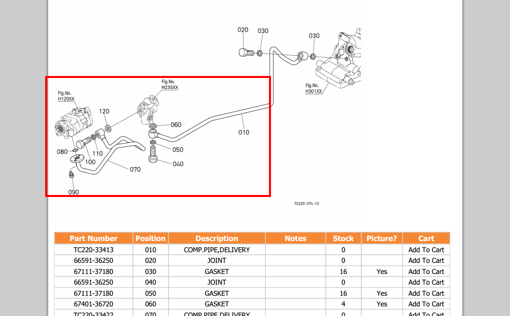

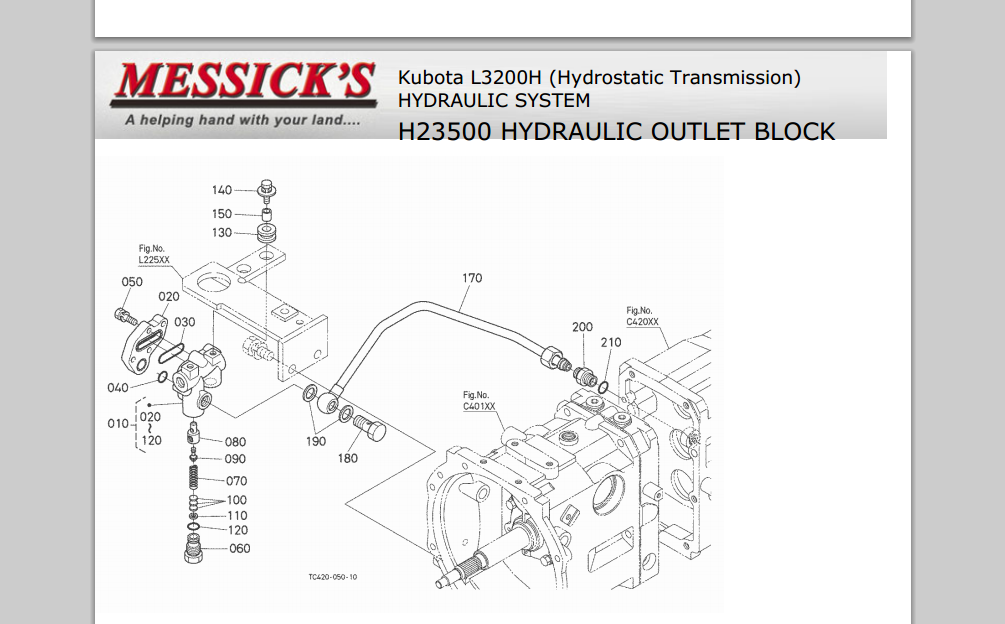

   / Rear remotes #5
Below is a pic of the hyd block for the L3200 hyd block.
Line 010 is the supply line you need to cut and install swage fittings and connect to the IN port of the new two spool valve.
Line 170 is the return line you need to cut and install swage fittings and install a tee for the OUT line from the two spool valve.
Line 070 from pump will feed the hyd block.
PB port connects to the cut line 010 to the 3pt.
The series path is now complete.
The tractor relief is on the bottom of the hyd block and this will set the tractor pressure.
Re-check the master relief valve for correct pressure and set the new valve the same.

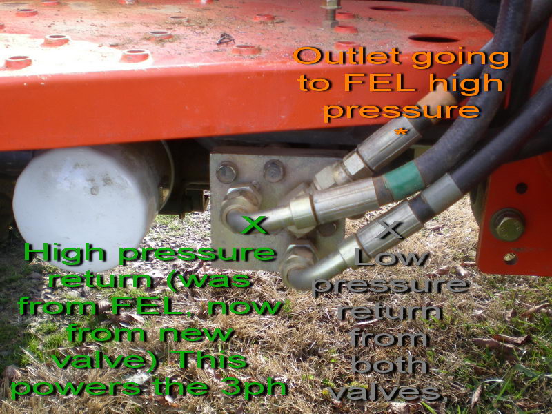

   / Rear remotes #9
Let me regress here and say that I don't know how someone did your FEL valve, but looking at the plumbing, the remote has to be inserted before the 3pt.
They may have cut into the line and inserted a FEL valve, and they may have used some ports on the hyd block.
Can you show a picture of your hyd block?
In general, the remote can go anywhere in the series path, as long as the PB from the upstream valve feeds the next valve.
The first valve or hyd block that sees the pump fluid, may have the master relief valve, and on this tractor, it is in the hyd block.
So now, you will have 3 relief valves.
Main relief at hyd block.
FEL relief.
Remote valve relief.
The 3pt would have used the main relief on the hyd block before any attachments.
So what is going to happen now is that the remote relief will see the first relief upstream on the remote valve and pressure from the 3pt will be relieved.
   / Rear remotes #10
This picture is not mine, it's from someone here on TBN, can't remember who. See if your loader hooks up like this. If so you don't need to cut any hard lines.
