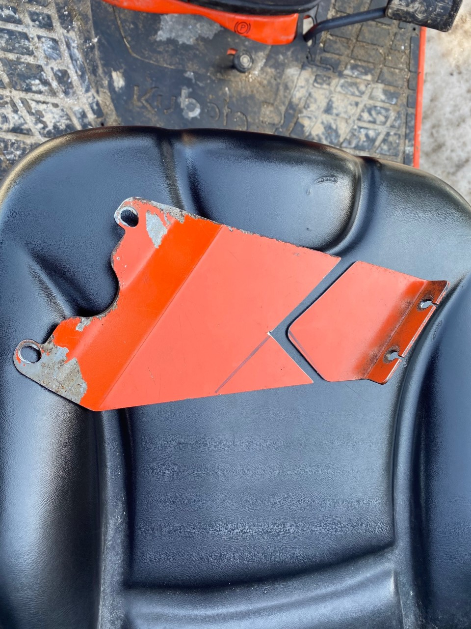

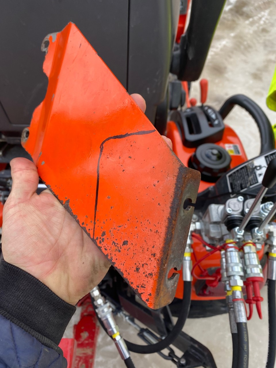

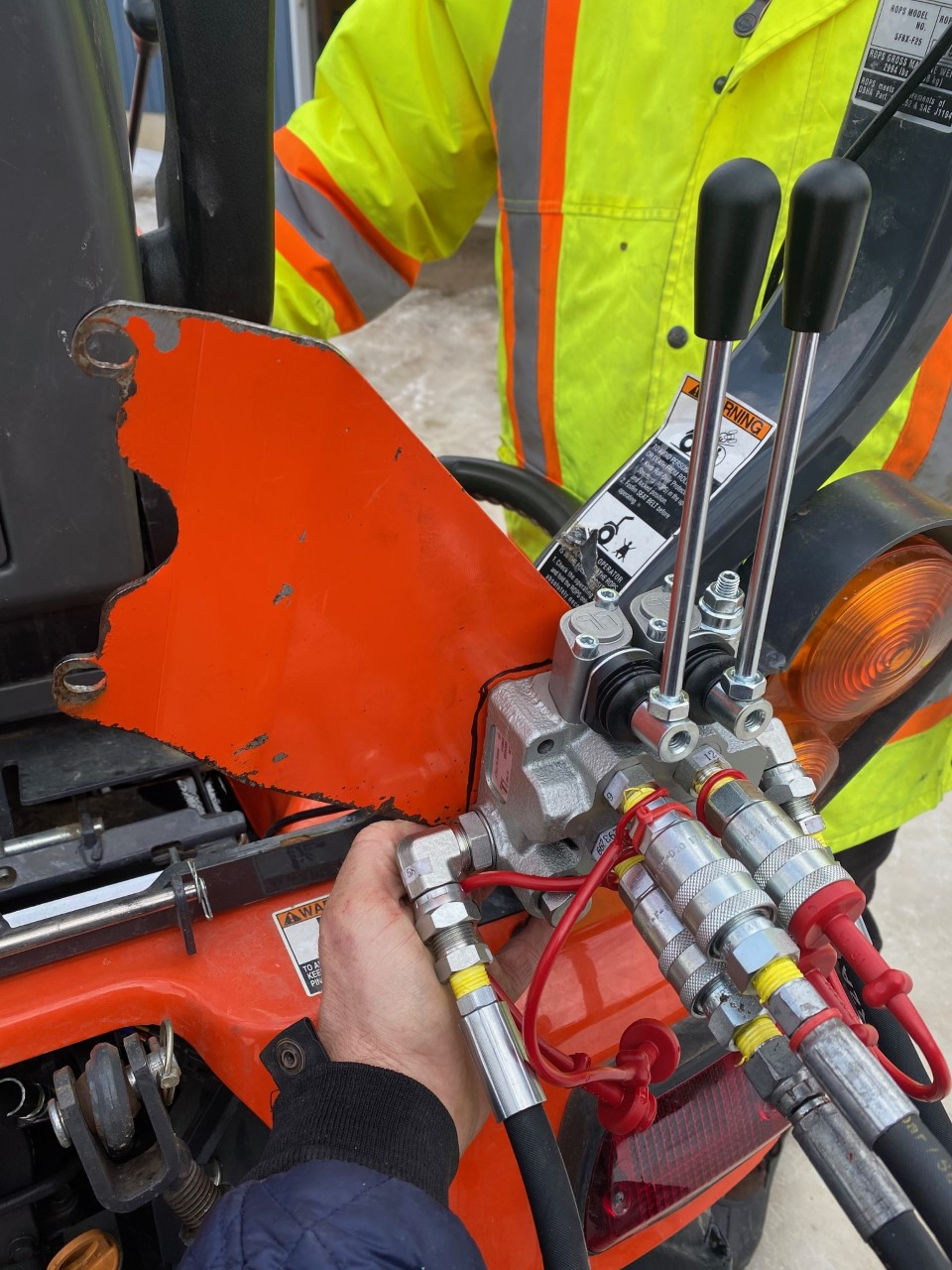

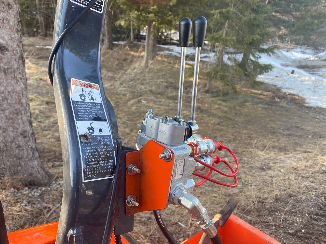

Sorry for the delay, I had to e-mail some images around to myself from another device which took some time (country internet). If you follow my channel, you know I just replaced the auger support bracket on my BX2755HD because the lower bolts appeared to have come loose causing a bit of wearing/elongation of the mounting holes. Turns out the elongation is from factory but it was hard to tell. The bracket part number is 7006001410 and was $38.90 Canadian from my dealer. I gave the old bracket to a friend and he fabricated what I needed to mount the spool valve. The lower mounting bolt on the spool valve passes through a factory provided hole in the hazard light bracket.You will see this in my next video but here are a few photos. I'm probably the only guy who has an OEM spool valve mounting bracket on their BX25D LOL
