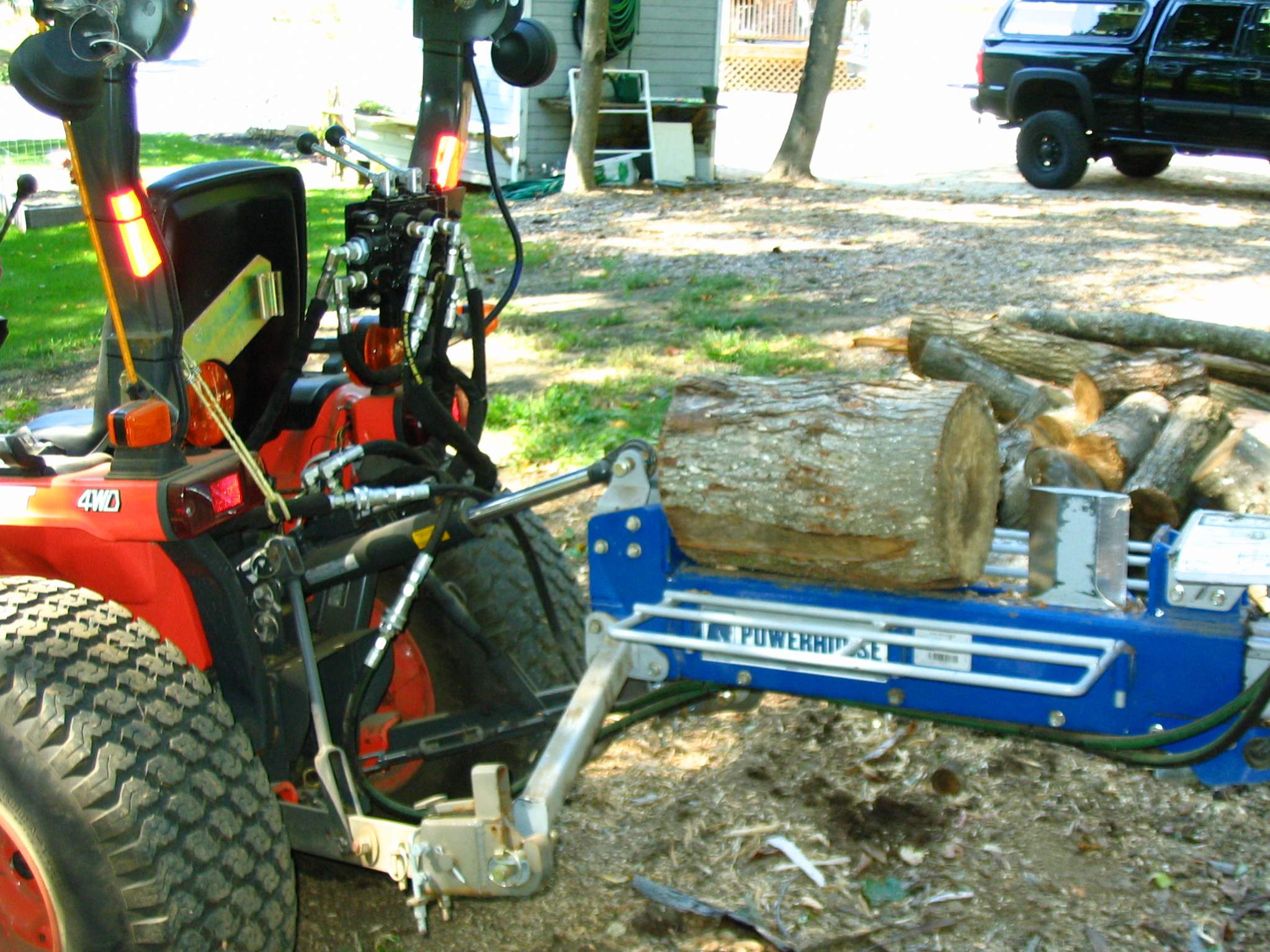

I have a northern tool 3 point 16T splitter and love it...It splits both direction to make up for the slower speed. Head to head w/ my buddys tow behind 20T honda splitter we stayed pretty close....

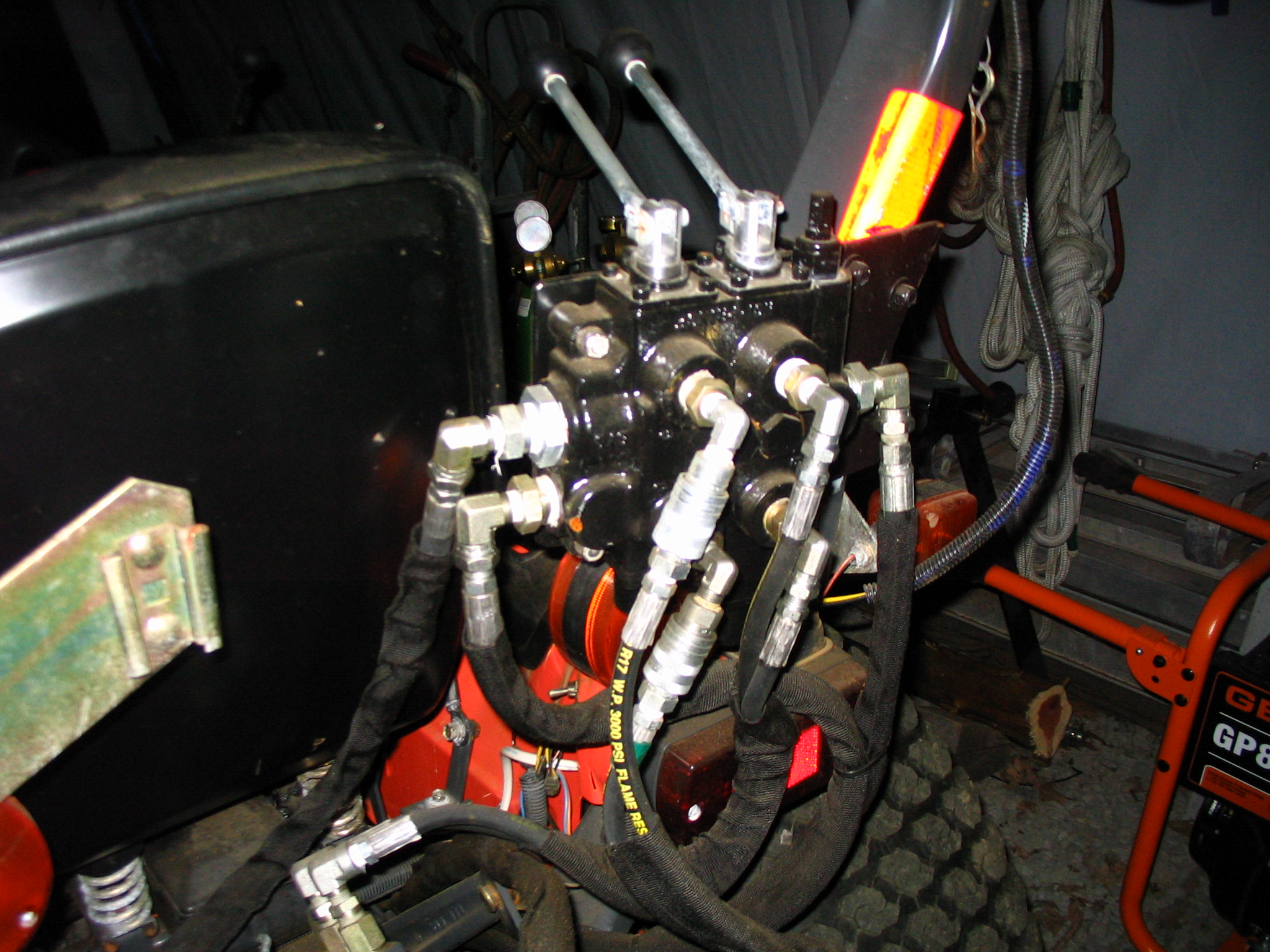

I installed rear remotes w/ power beyond loop that feed the splitter, and the 2 remote valves are for my hydraulic top link for easier 3 pt hitch hook ups and the other for my grapple (summer), snow plow (winter)
Well worth the investment. The 3 pt hitch splitter allows you to lower for large logs and raise to split at a comfortable height for normal size logs...:thumbsup:

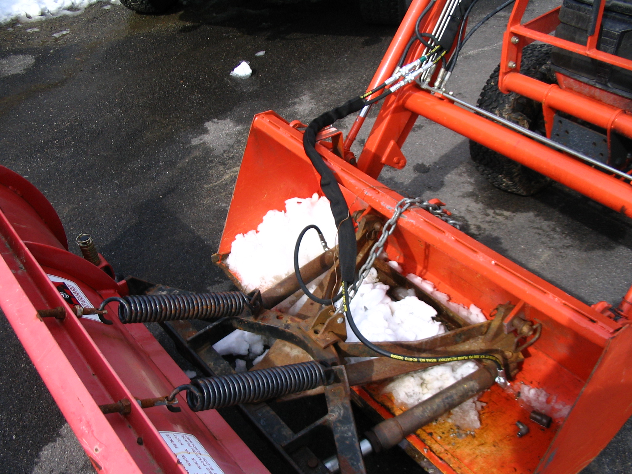

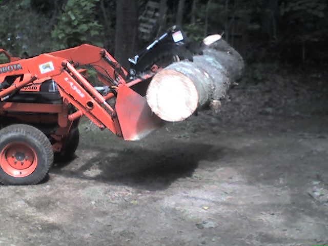

Just a few ideas for you:D
