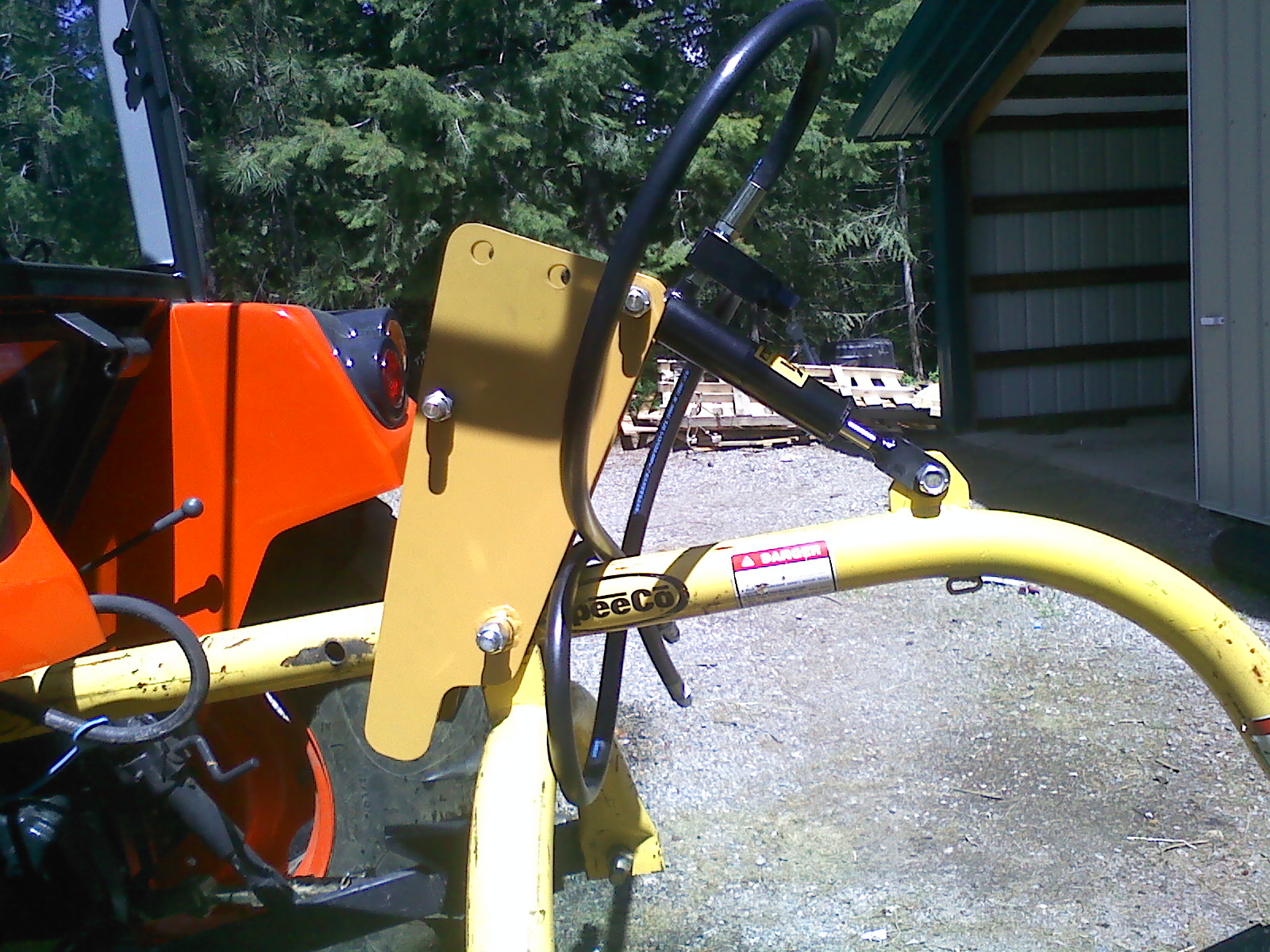

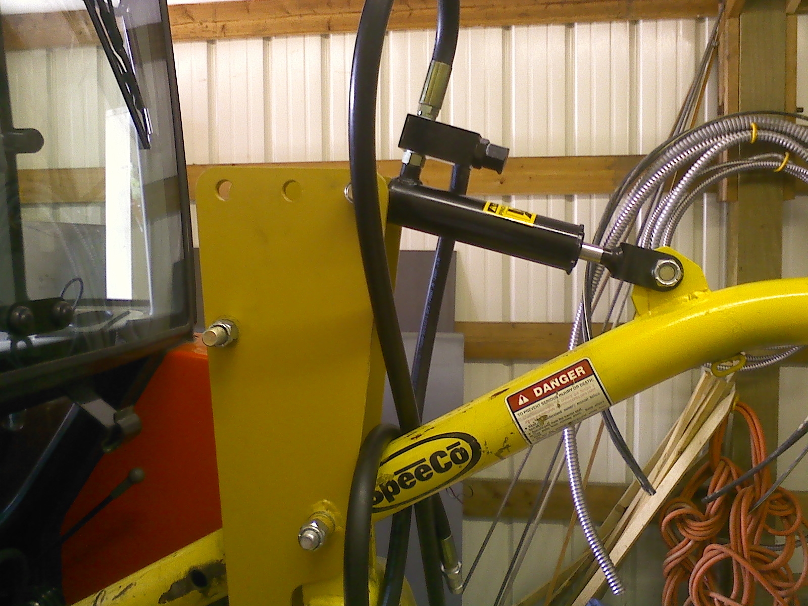

Well i have a single acting cylinder on my post hole hydraulic assist and it did not work on the rear hydraulics.
The fix was a simple part that screws into the rear HST filler spout, and the single acting cylinder line dump plugs into this.
Its the same part they use for backhoes.
Part was like $24.00 from my Kioti dealer PLUS the female hyd connector end that i already had. And took about 10 minutes to install.
My dealer told me this is necessary any time a single acting cylinder is used.

Well i dont know what to tell you all, but i tried plugging my hoses into every different rear port i had and i could not get the single acting cylinder to retract....especially when i lifted the 3 point.
With the return line that my dealer had me install, it work like it was designed to do.
JJ, the fitting and connector that the dealer had me add goes to one of the hoses on the post hole assist cylinder, and the other hose from the cylinder goes to the upper rear remote port from my NON-detente style rear remote controls. When i pull up on the lever, the single acting cylinder extends, and as i lift the 3 point, it collapses the cylinder. This way i dont have to control the rear remotes at all during lifting of the 3 point.

there is a block/manifold on the cylinder with 2 hoses.... see pic

I think I may have the answer, If that hyd block on the cyl has a shuttle valve/check valve, that closes off the hose going to the tractor 3pt, the cyl will raise. When the 3pt is used, the pressure is released from the shuttle valve and the fluid escapes to the reservoir. Plausible but not positive.
One valve raises the cyl and another valve lets it down with a load down force.

Sorry, long interrupted edit. [Iv repositioned the post] > ... I am confused about the 2 hoses on a single acting cylinder tho. I guess what youve done is put one of those hoses [the retract] venting to tank. I dont see how that alone would allow you the raise the 3ph w/o operating the remote simultaneously ... UNLESS its a relief valve Tee'd, instead, off the extend hose, then to the tank. Looking back at the last picture you posted that could be it.
