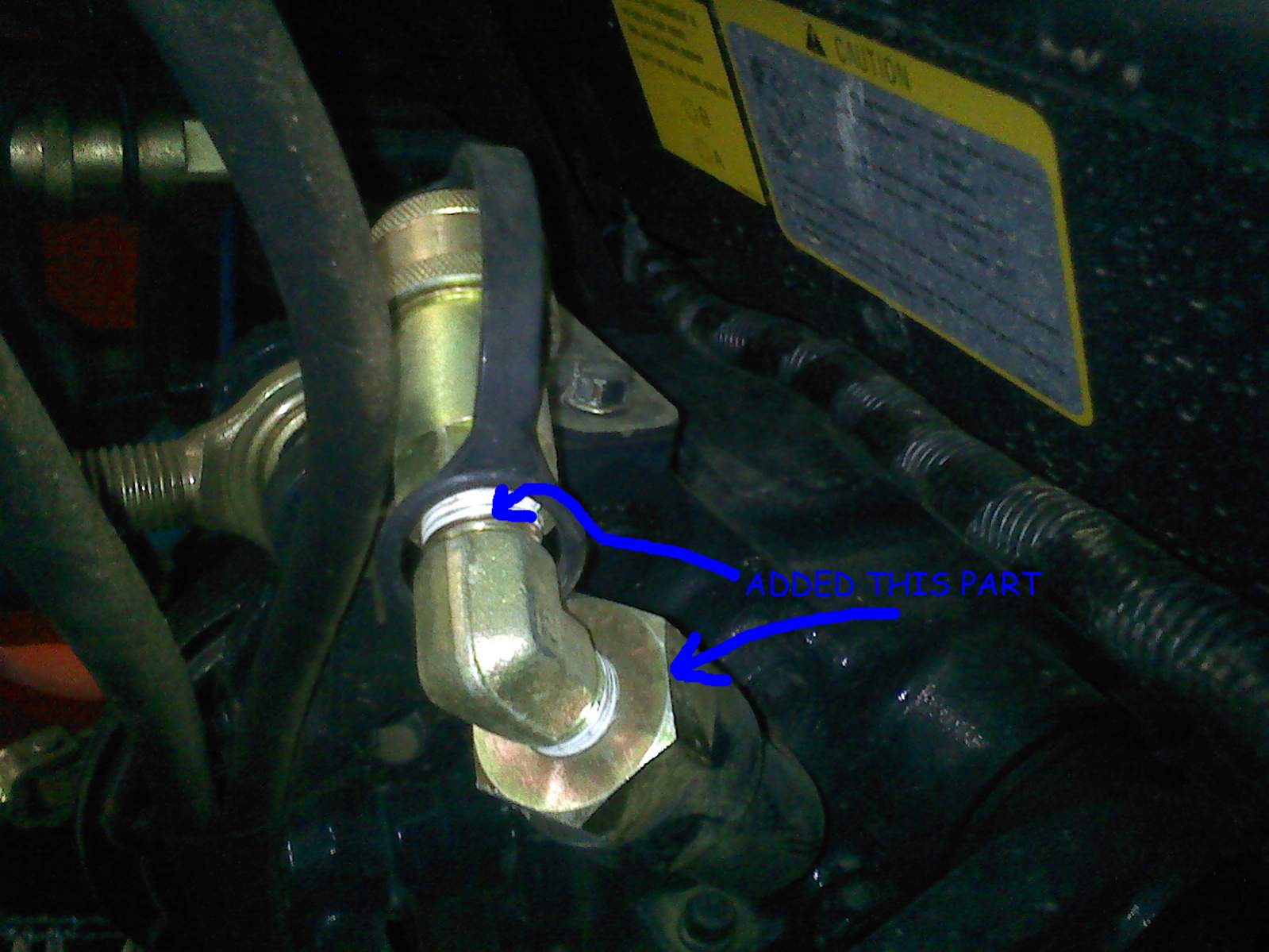

Well i have a single acting cylinder on my post hole hydraulic assist and it did not work on the rear hydraulics.
The fix was a simple part that screws into the rear HST filler spout, and the single acting cylinder line dump plugs into this.
Its the same part they use for backhoes.
Part was like $24.00 from my Kioti dealer PLUS the female hyd connector end that i already had. And took about 10 minutes to install.
My dealer told me this is necessary any time a single acting cylinder is used.

I am not sure the dealer told you the full story.
There is no reason that one can not use one of the work ports of a valve designed for DA cyl, to activate a single action cyl. You would use one of the work ports and plug the other work port. When you use the cyl, you are adding fluid to the base end. When you release the fluid from the base of the cyl, it flows out to the tank. The other work port goes into relief and screeches for a few seconds, because you are trying to add fluid to a plugged port.
If I am wrong, someone will surely correct me.

JJ yo know more about Hydraulics than i ever will, but all i know is i tried plugging in my post hole assist to the rear ports and it did not work. I actually posted a link here while i was making this device to find out why.
Someone else told me i neded to dump the cyllinder into the tank. Now this might be because as i raise the PHD the cyllinder HAS to retract, and this might be different that what the poster is asking.
That i dont know. All i do know is my PHD works great now
Greg

The hose in your picture, is it connected to one of the work ports on the valve and going to the tank?

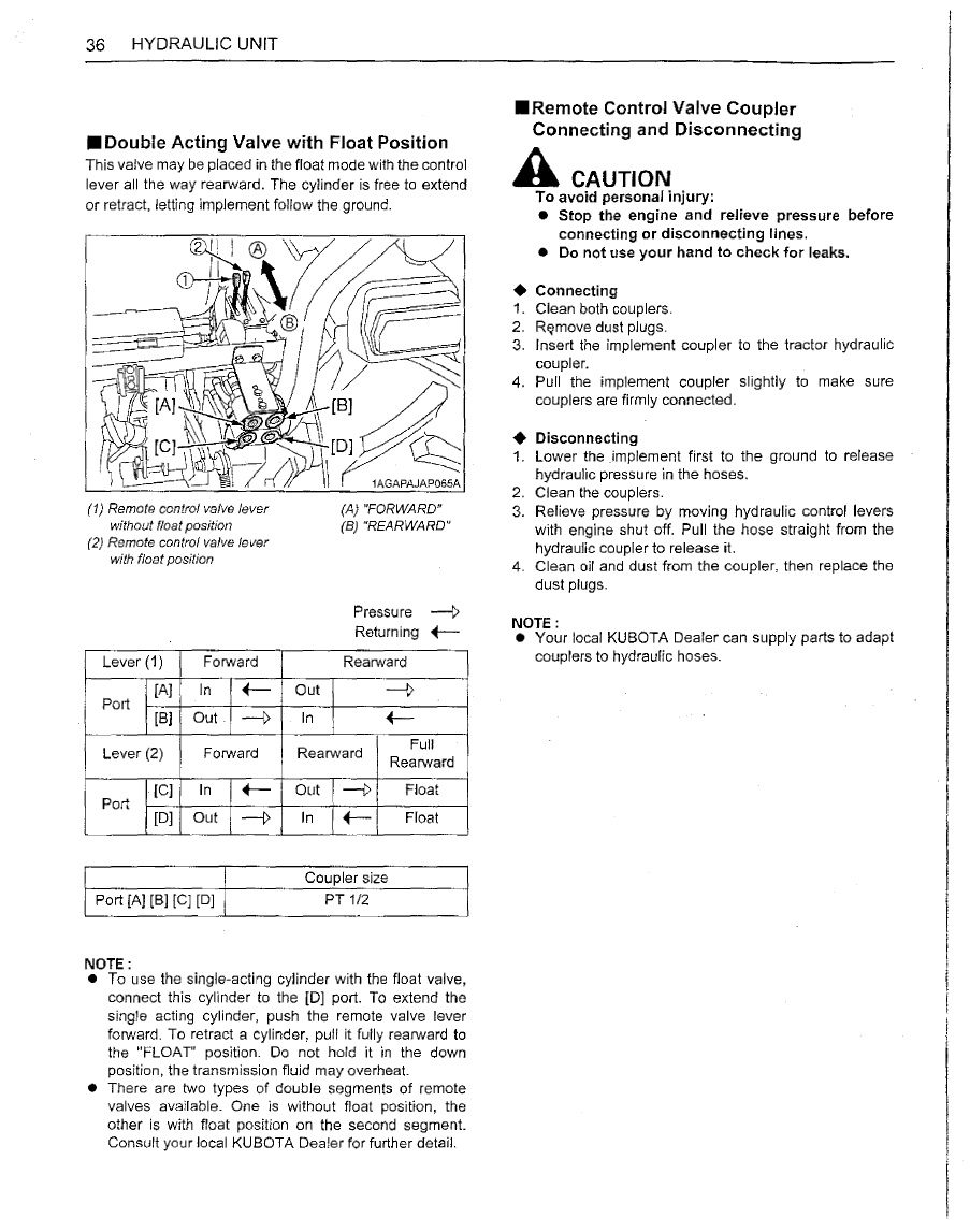

Could one not connect the hose from the single cyl to the float port on a valve.
If you were to push the lever to the down position, the relief will activate, but if you go into the detent float mode, the cyl should move with the ground level with no adverse action.
