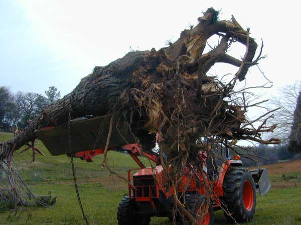

Loader bucket hook(s): of course, you will use them sometime for something. Typical use is picking up things or strapping an item to large to fit in the bucket. (see photo)

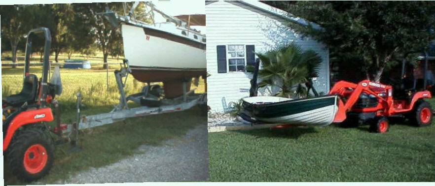

On your boat quuestion, I use my BX2200 to move anything I can hook up to.
I move my 3000 lb sailboat boat with a ball hitch on a cross drawbar and sometimes use the FEL for smaller boats.
See photos
