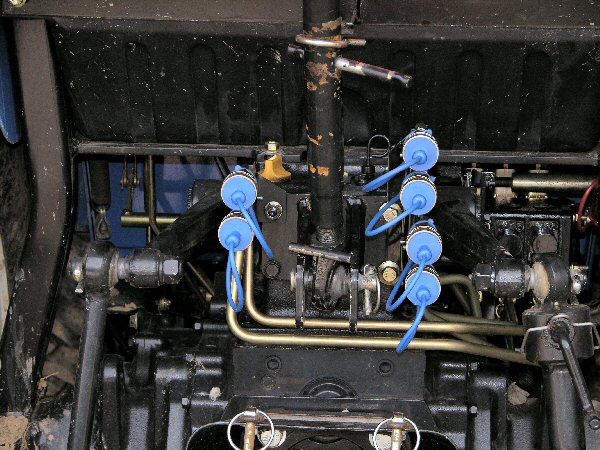

/ Rear Remote #5
here is a pic of 3 rear remotes on a New Holland TN70A ag utility tractor.
One of the three sets is being used.
/ Rear Remote #6
Here's what 3 rear remotes look like on the back of my TC-40D SS. One set operates the hydraulic top link, one set operates the hydraulic side link, and the 3rd set remains open for other needs.

/ Rear Remote #7
You sure about that ? ..... looks to me like two are in use and one set is open ...... :D
Yes, I was in a hurry and did not pay attention. Oops!
