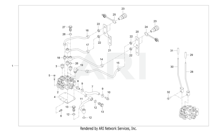

I have a CK3520SE Cab. One of the rear remote levers is *very* hard to get out of its neutral position, resulting in abrupt hydraulic function operation when it is finally forced to move.
Does anyone know if there is an adjustment for the stiffness?

Brand new tractor, so unlikely to be corrosion.
I'll take a look at the linkage (no cables, I believe, but I could be wrong -- I'll know tomorrow).

/ Rear remote operating lever stiffness - adjustable? #5
I'm not too sure on that tractor that they even have cables. According to parts diagram I looked at the levers are connected directly to the valves.
Original poster look at the valve body itself in the rear and see how they are connected. No adjustment that I could think of. If working it back and forth (tractor off just move the lever) doesn't seem to loosen it up I'd let the dealer handle it since its new.
