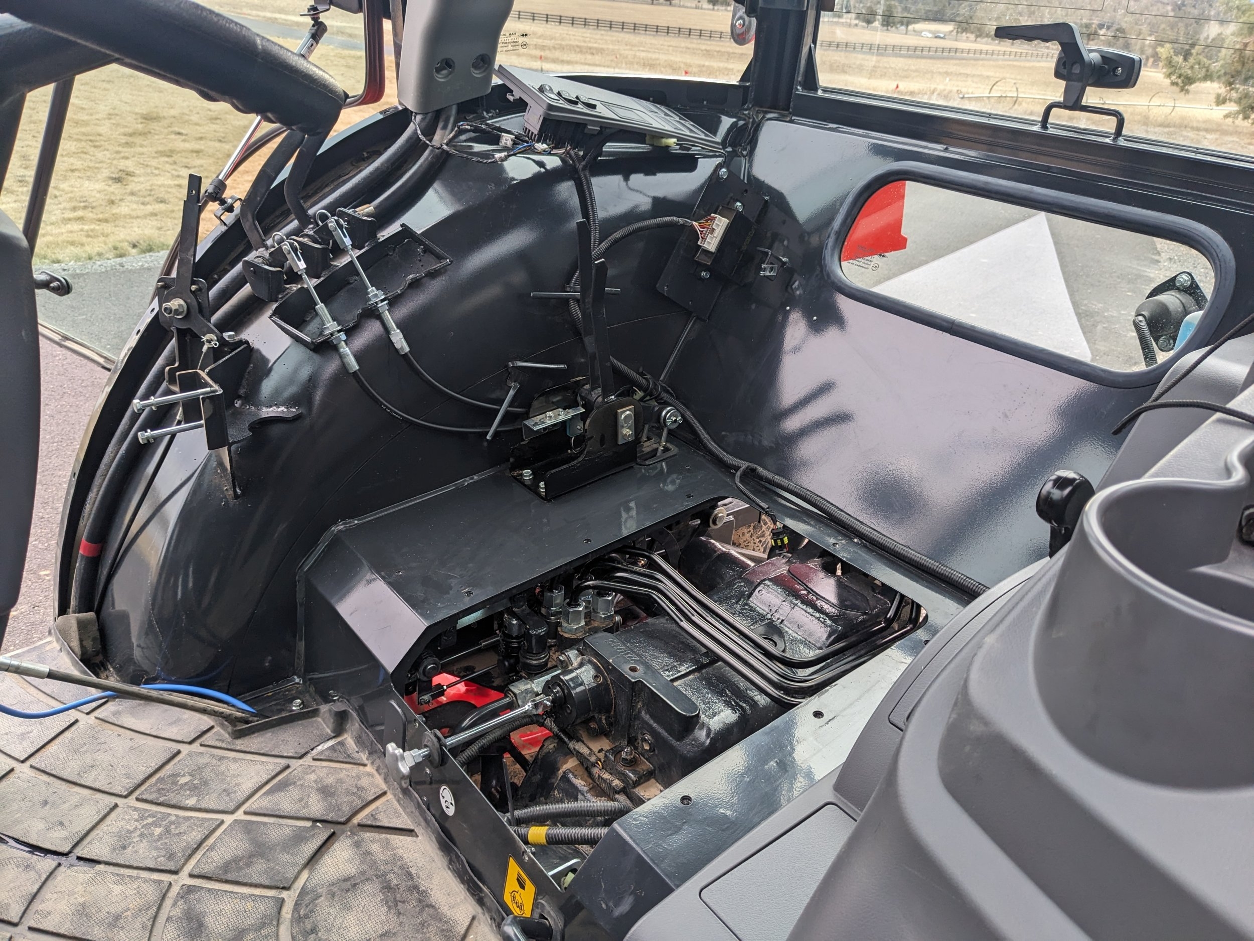

Just received my kit from the dealer. Instructions call for removing the rear wheel, which will be problematic since I already filled the tire with RimGuard.
My tractor is an NS 6010 with cab. I kind of eye balled the situation and it looks borderline feasible. Fortunately I am skinny and have adequate experience working on Porsche 911s, which are a nightmare to work on in the engine bay.
Anybody any experience installing the rear remote w/o removing the rear wheel ? if so, any pointers ?

I recently added a remote to my 53hp machine and it would have been near impossible to do without removing the wheel.
Is the issue you're concerned about the weight of the wheel/tire/rimguard?
A strap and cherry picker may be in order

Exactly. Not fancying bringing my tractor to the dealership.
May have a go at it next week. Will report back.

Study how your seat is attached to the fender pan. On my DK5310SE you might have some awkward wrench angles but it might be possible by just removing the seat and exposing the top of the axle case.
Search the channel "J Hilti" on YouTube. If I recall I think he replaced some part at the top of the case on an NX and was able to do so removing the seat.

Happy to report that I installed it yesterday and was able to perform it without removing the rear wheel.
Big thank you to Eric for throwing me a bone. The trick is to remove the plate inside the cabin upon which the seat rests. This will give you access to the area just above the transmission and all the other hydraulic lines. Not optimal, but not that bad either. I would say that if you can both remove the rear wheel, AND remove the seat inside the cabin, you'd be golden.
In total I spent about 5 hours on this. Most time was lost stripping the interior panels (and trying to not to scratch or damage anything).
Attached a couple of pics.
