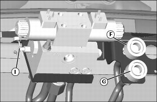

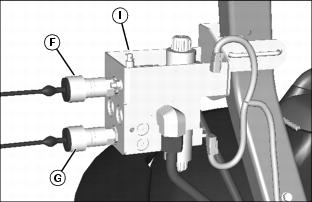

There is a T-handle on the valve that is there to relieve pressure on both outlets. Once picture is for a cab unit the other is for an open station.

Yes that was what I thought the dealer told me back when I bought the tractor. Tried to turn this using the T handles but wouldnt budge and I actually broke the T's off. Any suggestions?

View attachment 290140View attachment 290141
I got the little plug free that had the T handles. Do I remove it completely with the tractor shutdown to install the two hoses or shouldnt I need to completely remove it
   / Rear Remote Hydraulic Pressure #8
I just went out and tried it on my 3720. One full turn relieves the pressure for me. I would not take it completely out unless you are repairing the T-handle.

Got it!!! Worked great. Thanks for the help. We are going to tap out where the T handle was and try to install a new T handle. It seems that this is just a threaded plug with the T handle. Would you know if this is correct? Thanks again for the help.
