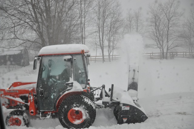

I have a Quick Attach 601RP which I use with a B3030 and it's been great which is a good thing since I'm located in the SE part of NH and we've been getting plenty of snow this year. The only issue I've had is trying to throw slush which clogged up the unit (really irritating). Aside from that, I can easily go through a foot + of snow with the full width of the unit. I will have to go to low range on the tranny but it just eats the snow up. The unit weighs 800+ pounds so it easily goes down to whatever the skids are set at. If more traction is required I lift the unit up slightly which puts all that weight on the rear wheels. I have yet to get stuck. Lastly, since I still have the bucket on the front I can back drag or clear areas as needed. I put the snow I've dug out in a line and then drive over it with the blower which tosses it out of the way.
