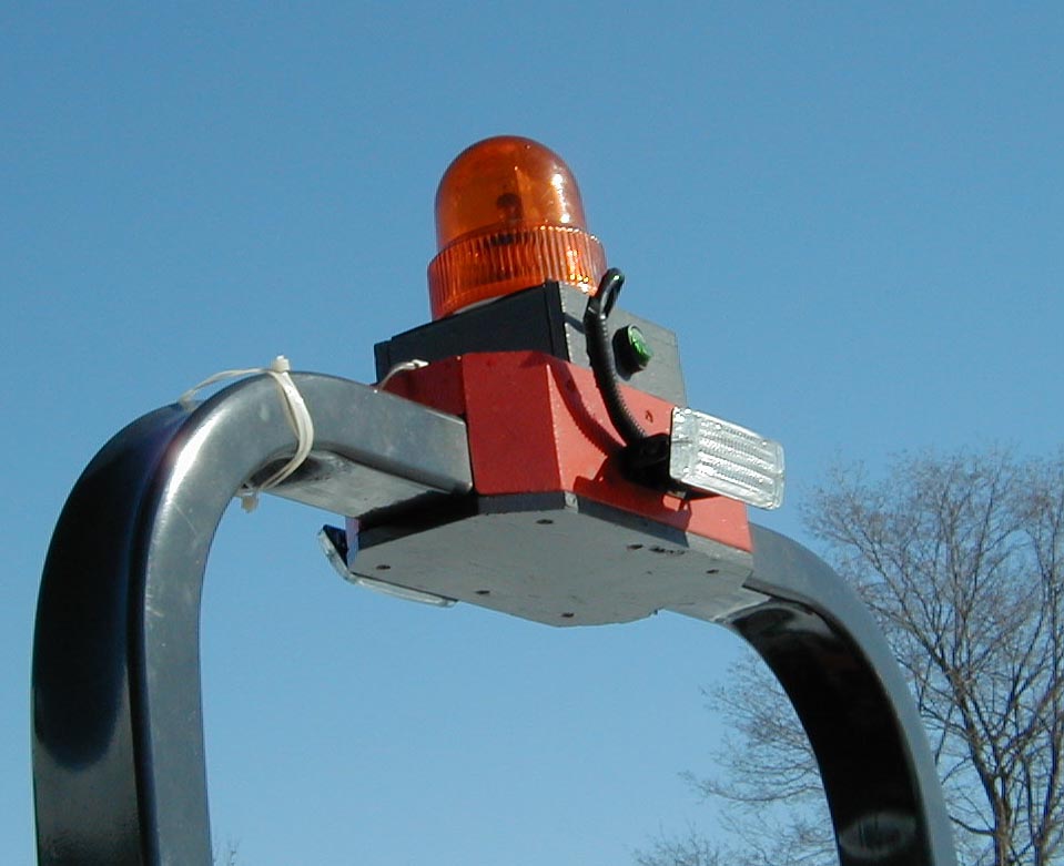

This is what I put on my Kubota B2910. I do better with wood than metal. The dimensions of the ROPS are such that 2"x4" 's just enclosed the ROPS. I then used a "plate" of 1/2" plywood on the bottom screwed to the 2"x4" 's that are on the side with deck screws. Added some Kubota orange and grey paint, and there it is.
The lights are 55W "back-up" lights that I got from a local auto supply store. They have a fairly wide dispersion angle, which is what I wanted. The revolving beacon is an "el cheapo" unit. I may replace that with a xenon strobe for better visibility. The whole works plug into a cigarette lighter receptacle I installed at the power tap behind the seat. There is a separate switch on the front of the light unit that turns the halogen lights on/off. The beacon flashes whenever the cigarette light plug is connected.
This system didn't require any drilling to the ROPS at all.
At night, you really need at least one light forward (the loader blocks most of the light from the headlights) and one rearward. So far, this seems to work well for me.
