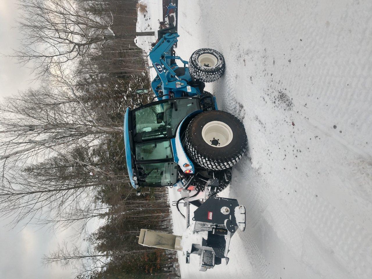

Hilbilly,
I only have a 40 HP tractor with 32 PTO HP. I got a 74" FarmKing pull blower ($4000 on sale during the summer) but have only had to use it three times so far. Deepest snow being 6" and it works well.
Had about 4" to take off yesterday. To check how it handles more snow, I used my front mounted back blade to windrow the snow into the center of the drive from both directions and then ran over the windrow with the blower. It ate it up no problem It sure is nice driving forward.
BTW, build quality seems good. I like that the shear pins are common grade 5 bolts attached with nyloks. I sheared one on the first use as I have a gravel drive and tired going too fast...that gave me a build up of gravel that stalled it out. I adjusted the top link and so far no other issues. Shear pin is easy to get to and change.
Not sure how the FarmKing stacks up against the "better" blowers. I get 120-150" of snow a year and only do my property. I am satisfied but maybe I do not know what I am missing with the more expensive units. It moves snow efficiently and I have no more mounds of snow from plowing. Seems all I need.
The SSQA plate on the front lets me mount my 3ph attachments so I use both my back blade and rake. Good enough for light work and it is nice being able to use the blade for back blading snow. If I need the bucket or forks it is easy to change over. For just over $200 delivered it is not expensive for the flexibility it affords.

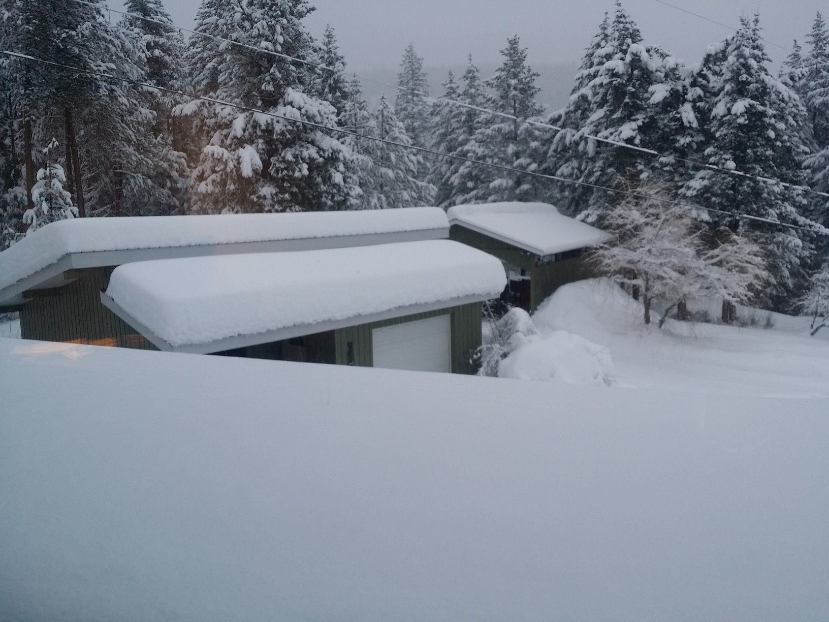

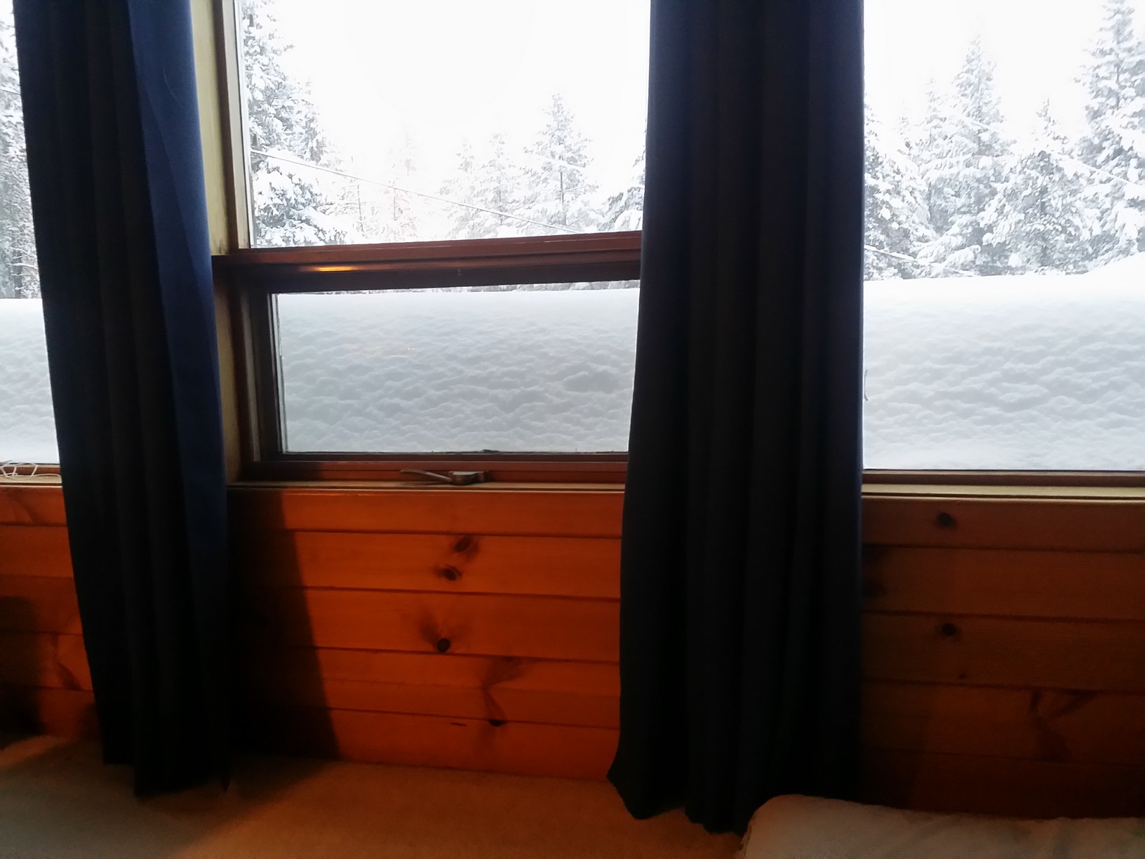

As stated before, for most snows of around 8" the speed with my 28 PTO hp tractor is a very fast walking pace or more. I really don't want to go quicker than that, even if I can. What slows me down are uphill sections. I think that is due to the HST requiring more of the power. But going downhill I can motor right along. The odd times(like lately) when blowing 12" of cement I do have to use low range and still manage a normal walking pace even uphill.
It snowed all night again and is forecast to snow all day. This evening it is to warm up and rain. So I guess the best plan is to head out after noon and get the snow out of the way. After the rain cooler weather and more snow is forecast so that will be fine. It is the wet snow that is not as much fun.
Here are a couple of photos of this morning from my upstairs window:
