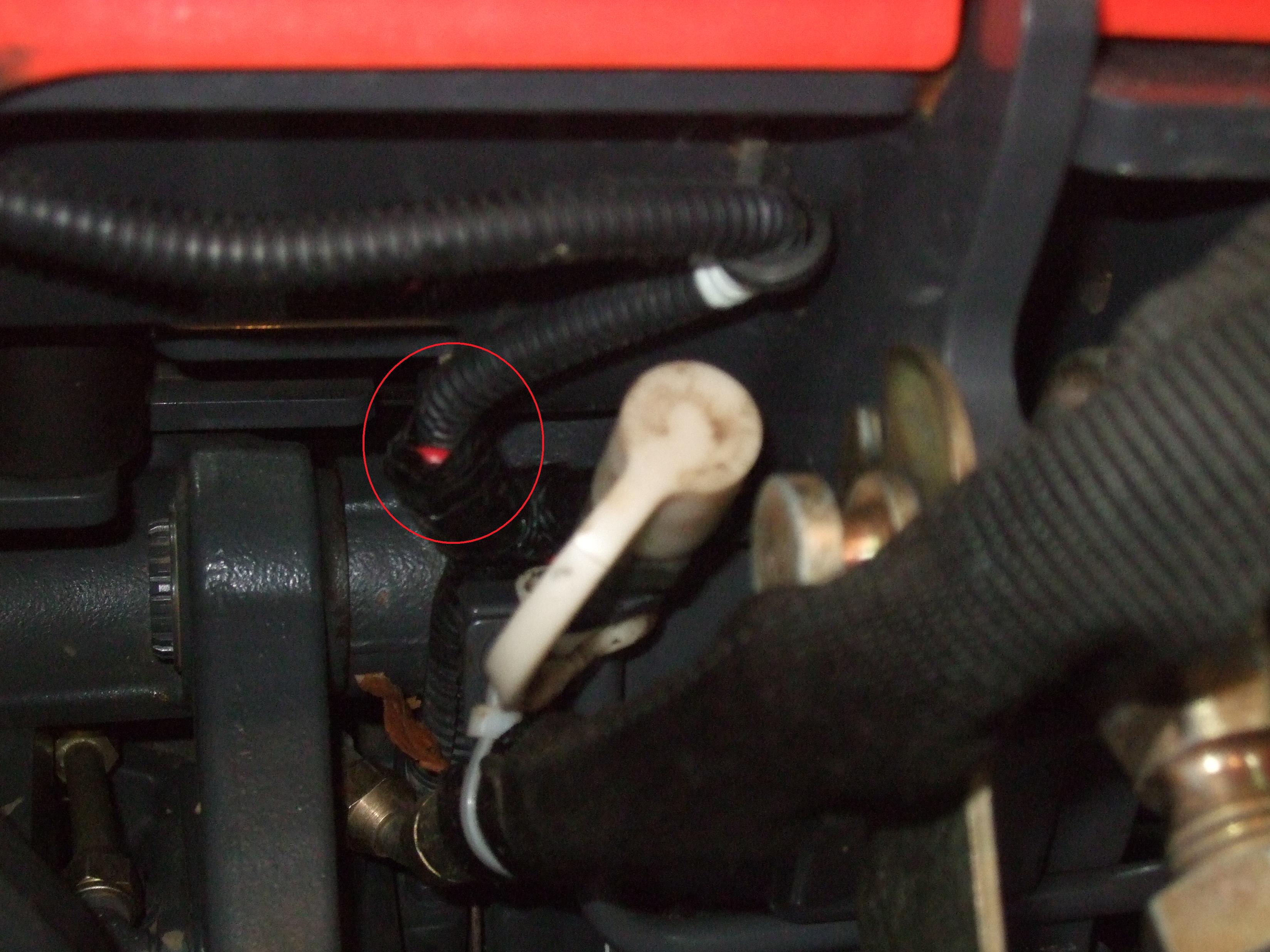

On a BX24 is there any wiring set up for a work or rear light ready to go from the factory? I can cut into wires and get one hooked up but was trying to make it easier...

Should be taped up right under or near the top link bracket. Look for a bulge of black elecrical tape.
/ Rear Install Work Light #5

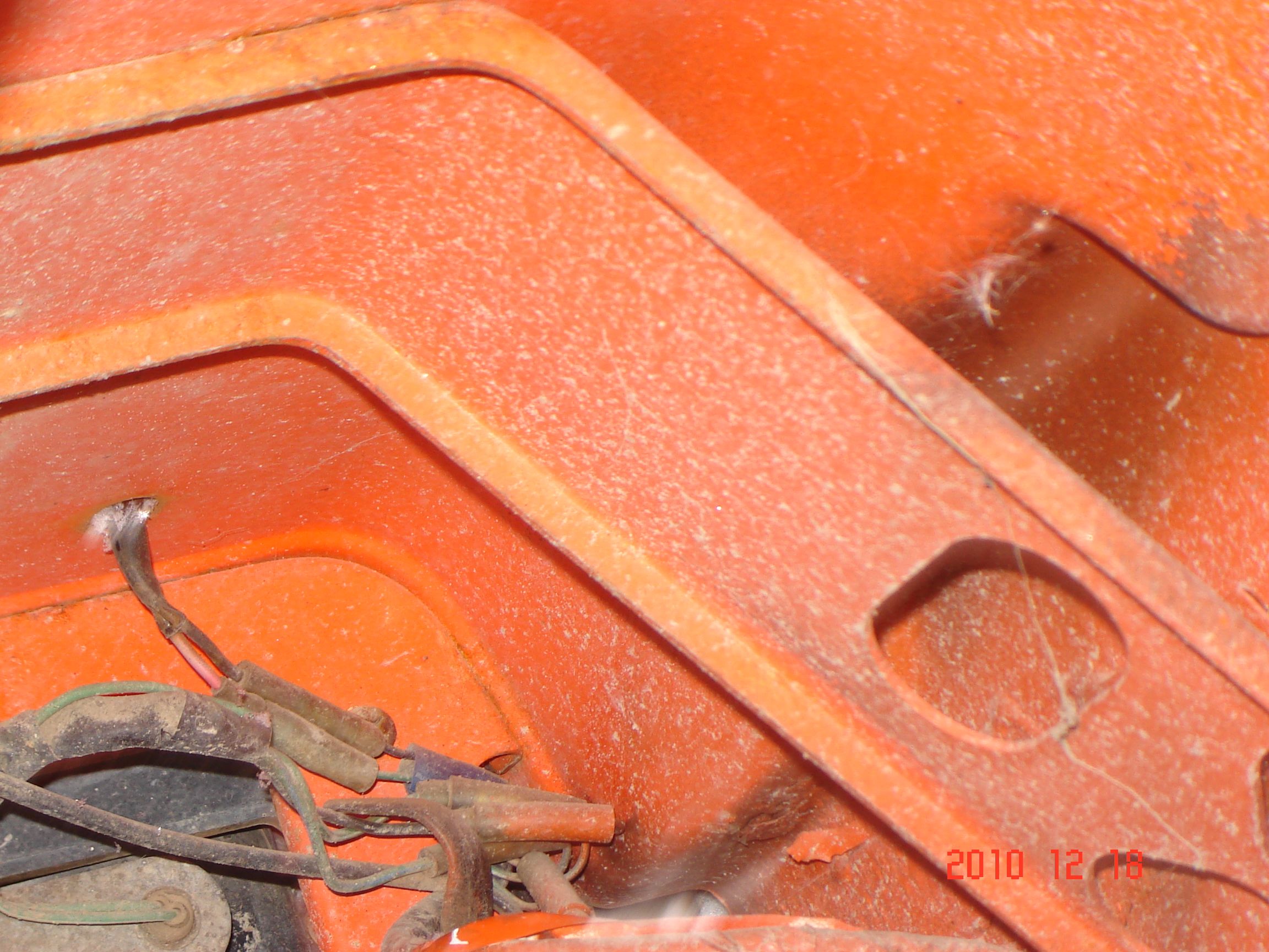

yeah-- your BX24 already has wires for light. I didnt use em since I needed more wattage. I used the wirs for the sprayer instead. The wires is taped up in back of BX hidden in wire loom.
I included the pics of wire location I posted many times....

Thanks for the help, the wires are there, will make a lot easier to hook up!

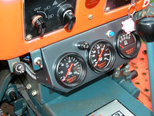

My B8200 had a pair of work lights installed by its first owner, on the fenders. Seem to work fine for winter snow blading, in reverse, but if they were higher, maybe they'd be better? I added the indicator light so I'd know they were on if it wasn't dark enough to tell otherwise- blue thing on the 3-gauge panel. The light switch is the toggle on the left of the gauges... (before anybody questions my vison, let me say I will turn the rear lights on to back into my dark barn at dusk, when I wouldn't otherwise be using them.
