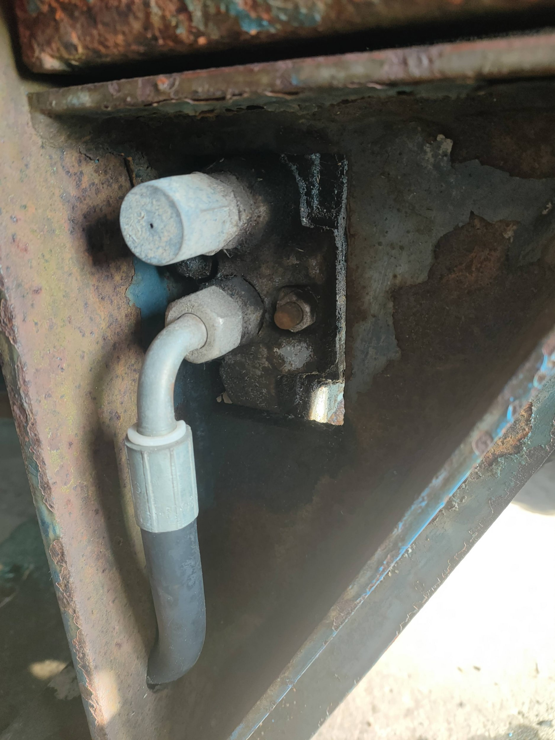

Hiya
I've recently purchased an old Iseki TX2160 and am slowly working through the obvious faults, servicing etc and trying to make sure it's working as it should be (as much as possible for this old machine!). The tractor has both a front loader (I believe it's one from a Kubota) and a backhoe (d200). I've removed the backhoe (which is PTO driven, has its own hydraulics) and am investigating the 3 point hitch. The previous owner had the arms but I believe the backhoe has been on for many years.
Anyway, the problem I'm getting is that the arms will go down, but there's barely any pressure to bring them back up again - UNLESS I raise the front loader first, then while lowering it I then also put the rear control lever into raise. Then it goes up fine, which to me makes me think all the hydraulic pressure is going through the FEL.
I'm fairly competent at DIY in general but hydraulics and tractors are new to me so please be nice :)
Anyone able to help with some things to try? Here's some photos of the different bits
Under the seat, this block has two pipes, one must be delivery and the other return which go to the FEL block:
Just below you can also see what I think is the high pressure line coming from the hydraulic pump at the front of the tractor

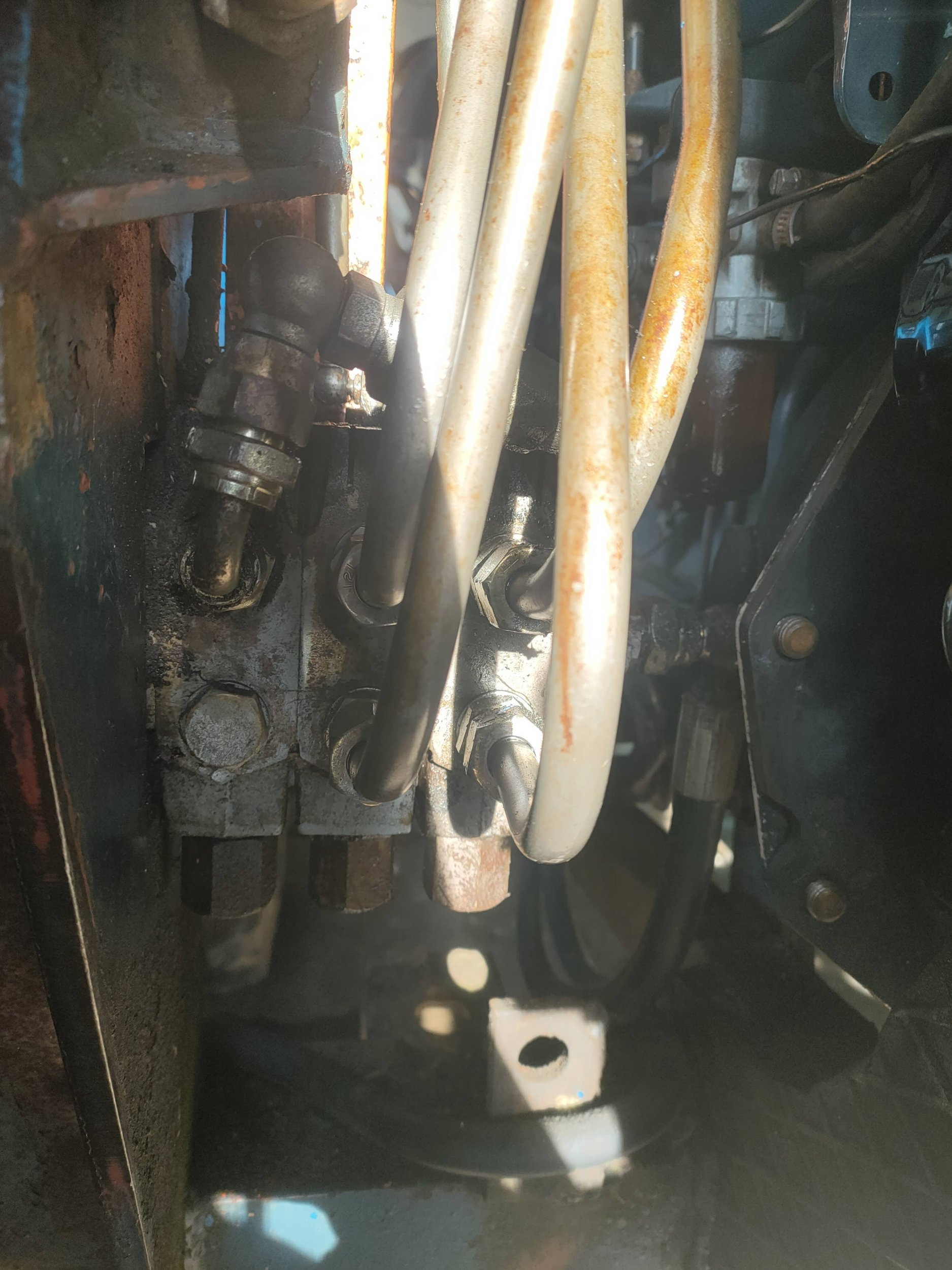

And then at the side of the loader, here's a few shots of the control block. The two pipes from that block above come in and go out either side, and then there's two control outlets for the loader lift/drop and bucket curl/uncurl, and there's a 5th one that goes off to a spool valve? at the back of the tractor for an implement at the back
Any help would be greatly appreciated - I've read about pressure relief valves etc but I'm coming up short understanding exactly what's going on here on my tractor, as there's no diagrams I can find that match my setup
Cheers
Martin

Pressure relief is likely fine if the loader raises and lowers.
So aside from the obvious 4 hoses that go to raise/lower and dump/curl you are saying you have THREE other hoses on your loader valve?
Those are likely supply/pressure (P), Power beyond (PB) and return/tank(T)
Look and see if anything is labeled and where exactly each hose is going.
The PB hose should go on to feed the 3PH. IF there is a remote valve at the back of the tractor, the PB may feed it then come out of it to feed the 3PH.
The P hose should supply pressure to the loader valve pretty much direct from the pump....but it may go through a manifold block first.
The T hose should go straight to the tank.
With PB on the loader....the ONLY time the tank hose gets flow/pressure is when the loader is being moved. Otherwise the fluid ONLY comes out the PB.
So its possible they hooked the T line to feed the 3PH instead if the PB. Which would explain why the 3PH only moves when you move the loader.

Back to that triangular block under the seat - the original part there only has two ports out and back into the tractor
Part numbered 17 there.
That part is different on mine, which must have been changed many years ago to support having the loader on. There is a plugged third port on it too I think, so I'm going to pop it off and have a look at it. Part 10 in the diagram is listed in the parts book as a 'cap, blank' so I'm wondering if that is a return to tank port. I don't see that on mine but it may be where this third plugged port on mine goes to.

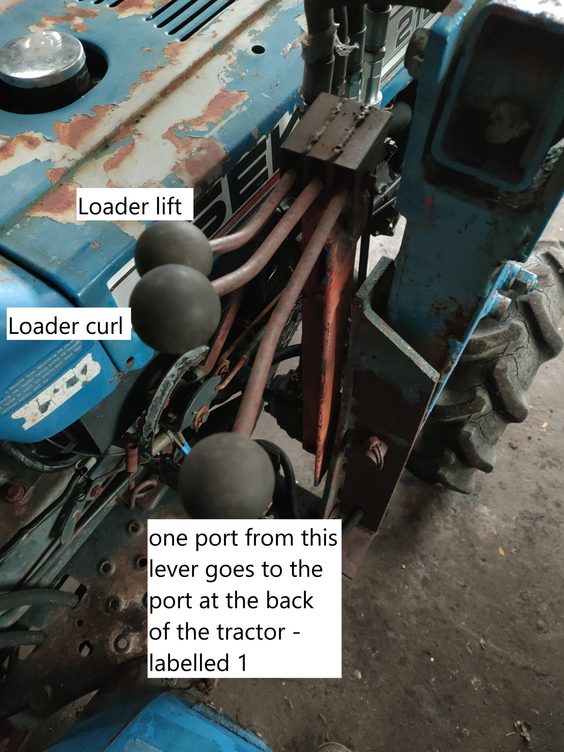

You keep saying your loader valve dont have power beyond but you have 3 hoses going to your loader valve stack not counting the 4 function hoses.
its confusing because looking at your pictures we cannot see where both ends of a single hose goes and you havent labeled anything.
Take your pictures that you have....and label things and maybe we can help better.
Show the valve and label hoses like 1, 2, 3, etc. Then show the pic of the triangle and under the seat and label then as well so we know for sure what hoses are going where

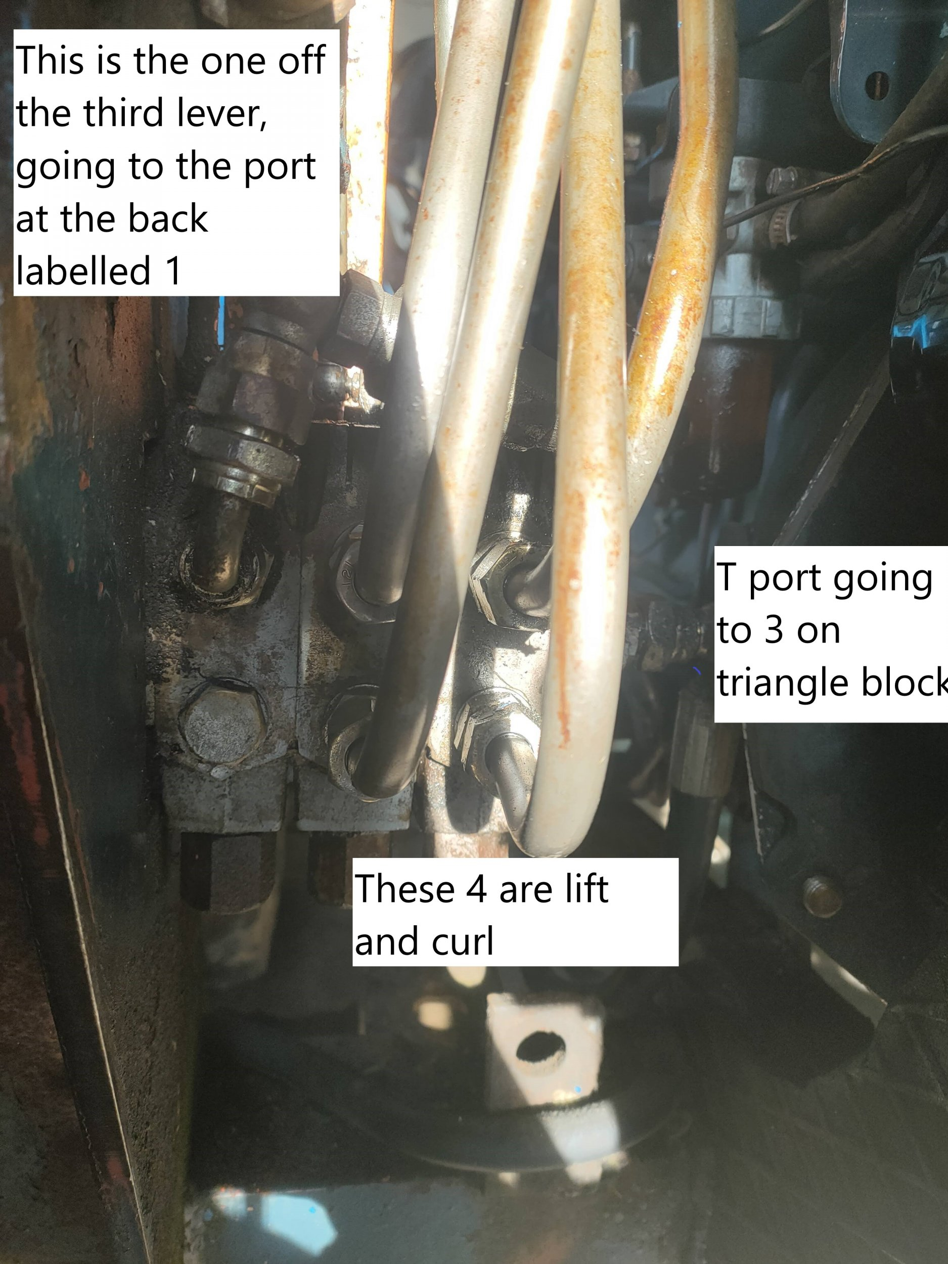

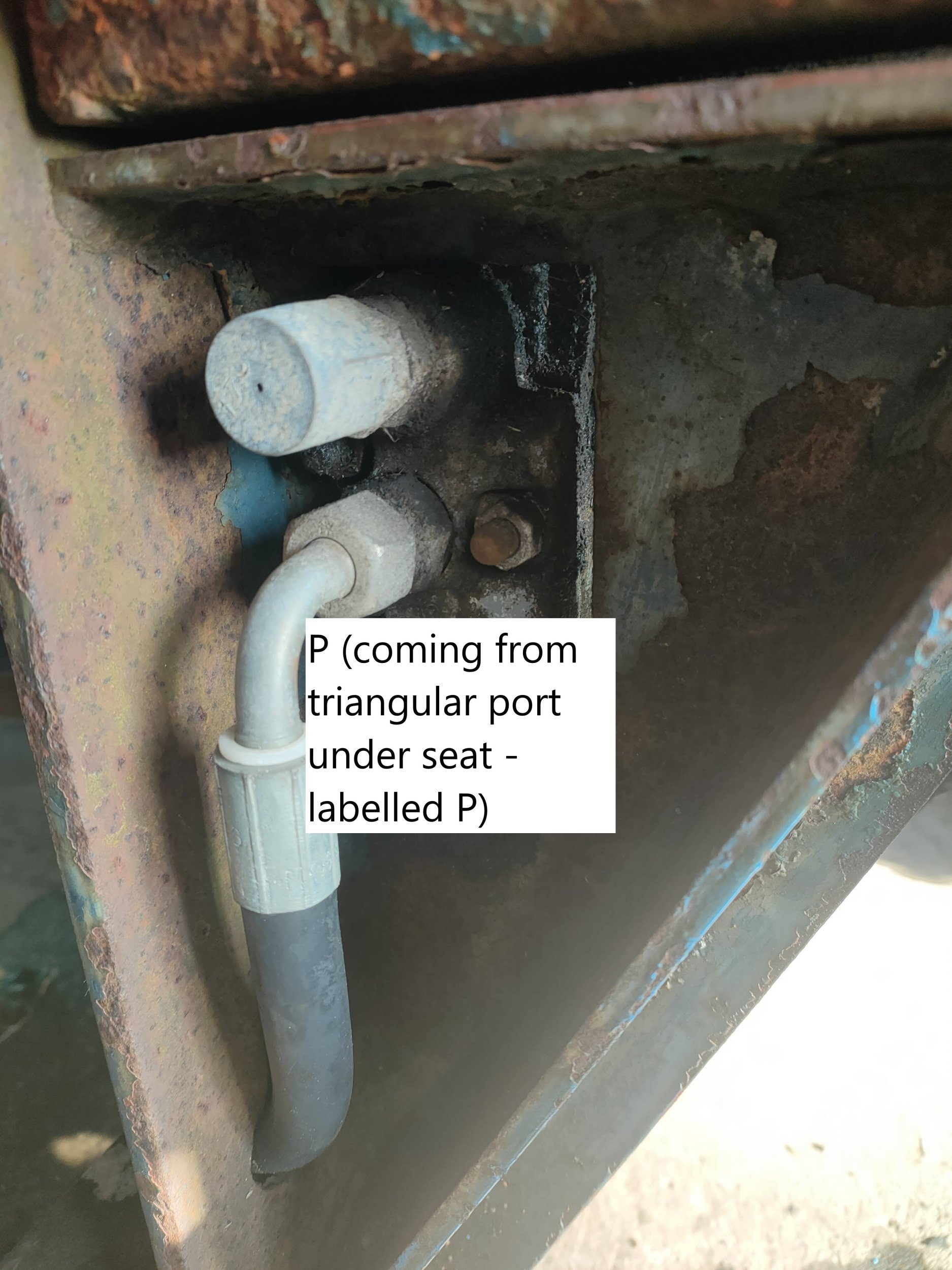

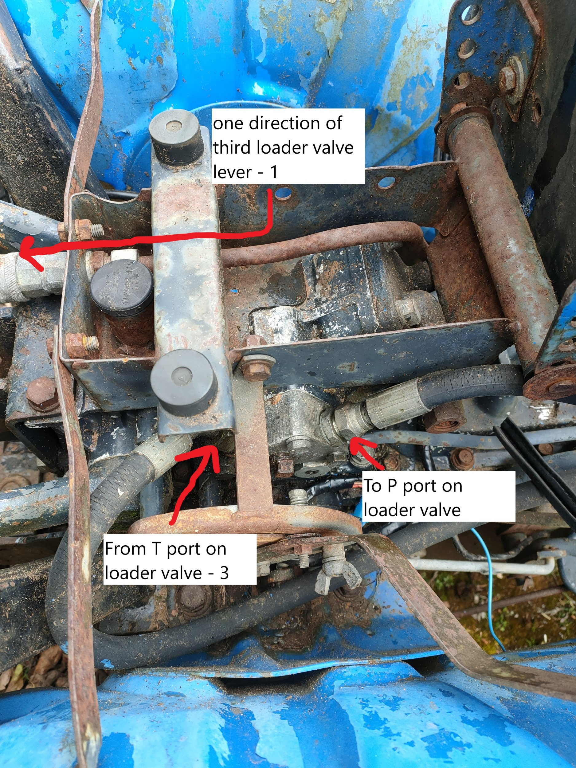

Hey all - thanks so much for all the help you've all been providing so far, and sorry if my explanations haven't been clear enough. I think @chrismac that's what I need to do. I'm guessing the pump or somewhere in that unit under the seat there must be a relief valve - but you're right in your analysis that the pump is currently dead headed, which I've come to realise with this thread and the investigations :)
@LD1 I've done some annotations, hopefully this helps clear up the 7th pipe from the loader valve, but let me try to explain alongside:
Under seat - with annotations - that one labelled 1 is fed by that 7th pipe from the loader valve, which is only actuated when the third lever is raised
Then the loader valve - just showing the P port on the outside. There's no markings on the case by that port above, I'm assuming this is a relief valve? It has 1700 marked on it:
And the three levers:
And finally the rear of the FEL valve:
And yes, when numbering things I didn't put a number 2 in there by accident!
Cheers
Martin
/ Rear hitch hydraulics with front loader help #19
Well done you have sussed it, I had a guess that would be the way is was piped in, T returning back to the rear of the triangular block, all you need to do now is have a think about your next step, whats the fittings underneath the spool valve for? the ones you can see in the last photo.
Chris
