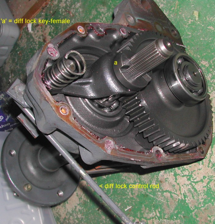

Df has the 8 pin correct.
What he is showing in the pic is typical of most compact tractors.
some has 4 instead of 2 notches.
BTI
/ Rear Differential lock #22
SPYDERLK said:
Do you know this for sure? 180 is a lot of rotation. Seems the female could have a double set of key recesses for the males, giving 90 degree engagement points.
larry
Yeah, it is hard to explain, but easy to see if you are looking at the
two parts that mesh together. Each side has 2 pie-shaped keys,
180 degrees apart. The female side of each part is larger than the
male part of its mate, allowing for the two to lock together without
being perfectly aligned. What this means is that there is a continuous
range of rotational positions where the two parts will fit together, and
a similar range of positions where they will not. I estimate
that if you start where the male parts are perfectly aligned, then
you will not be able to engage from 0-45 deg of rotation, you can from
45-135, you can't from 135-225 deg, can from 225-315, and not from
315-360.
This kind of diff lock is easier to engage than my Kioti's and (as BTI
states) seems to be more common. The key difference is that
perfect or near-perfect alignment is not necessary.
