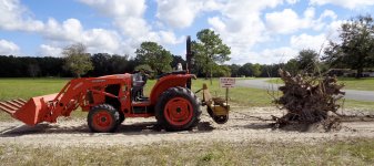

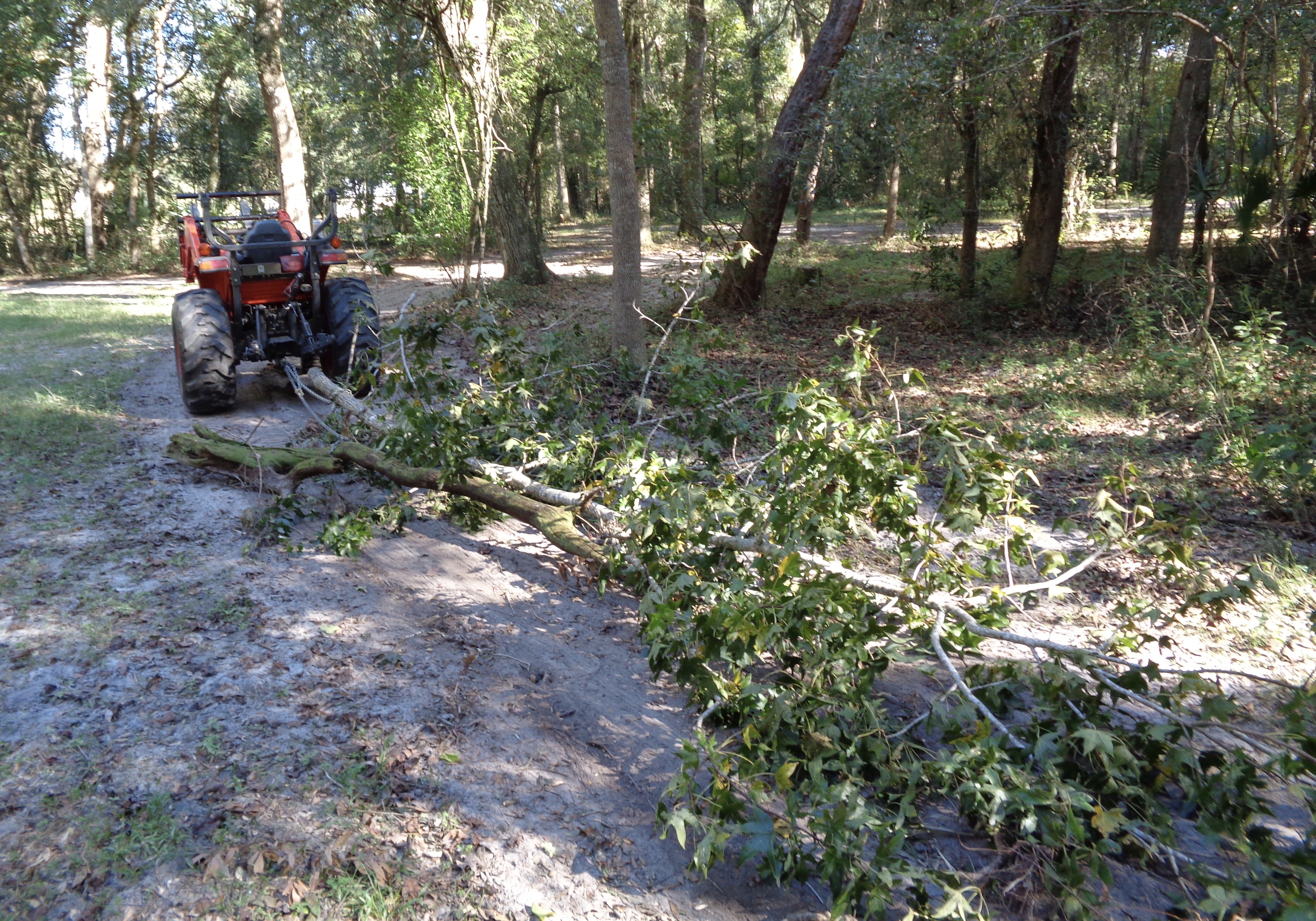

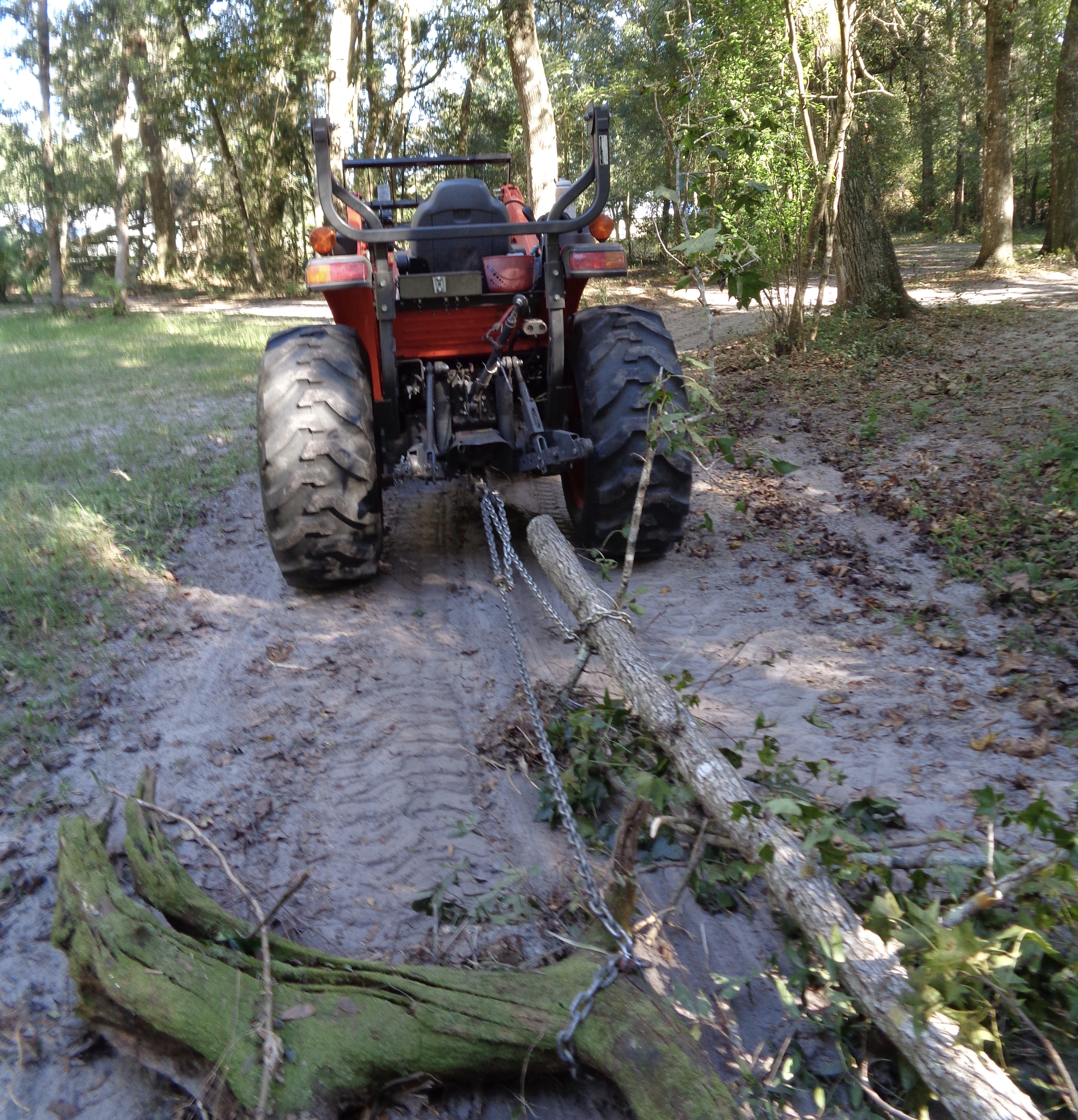

For brute pulling tasks I use the rear/center tractor drawbar as my preferred attachment point. Photo #1 + #2
I never remove the 3/8" clevis-mount Chain Grab Hook from the rear/center drawbar. I usually pull heavy loads with 5/16" Grade 70 chain, which is a secure fit in the 3/8" Chain Grab Hook. 3/8" chain Grab Hook was purchased at Tractor Supply Company.

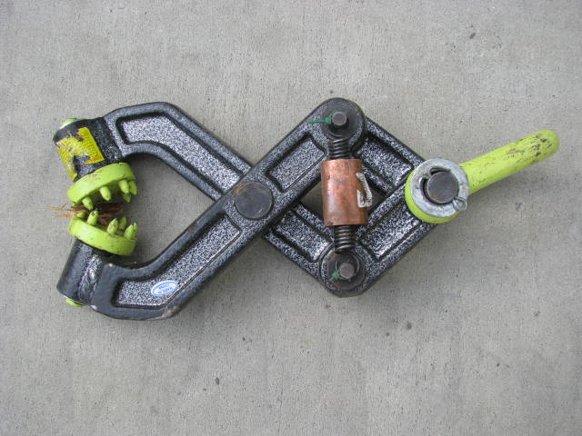

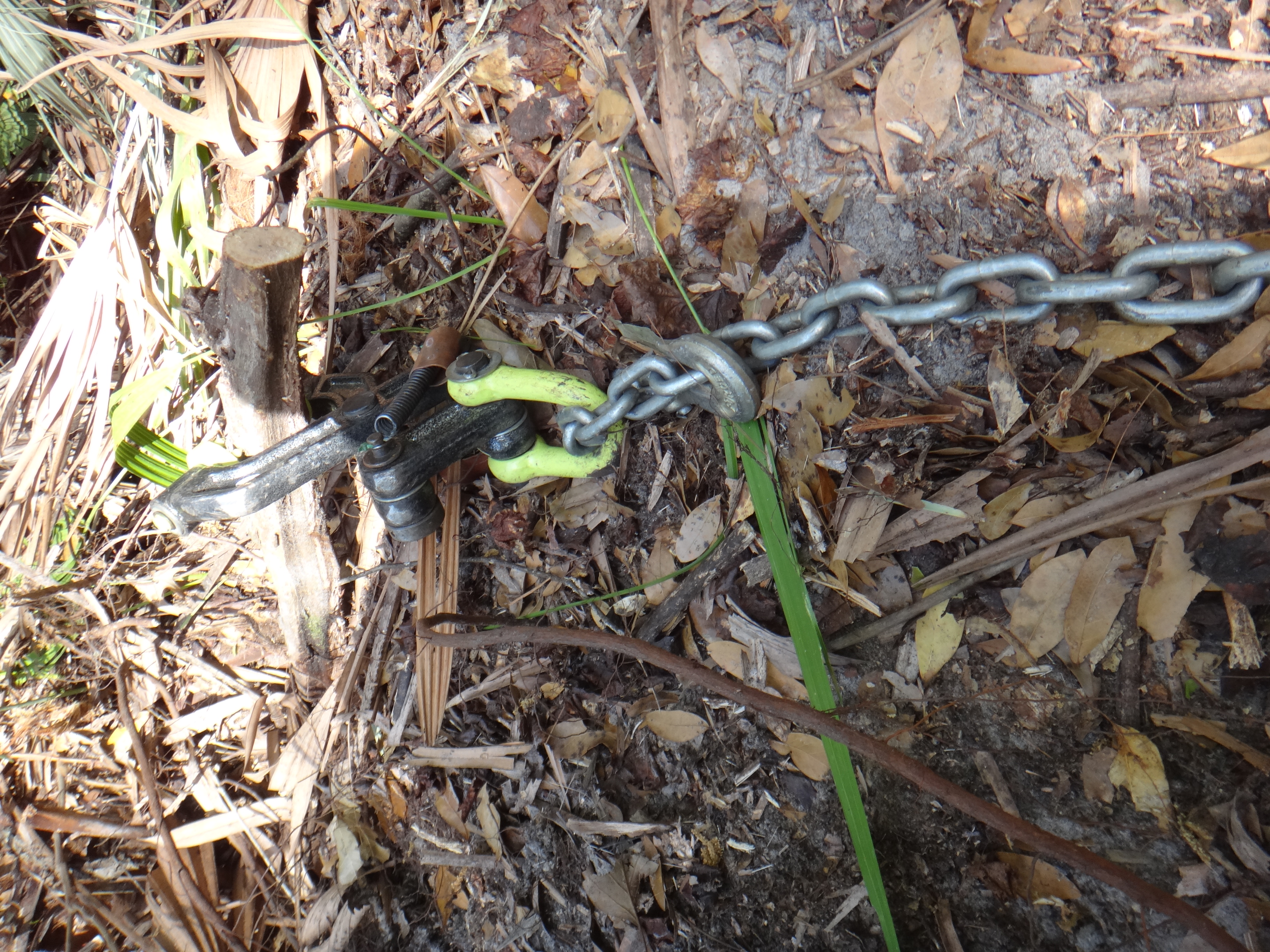

However for pulling vines a 'Brush Grubber' better grips vines than chain noosed to the vine with a chain slip hook. (A Brush Grubber is a near relative of a Pallet Puller. ) Photo #3

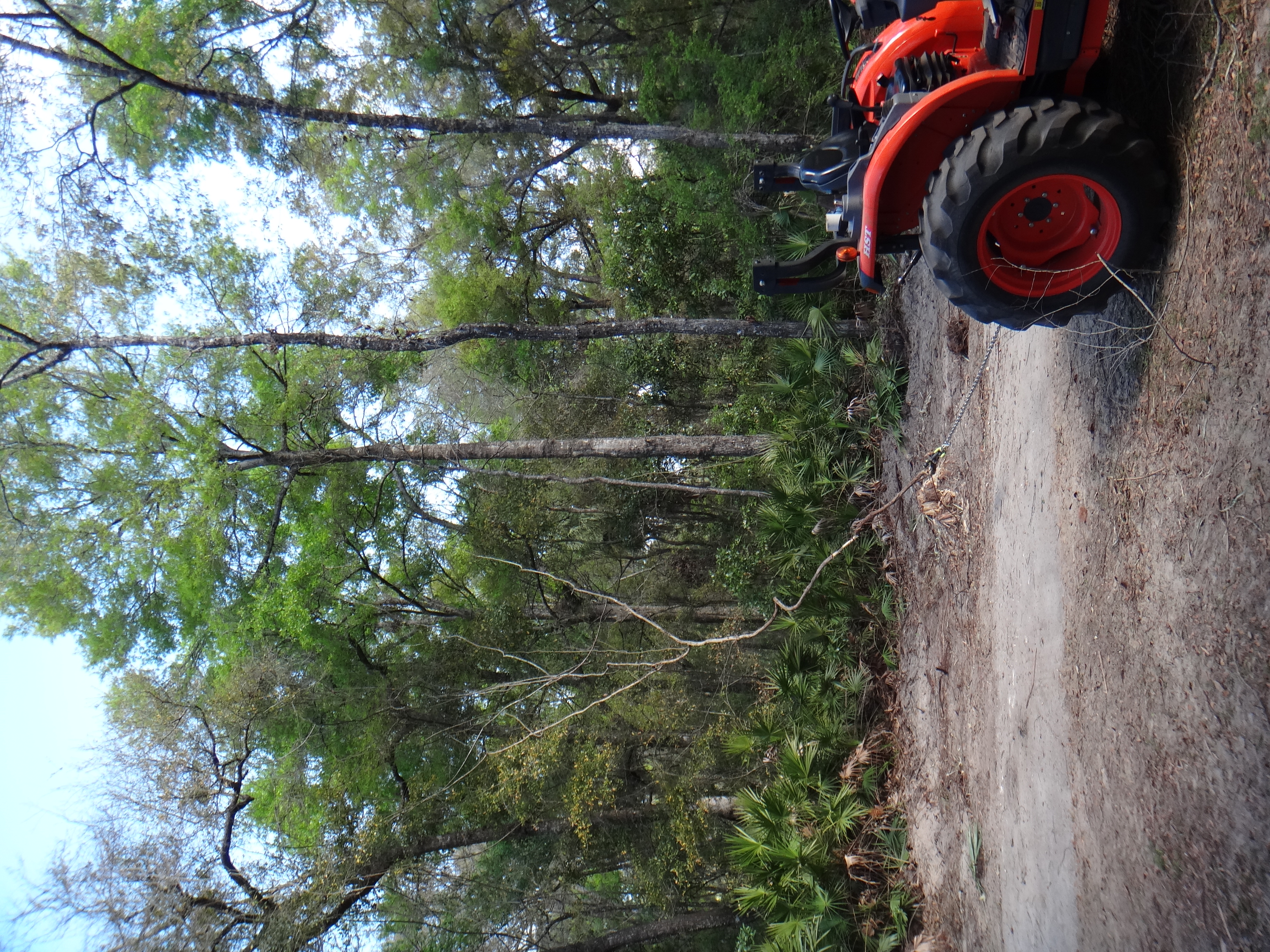

Today I pulled native Flordia grape vines from Oaks. Photo #4 + #5

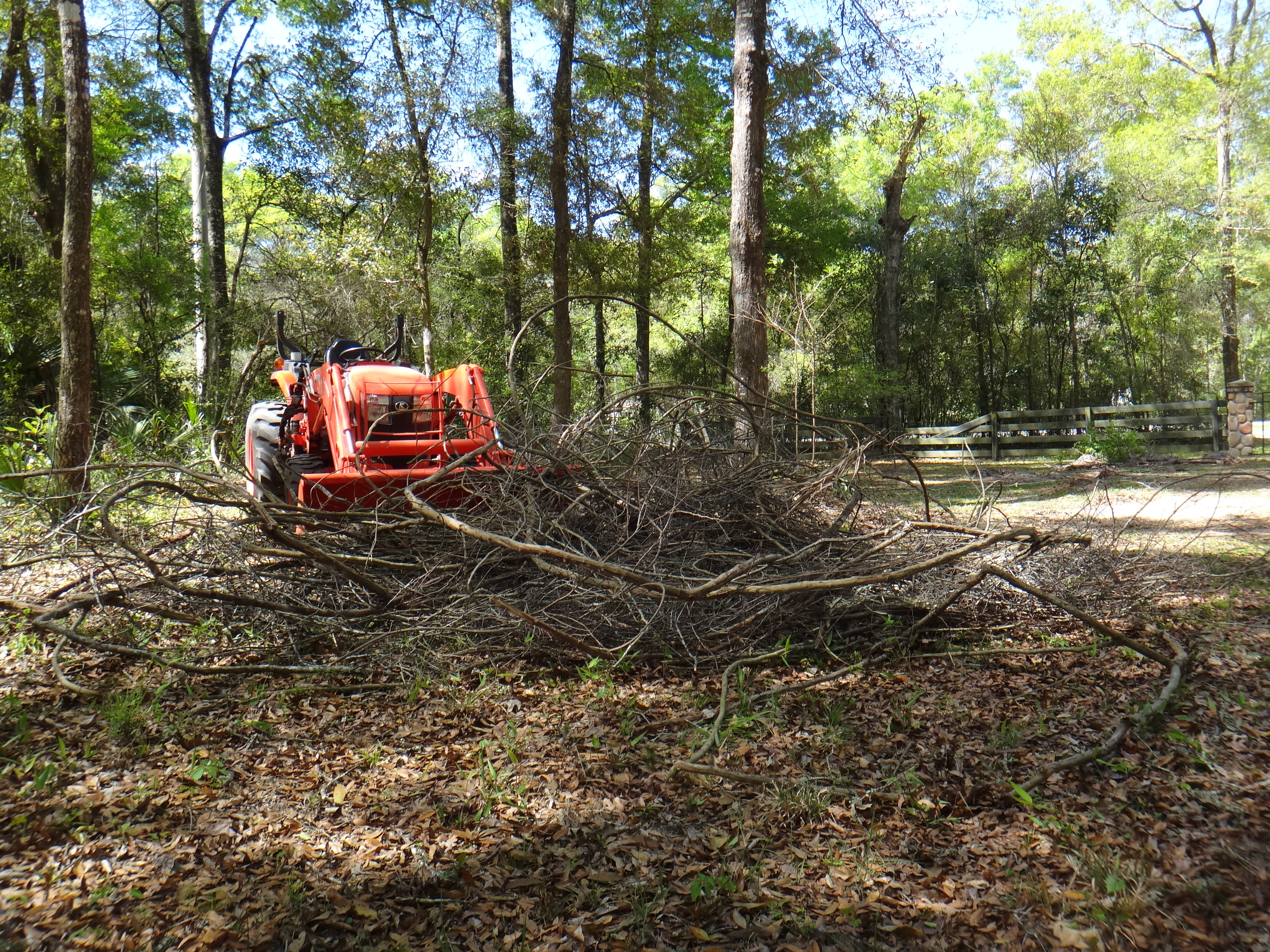

Which resulted in a large pile of removed vines on the ground. Photo #6 + #7

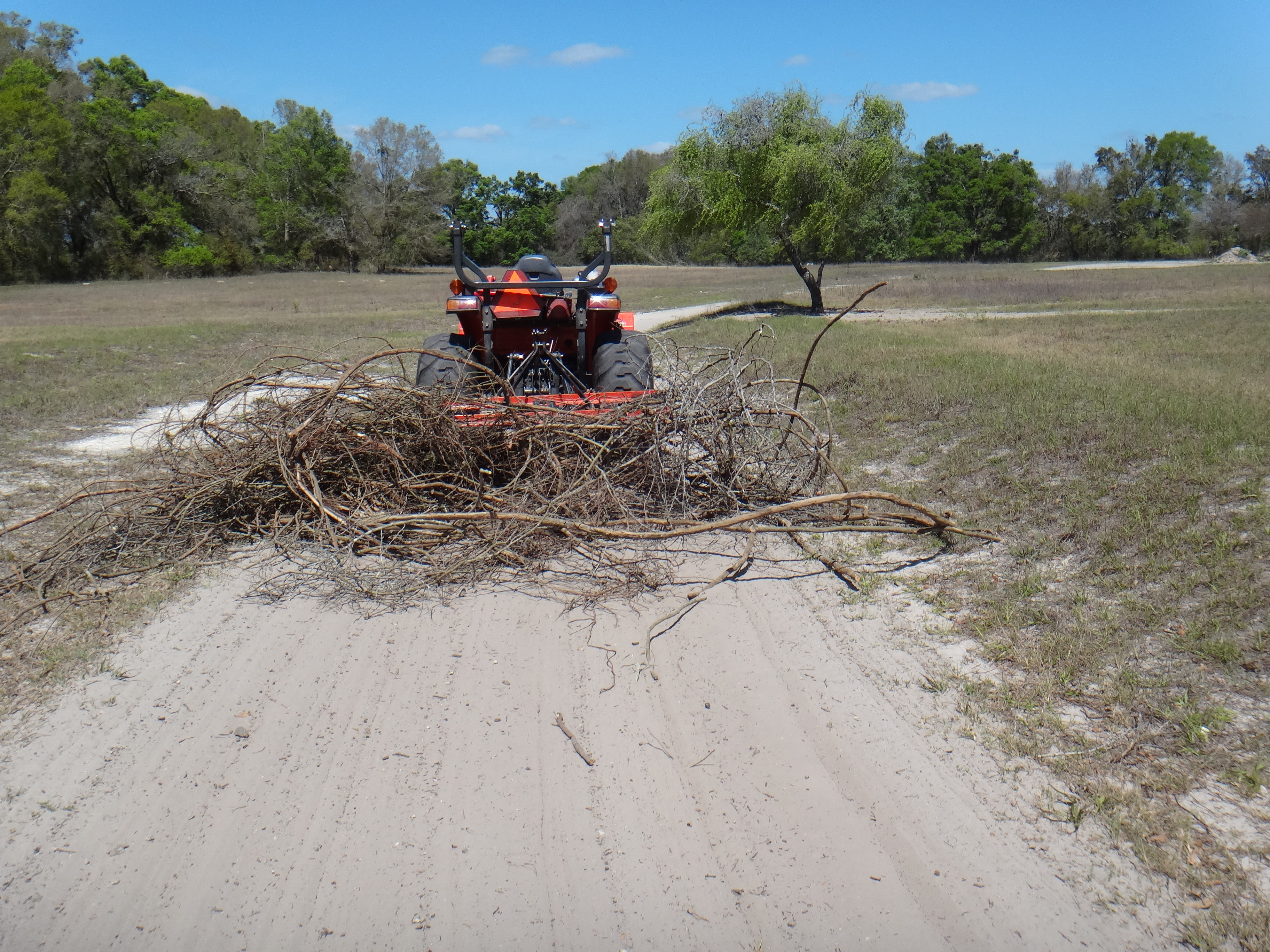

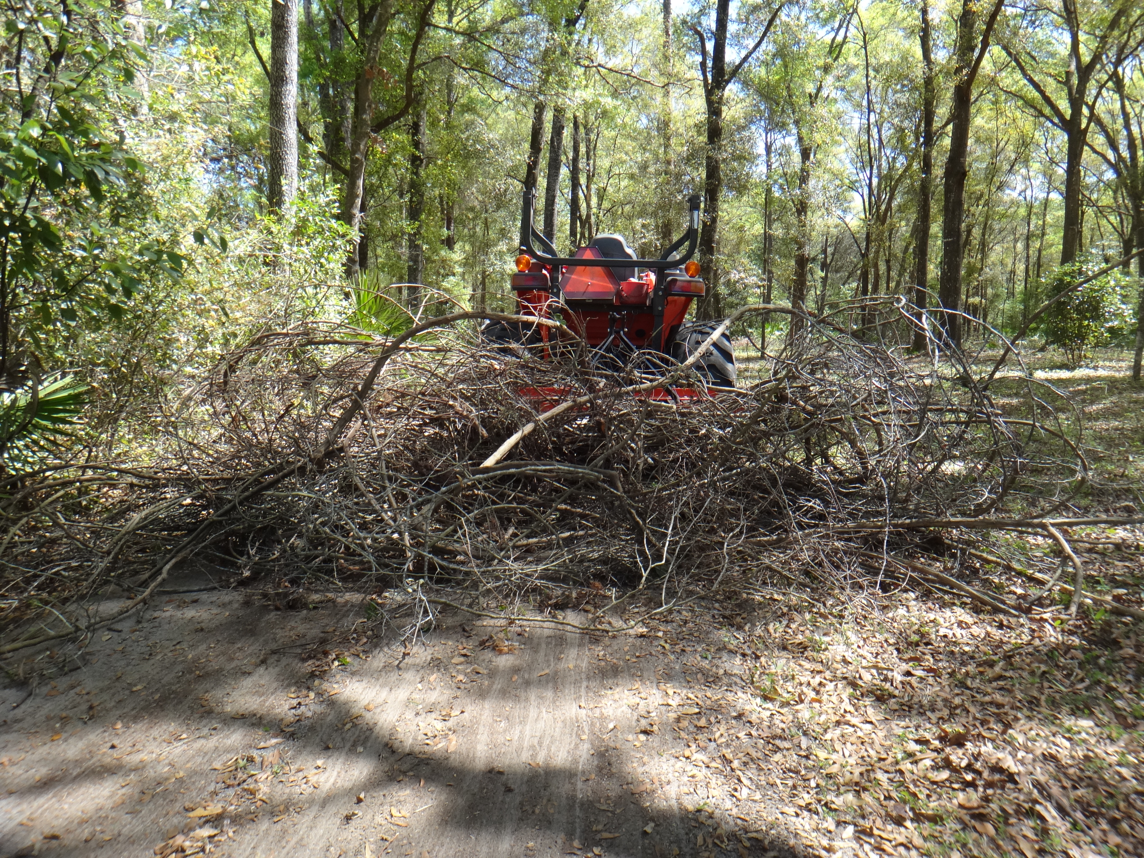

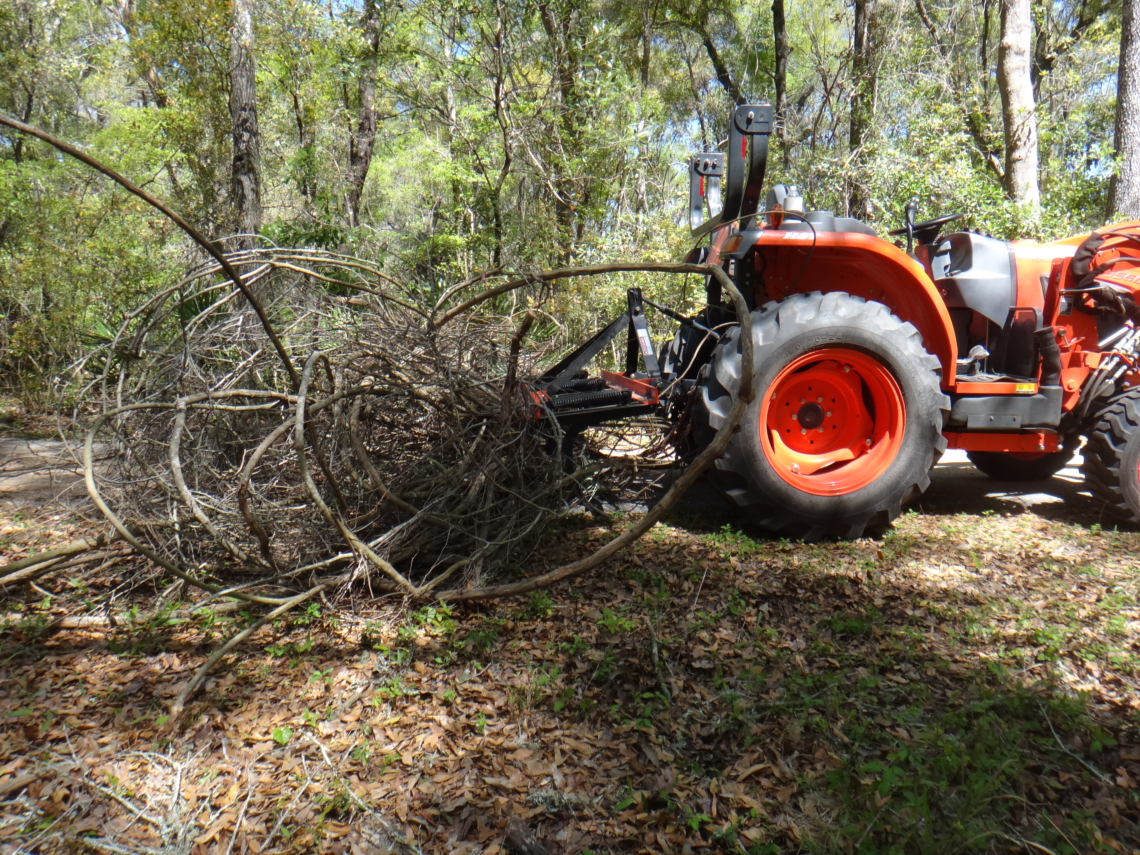

I do not have a grapple. Instead, I use my Dirt Dog "All Purpose Plow" AKA: Field Cultivator, for transporting vine debris 1/2 mile to the burn pile. Top Link adjusted long, so points are 'fish hook' oriented. Photo #7 + #8
After vines are hooked into the implement and transport commenced, the former resting place of the vines is clean. Photo #9
During transport debris acts as a natural broom on dirt farm roads. Photo #10

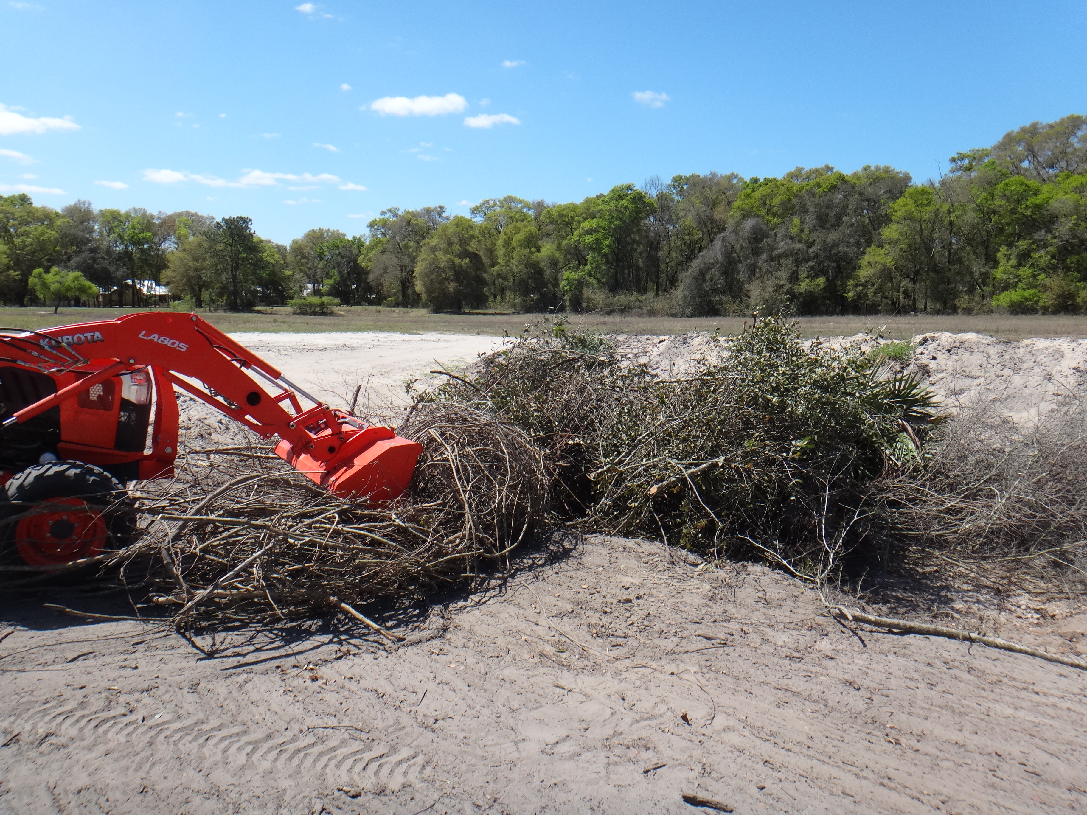

At the burn pile I did use a Lopper to cut loose the vines from the Field Cultivator for the first time. Usually the Field Cultivator reliably self cleans in reverse, but not with this bulk load of dry vines. Photo #11
