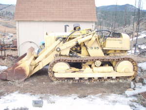

My M8540 should be in the next week or two and that should have the power to do the work myself. A neighbor is trying to sell a Allis -Chalmers Bull Dozer 545 for $2000. He just bought the property. Another neighbor who has worked on it a little says the steering is frozen and will have to be repaired (about 25 hours work + parts) and needs new battery.. That would be a good addition to mass move dirt but it could cost a lot to get running. If I offered 3 or 4 hundred, I don't know if it would be a good deal. I don't know any thing about a AC.

By the way, here is pic of the AC

Catman1, I would consider that AC for $1000, pay the neighbor to fix the steering and your good to go. Not many people on the board would agree with me, But I have had very good luck with old equipment myself and would give it a try. It would be a good machine to have some fun with.:)

I will take a good look at it and see if I can get it started with a battery. My Ford 535 may get it started. If the engine is good it might be worth it. It could move a lot of dirt.
