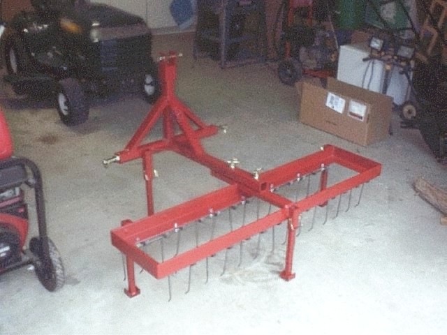

Has anyone built or added a stand to support a rear blade when it is off the tractor. Any photos or drawings would be great.
   / Rear Blade Stand #2
Here is a picture to give you an idea of what can be done. The stand is 1" x 1/4" square tubing. The holder is 1.5" x 3/16" square tubing. The foot pad is a small piece of 2" bar channel. The 1" tubing stand fits inside the 1.5" tubing holder with a little slop to allow the stand enough room to move up or down. There are several holes drilled into the stand to allow the stand to be fixed in several positions up or down.

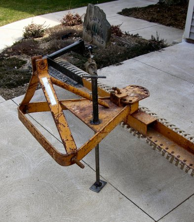

I will take a picture f my rear blade tomorrow. It is a Frontier RB2072 and came with a stand buit on. It is nothing more than a welded piece of tube with a steel leg rod that slips in and then is pinned to hold it in place. Reverse it (leg in the air) when the blade is in use.

Here's another option that could be used for just about any implement.

Thanks Bota - that is exactly like the Frontier stands.
