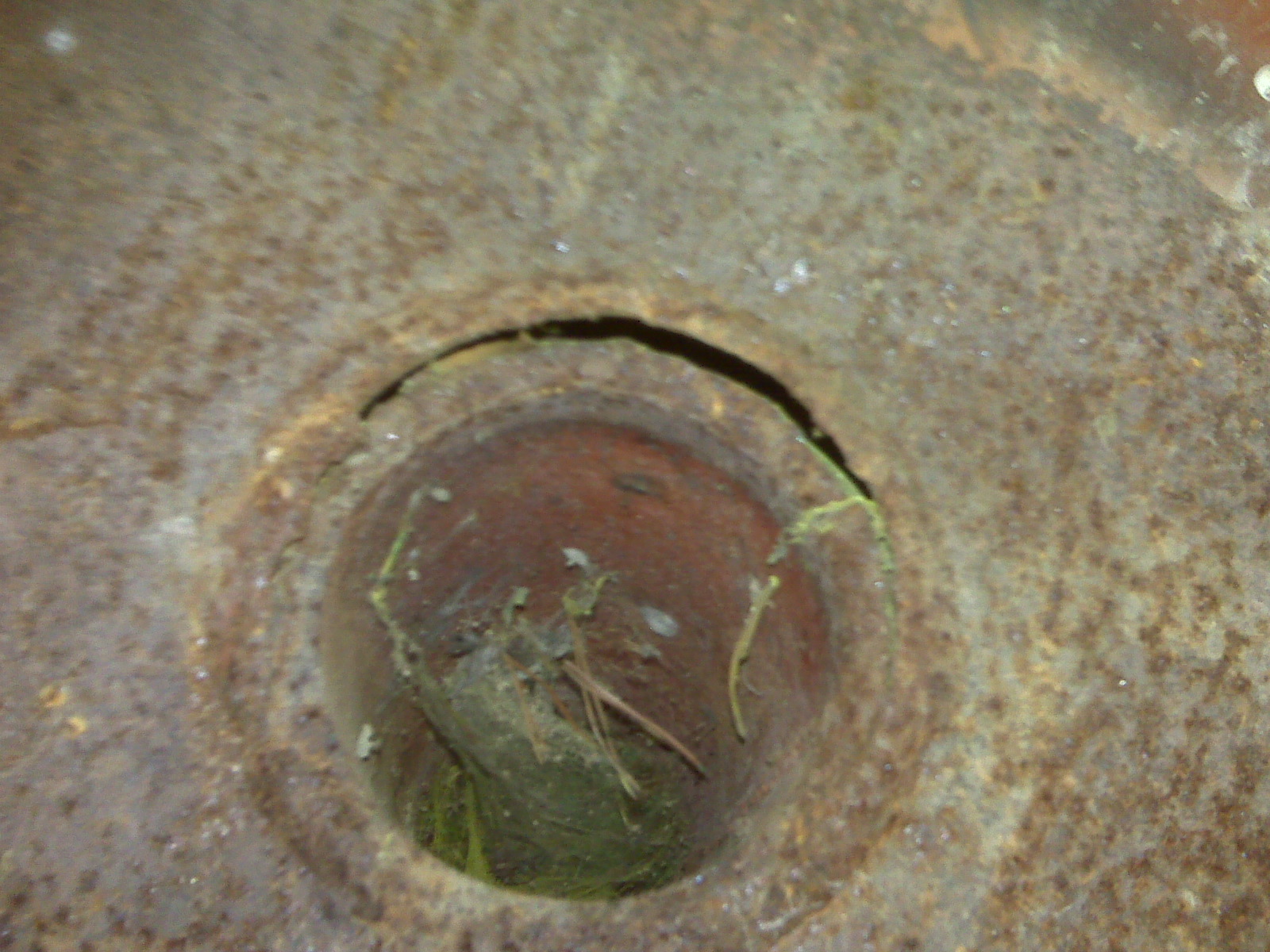

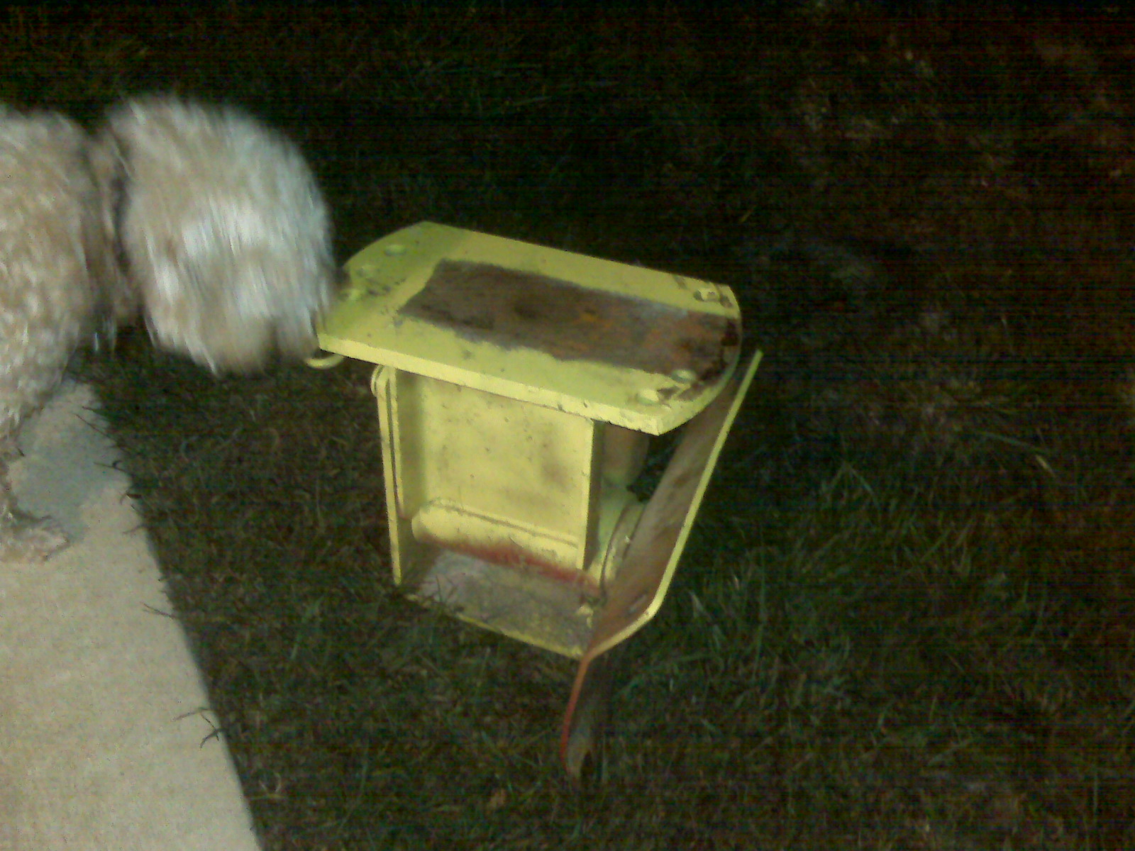

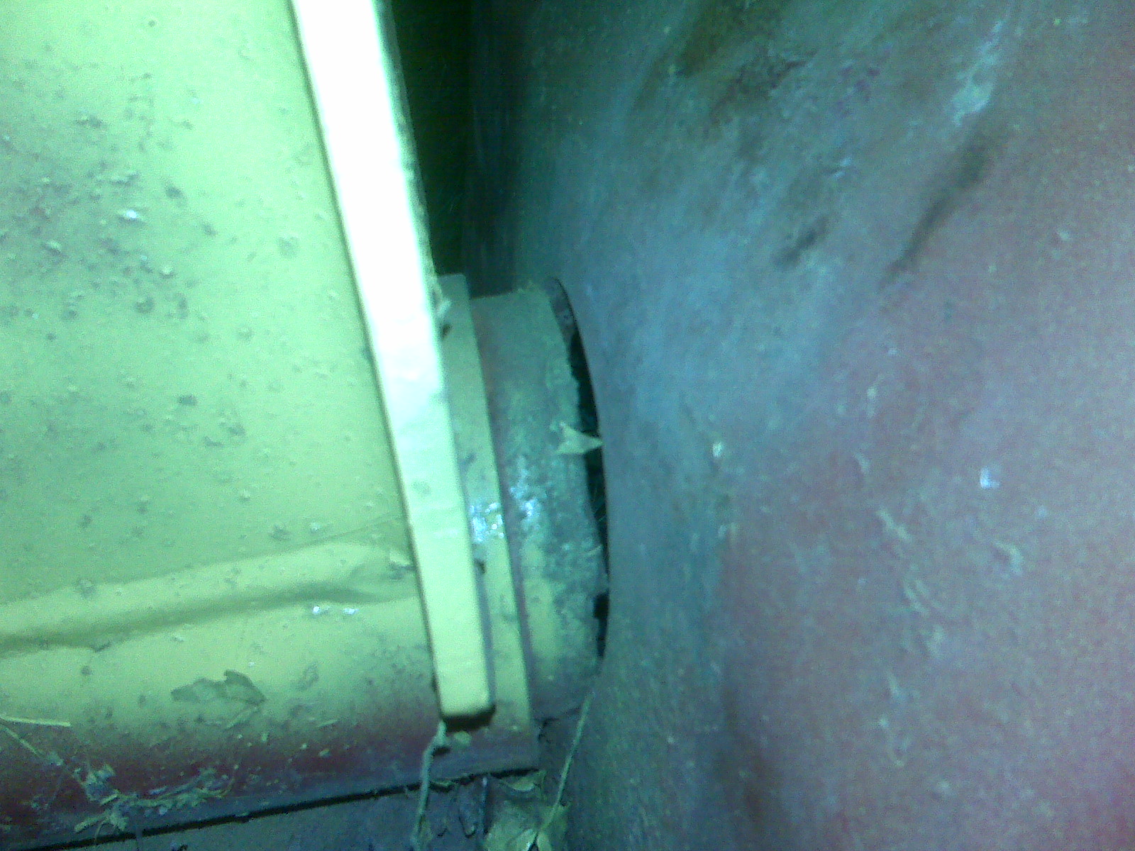

Question: Why does my rear blade keep breaking off the swivel?
I have a 45 hp tractor pulling 5 foot swivel blade and every two years the weld breaks. Is it that I need a heavy duty blade, is my tractor too big for the blade, or is this just a fact of life? I grade some ditches, dirt paths and sometime hit some roots that stop me.
What do you suggest and what is a recommended brand?

I would say that your blade is way to small for your tractor. Usually for your size machine I would use a 7 footer that is at least medium duty. Land Pride or Woods make good implements. There are others also, but those two are the first that come to mind. Land Pride shows a weight rating for their blades, that should help you.

Thanks all. I looked mine up on the web and it was a Woods standard duty rated for 40 hp. So I guess I need to go up to a medium or heavy duty 6 or 7 footer. Any pros or concerns on these choices?

I had the same problem with a 6' Howse I used behind my Jinma 254 with R1's. My Ford 861 has no problem with this blade but the Jinma is just too much for it. My Jinma is heavy, 5,200#, and I could brake the blade at will. I busted it 2 times just pushing snow in the same fashion as you. I went with a 7' HD Woods and have not had a single problem.

I used to have a TSC blade on a Kubota M4700 (45 hp). I was a frequent customer at the local weld shop :( Later, TSC started rating their stuff for 30 or 35 hp max.
I upgraded to a Woods medium duty blade (MD72) and have not had any more problems in ten years, even though the current tractor is a bit more capable (M5040, 4wd).
