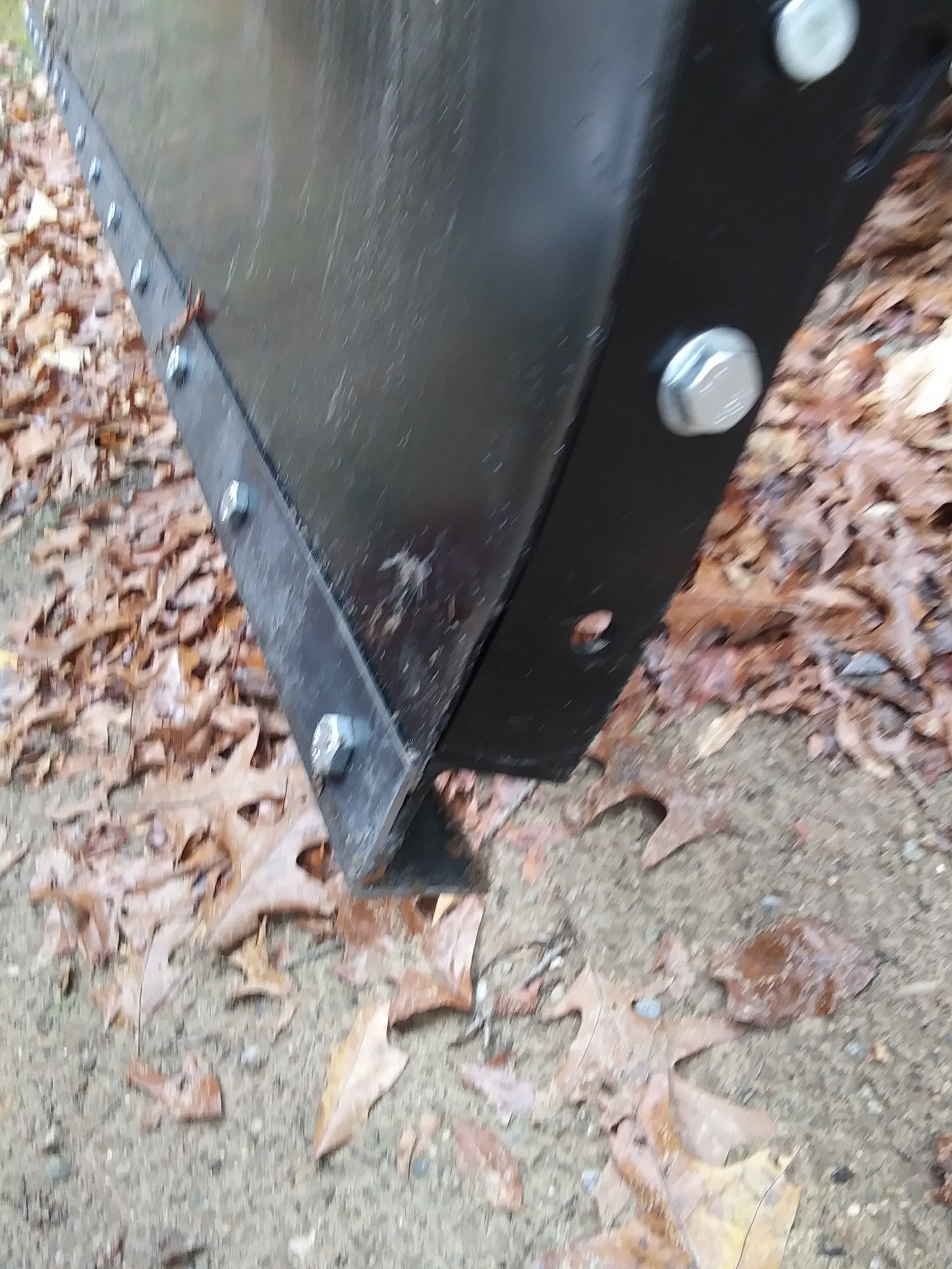

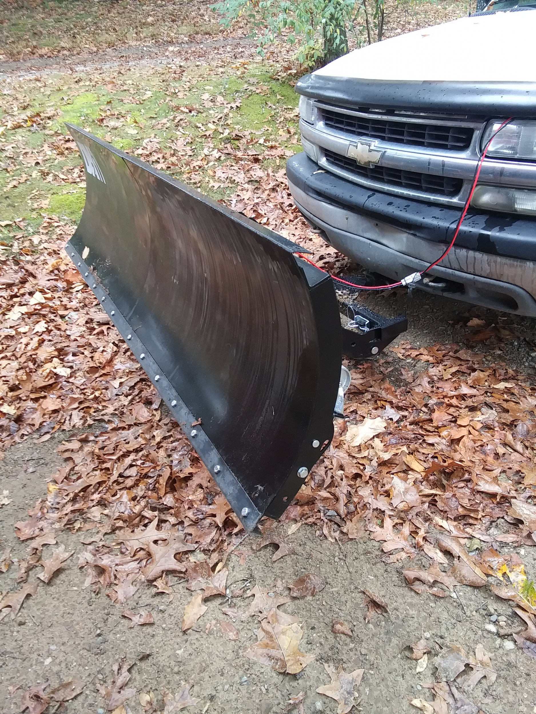

I tried pipe, it worked....sort of.
Hard to get it cut straight & keep it mounted.
Found out just a piece of angle iron works better & is SOOOO MUCH easier to attach.
5' ATV plow on front of tractor I just bolted through the cutting edge to attach a piece of cheap bed frame.
Worked good enough that I could plow paths through the grass without tearing up anything.
7.5' truck plow... replaced cutting edge with 3" angle iron.
Sure is better then pipe.
