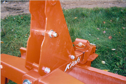

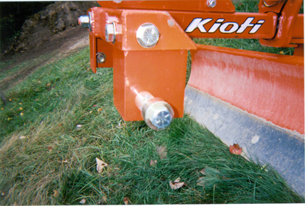

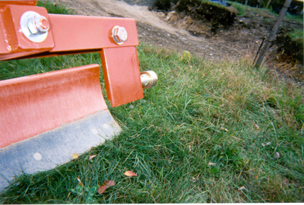

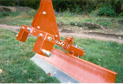

I have a Midwest RB22-60 on my BX23 - it has the tilt, offset, and swivel features. When I was looking around at rear blades the Midwest seemed like the best deal of the bunch if you want all those features. The offset in particular is easy to use - you just take out some pins and move the blade and put the pins back in. I believe the Woods and most of the others you need to unbolt the blade and rebolt it up to offset it. I did not want that because I wanted to able to move the blade without carrying tools around. Midwest also makes blades for Kioti and for Corriher. The blade I got is actually a Kioti blade for two reasons - there was Kioti dealer in my area that had it in stock ( and I couldn't find any Midwest dealers) and because it is orange it matches my BX23. The 60" size works great with the BX.
Now for the downside - you will have to modify the blade to get it work on the BX 3pt because of the limited lift capacity. The modification is pretty easy - you need move the lower mounting points downward about 6" - this will change the geometry so that you will get as much lift out of the blade as any other BX sized implement. I have attached some pics of the mod I did - it has worked out great. I can even spin the blade around 180 degrees with it attached to the tractor with this mod.

Another pic showing mod to upper mounting frame - I use this blade in a Speeco quick hitch so I put in a bushing for the upper mount point.

The brackets to lower the mount points were made with 5x5 angle iron and bolted to the frame - they could be removed and the blade used on a regular Cat1 3pt.

One last pic
