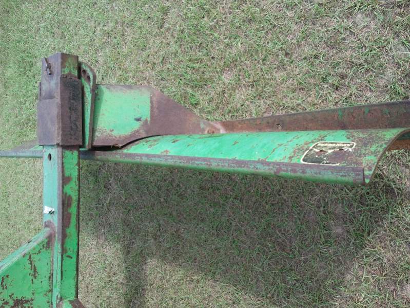

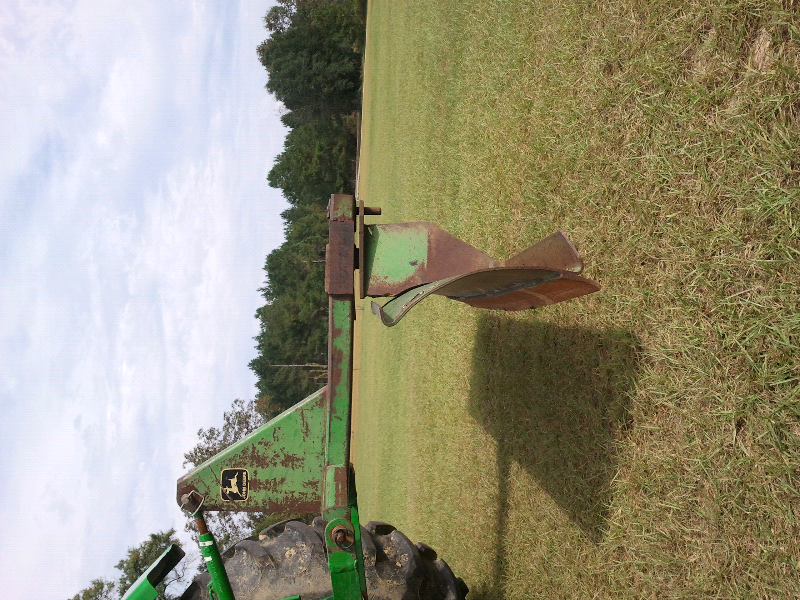

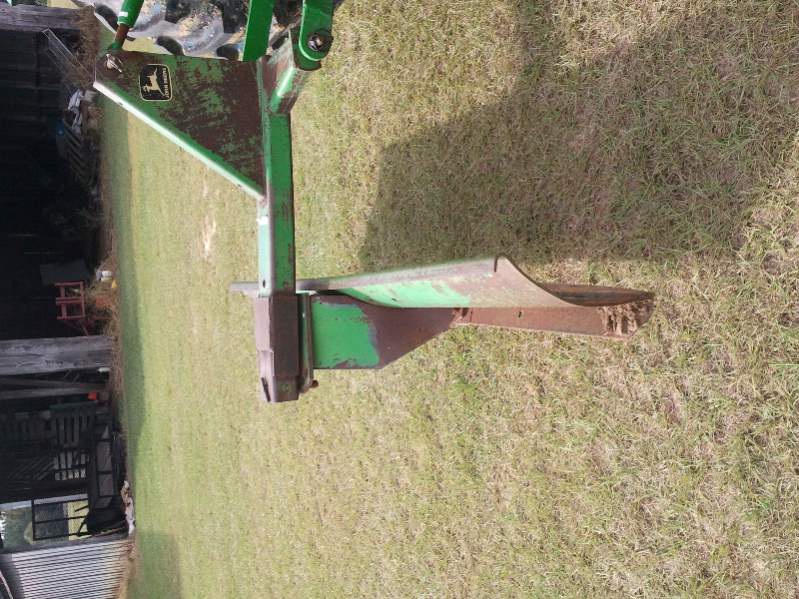

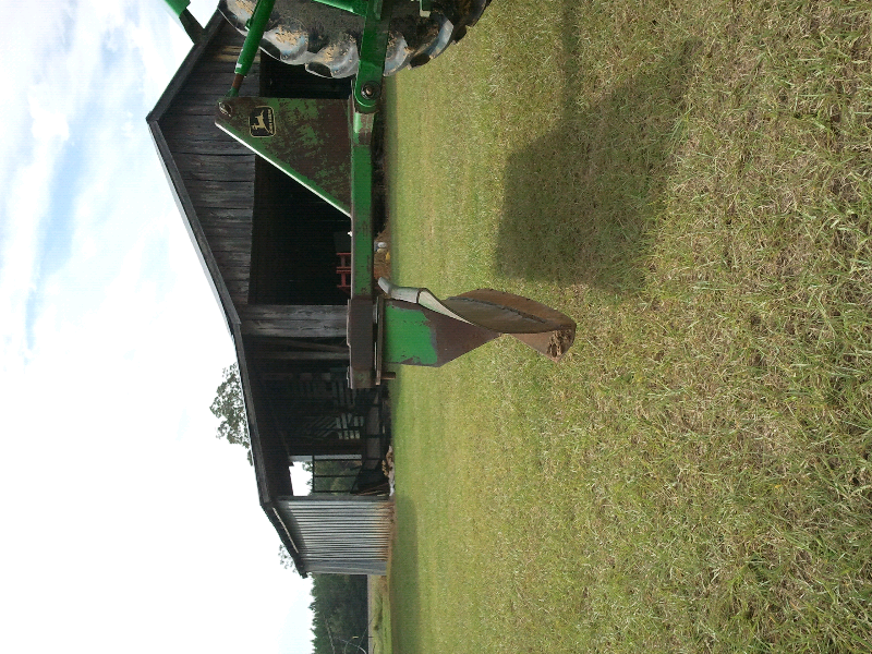

Got it hooked up and made a few passes along the drive. Really like being able to grab rocks on the edge and roll them back away from the grass to the center of drive. Was able to tilt by adjusting 3pt hitch while angled. First time ever using this type blade.
I do believe the bottom has been pulled back some, but didn't seem to cause any negative, noticeable issues. What am I missing? What issues will occur because of this?

It looks like to me the top edge is tweaked foward on both sides. Since the moldboard has been bent it is probably weaker than what it would normally be.
