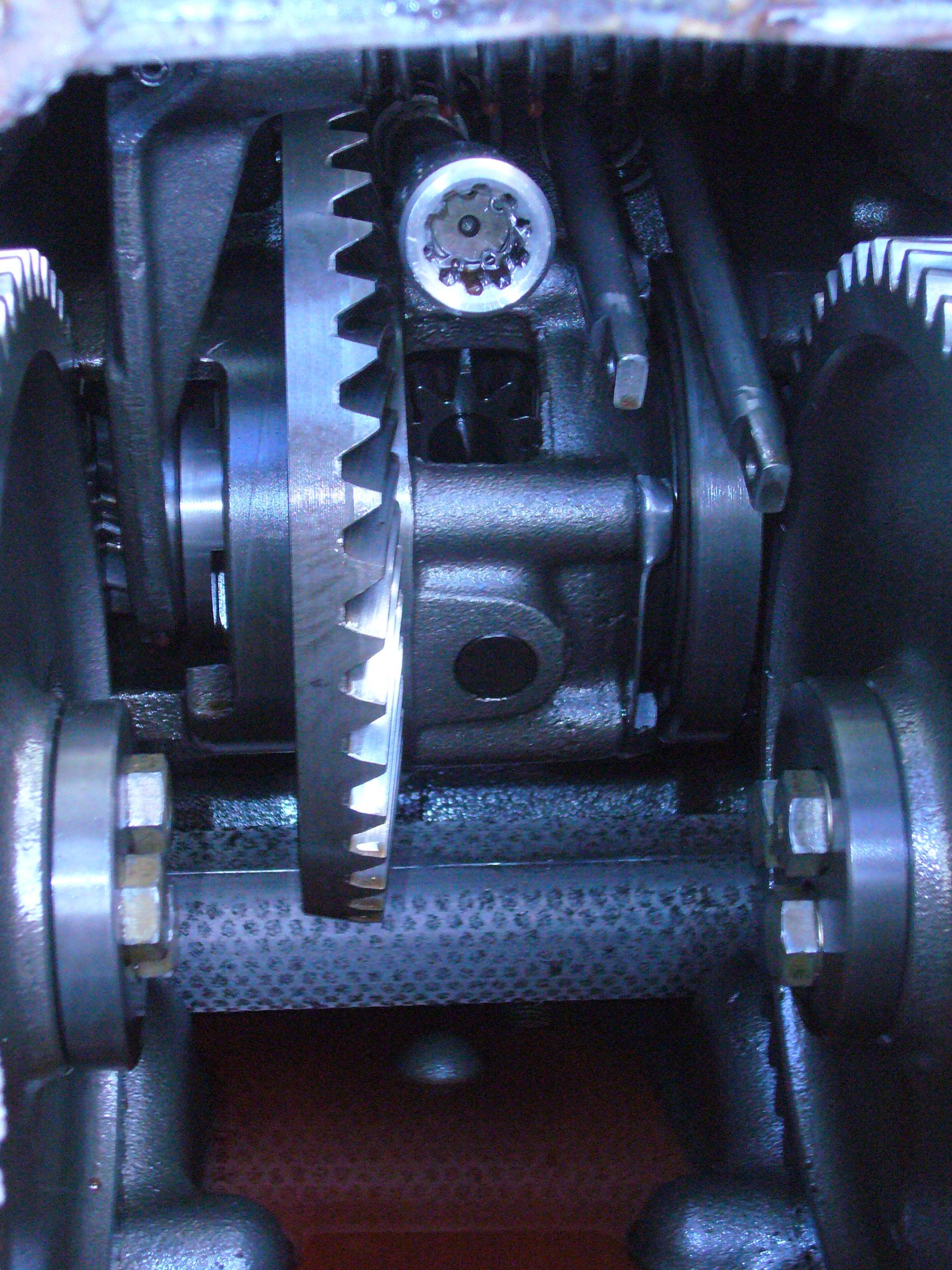

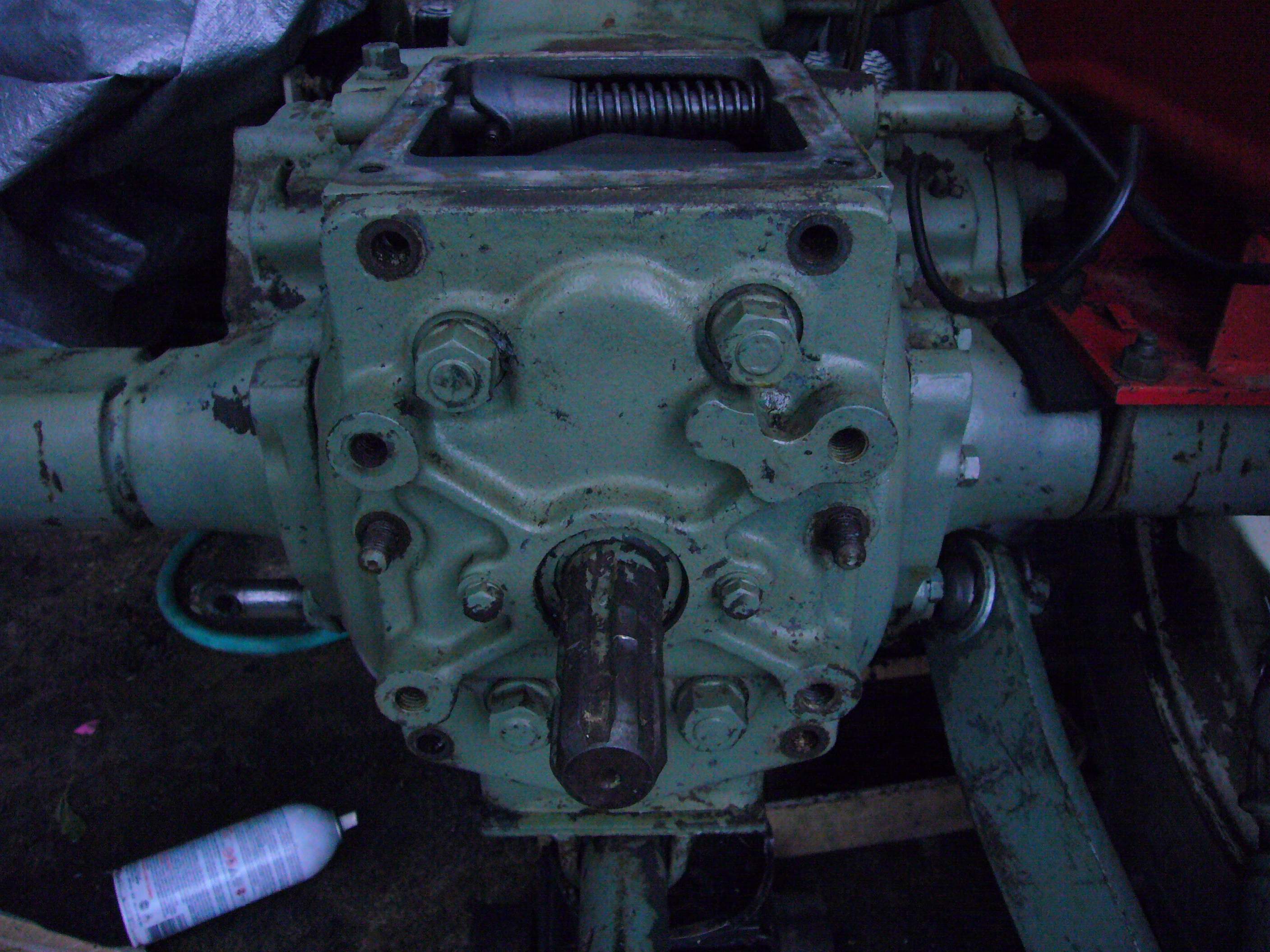

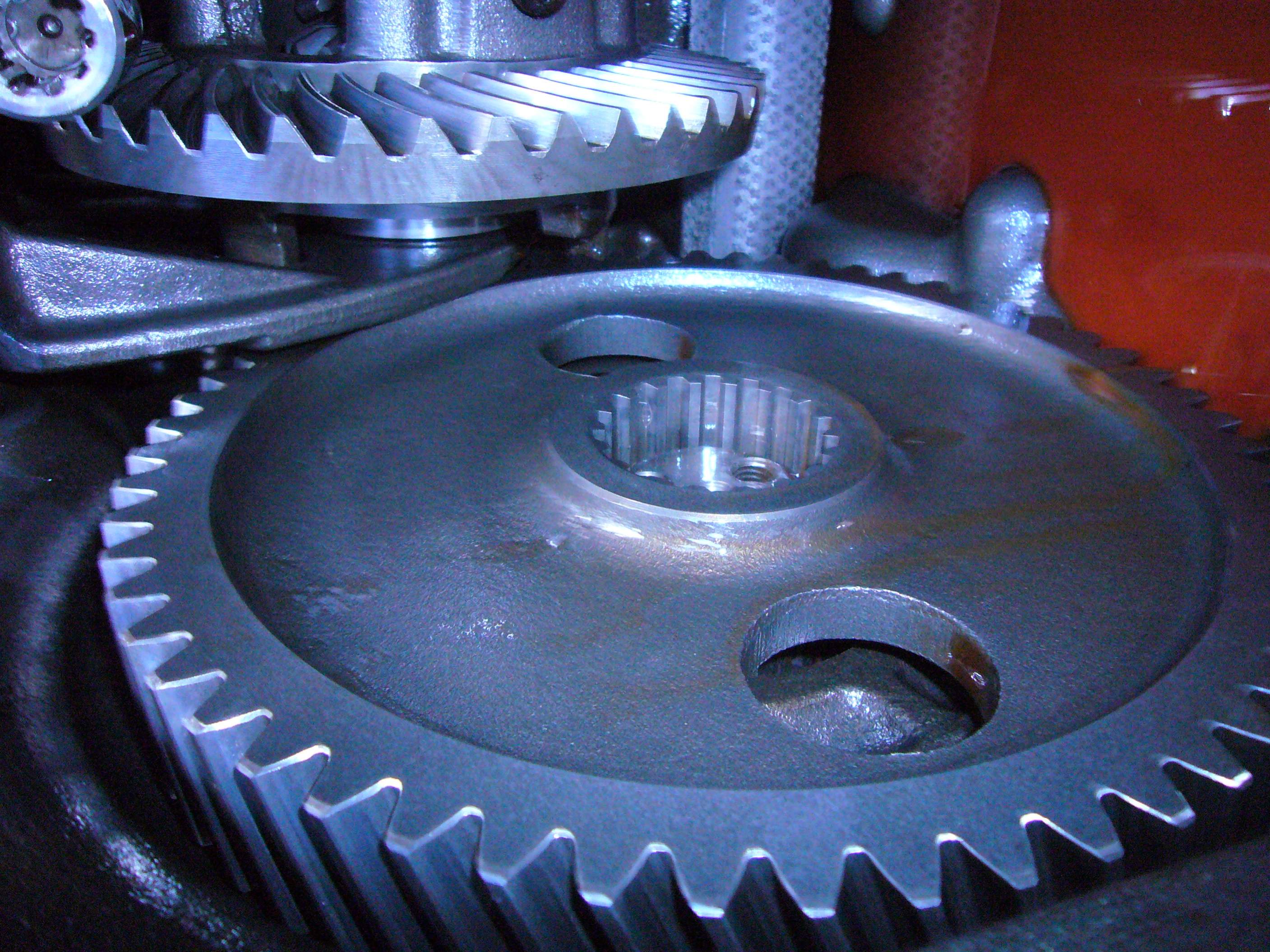

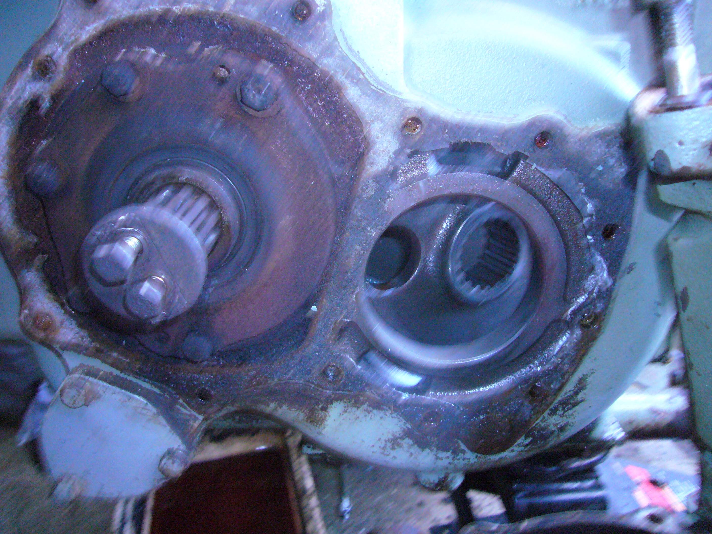

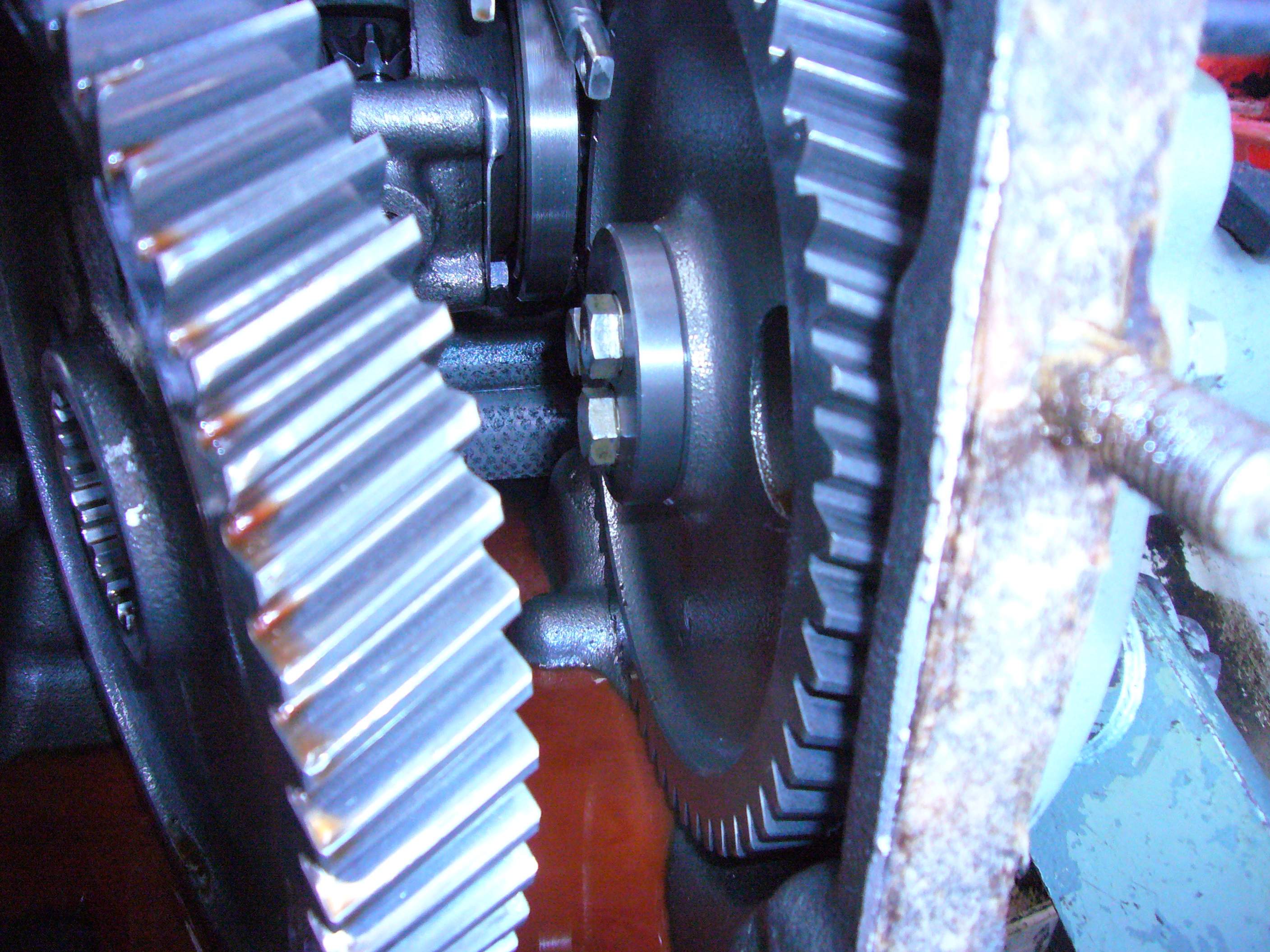

Trying to remove the axles from ym2210. It appears that I will have to remove the Pto gears etc... from the rear to access the bolts, clips etc... holding the axles in place. Before I just "take it apart", what linkages will I remove to allow the PTO gears, shafts to come, out as one piece, to access the axle retainers? I would like to make this a idiot proof as posssible as I'm the idiot doing this removal. attached are some a few pictures early on. Any advice or if someone has seen this before, offer suggestions. thanks.

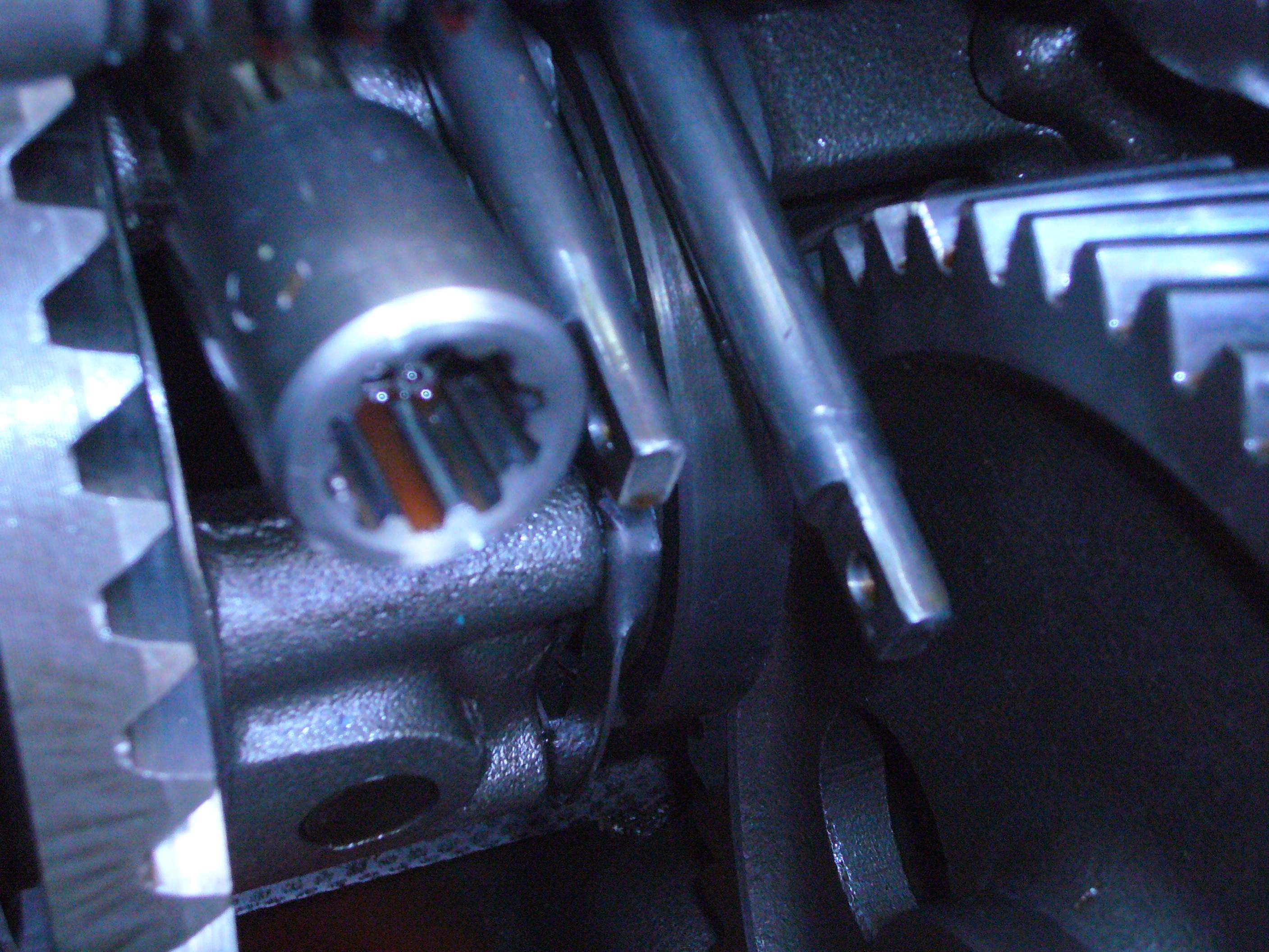

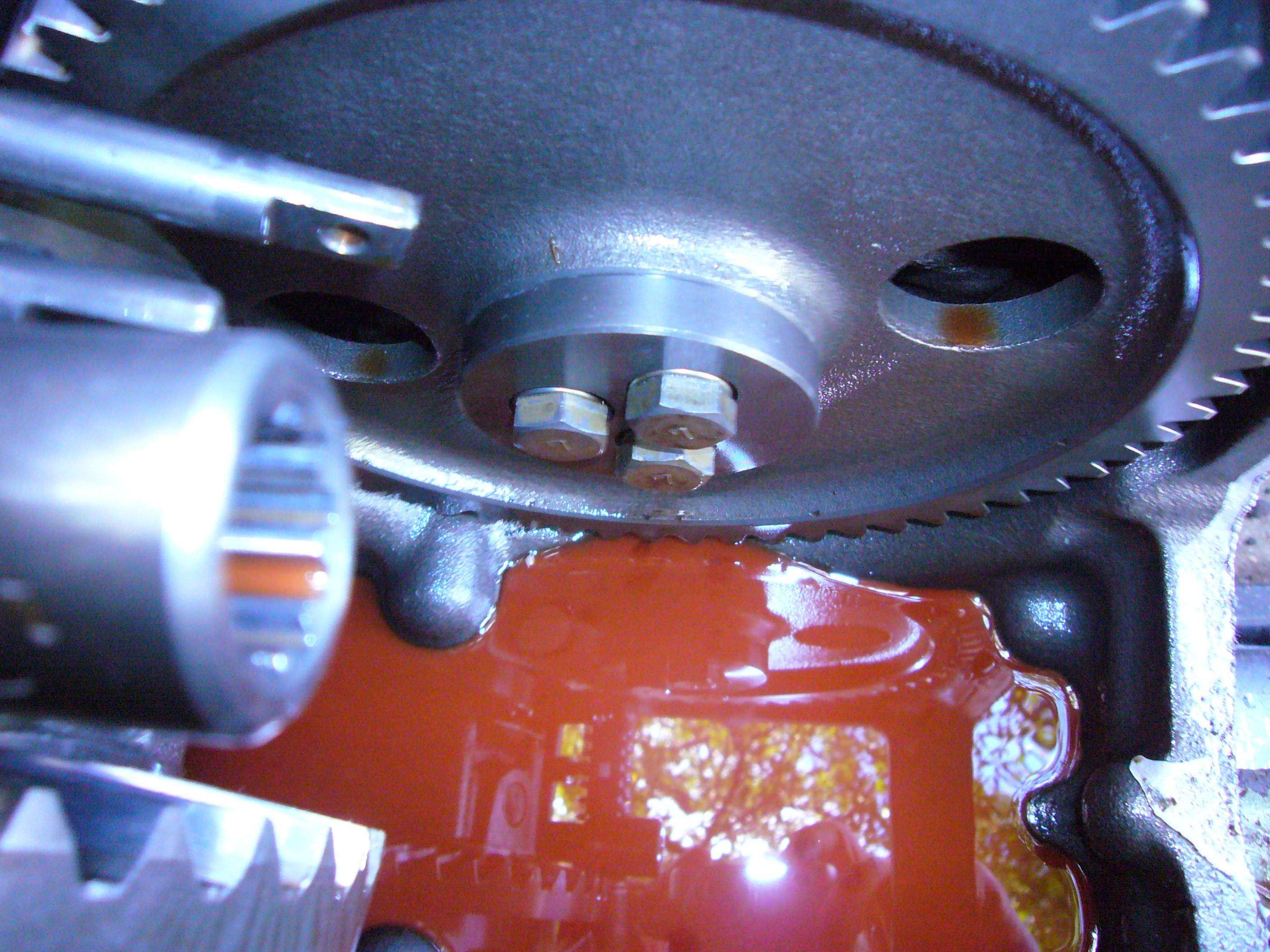

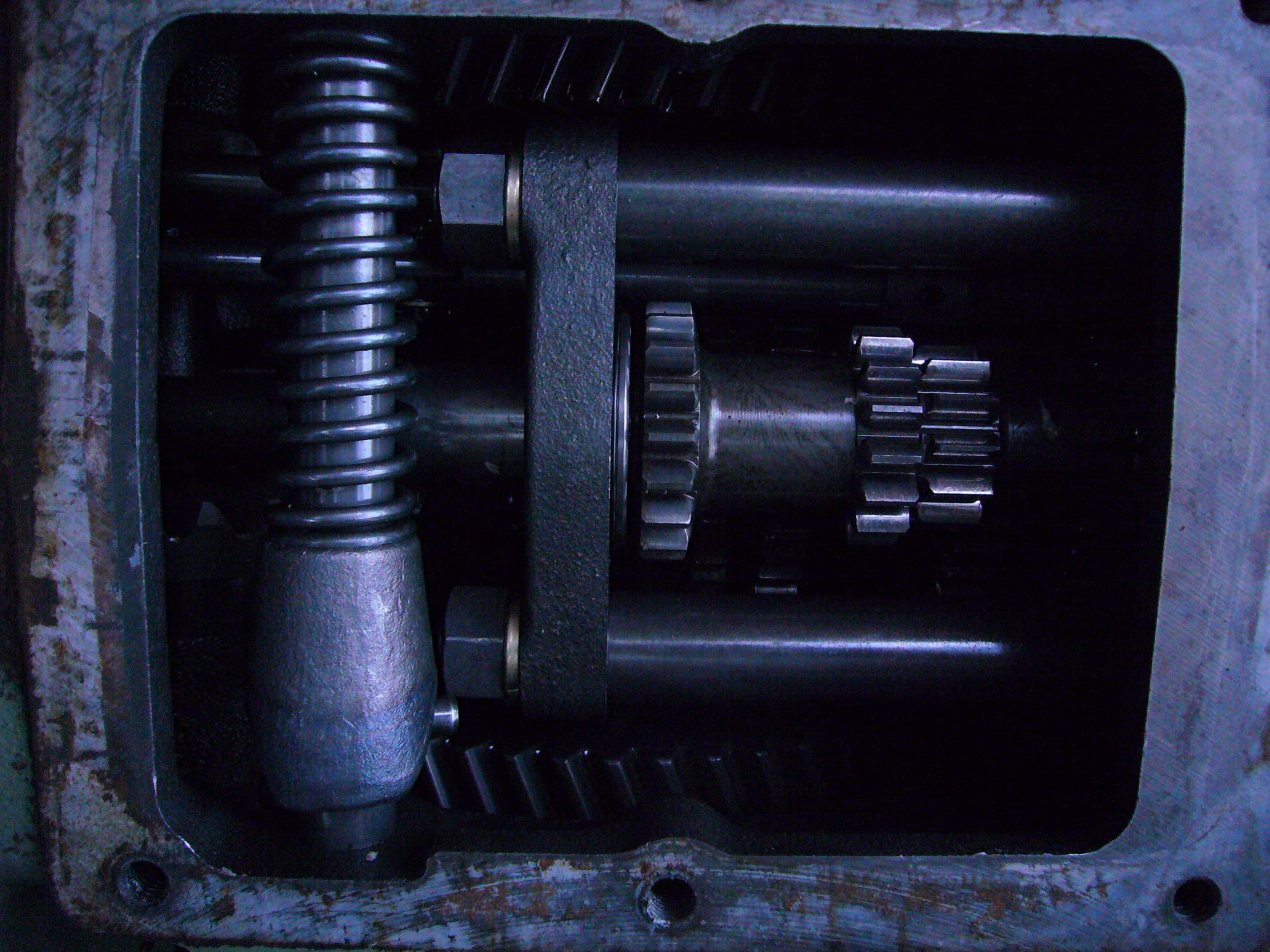

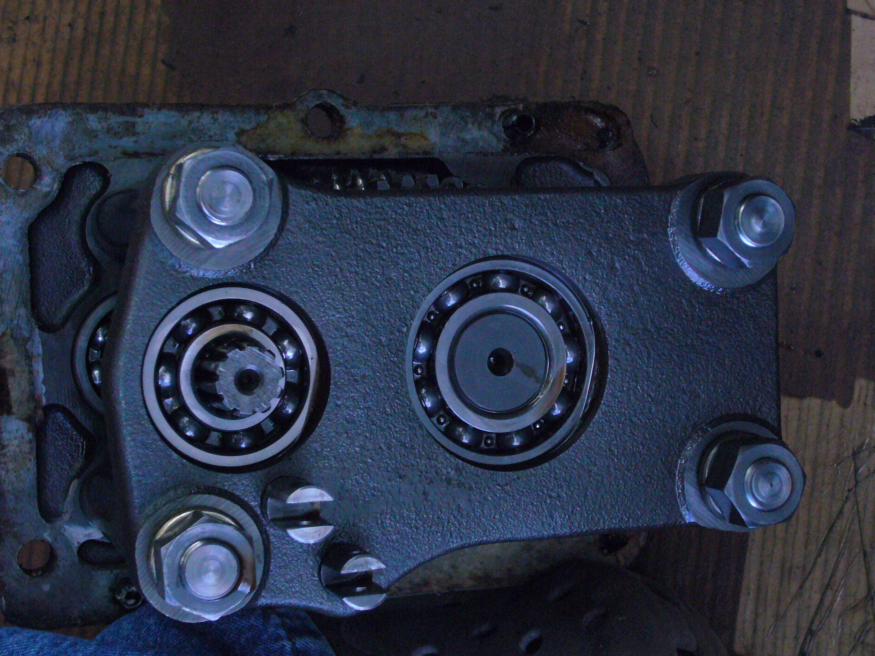

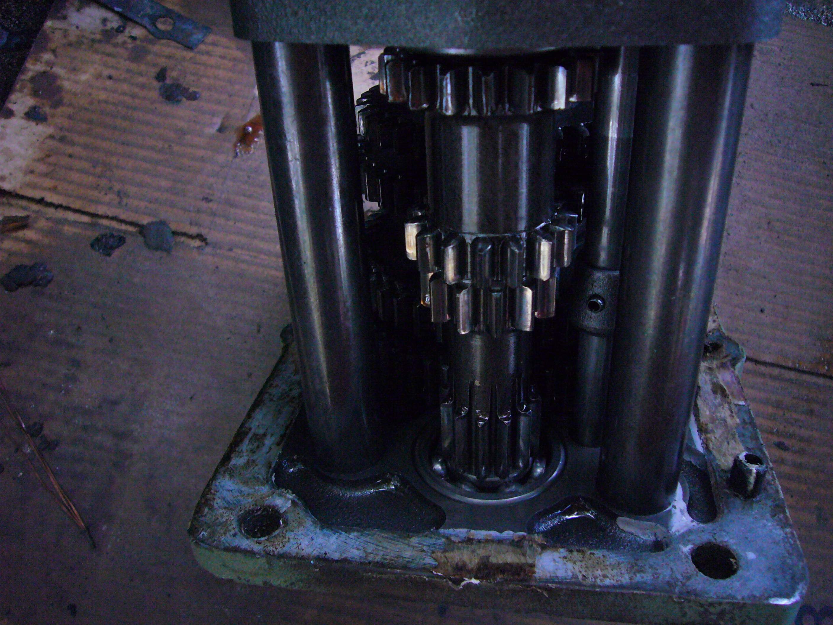

looking at dougs model and drawing, thanks. the axle on the 2200 model does come out with the housing. looking at my 2210 the large gear on the axles will have to remain in the differential housing, and the axle can slide out of the housing or with the housing dependent on fit of bearings to shaft (pressed or not). On the PTO plate 6 nuts/bolts remain 2 small near PTO shaft and 4 large nuts which attach to the two rods (seen from the top into the differential). my plan is to remove the 4 nuts and try to slide the PTO housing off from the back.
once this is done I will try to move the pto gears as one unit and "release" any "connections" that prevent the removal of the gears. Once the pto gears are out I hope to be able to remove the bolts seen in the picture on the end of the axle or circlip holding the large gear to the axle to allow axle to slide out. is my thinking right???? Help would be nice raining too hard to work on tractor today. ordering parts today.

seems that the shifting fork is comming from the bottom, when i shift the pto gear shifter the gears are being moved from below. now, the term shifting fork i envision as a "U" shaped fork that nudges the gears. Pto plate does not move at all with the 4 nuts still in place, and I removed the large circlip from pto shaft.
/ rear axle seals ym2210 #8
You are correct, the shifting fork is a u shaped item that slides in a groove on the pto sliding gear. Find where your shifting shaft goes into the housing, remove whatever is necessary to pull it out 3/8" or so. I'm thinking your assembly is holding on dowel pins or something. May have to wedge in there with a thin bladed screwdriver or something to get it moving. This is not a pto shift fork but a hi/lo fork. It is similar to what yours should look like. Yanmar Tractor Parts: HI-LO SHFIT FORK_

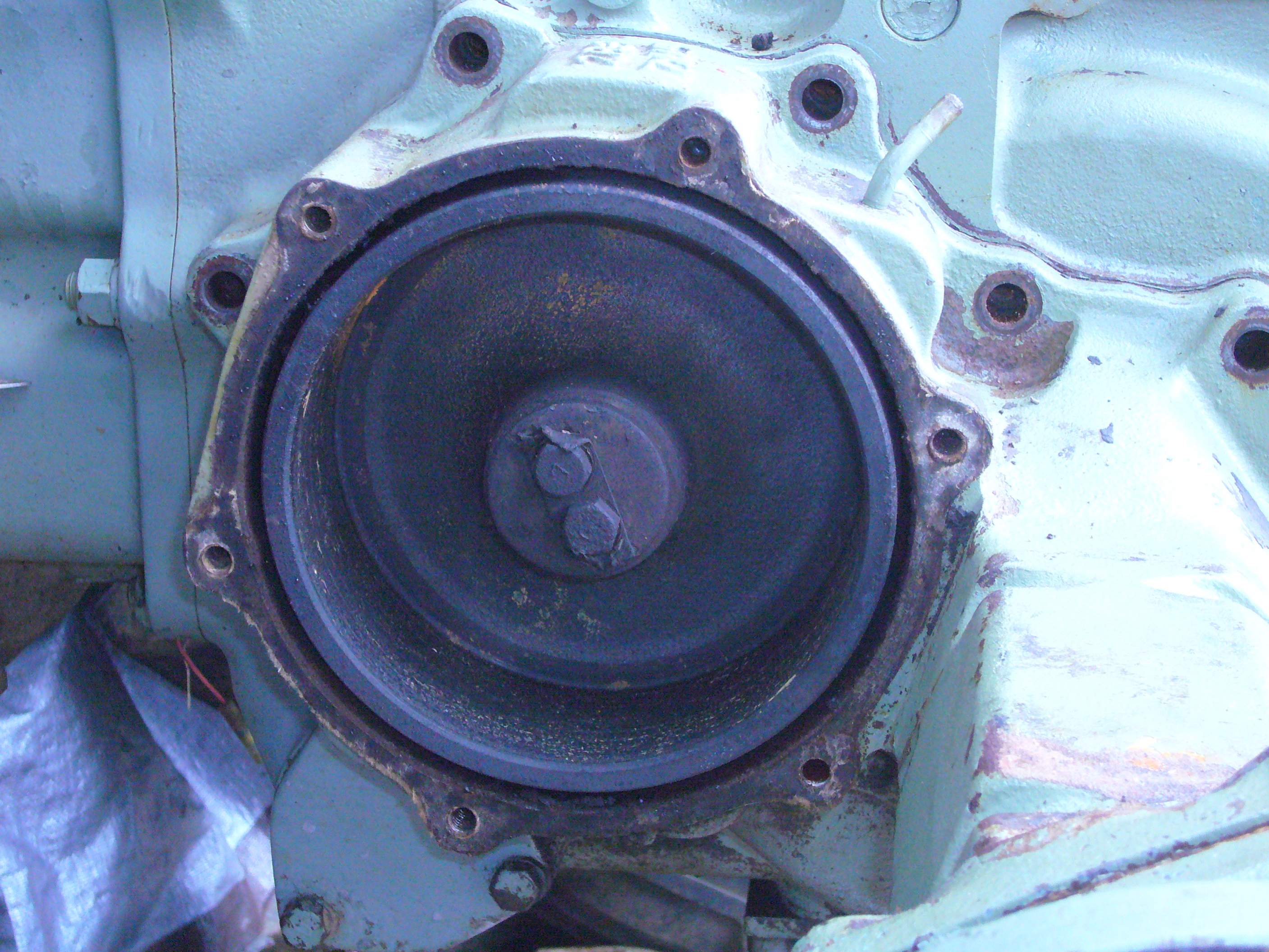

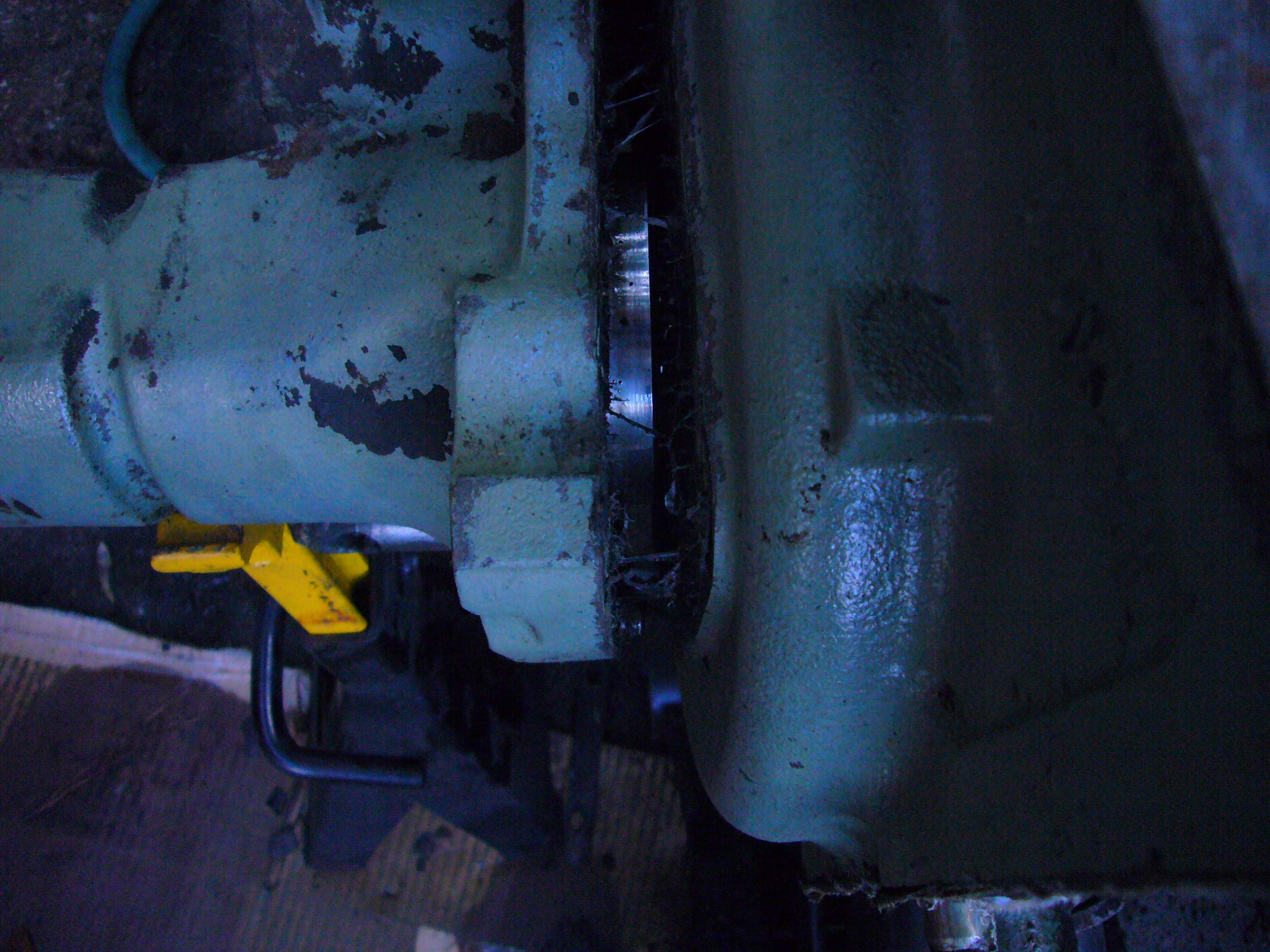

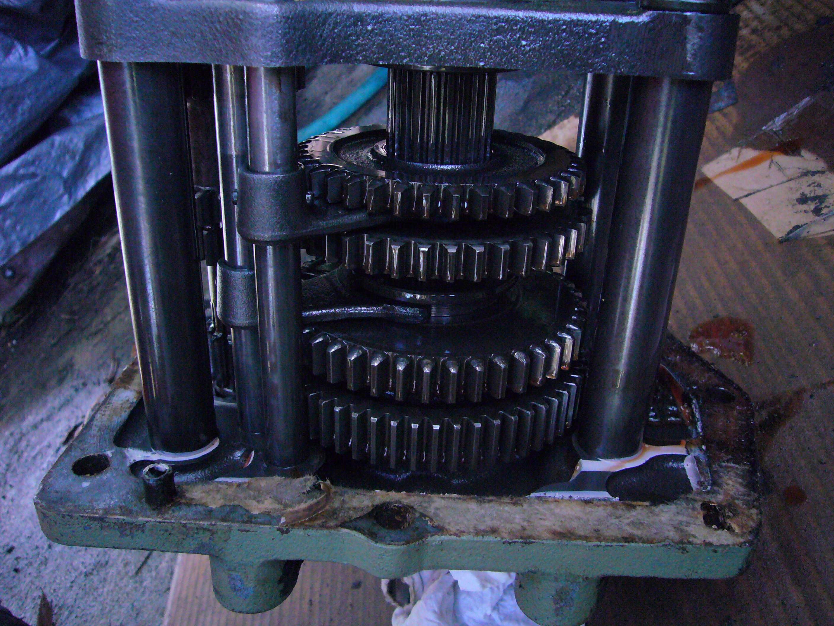

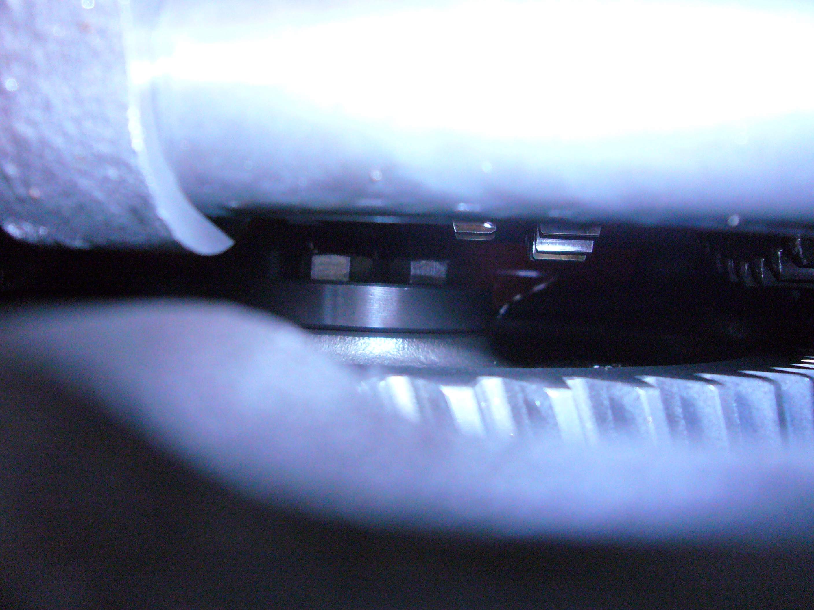

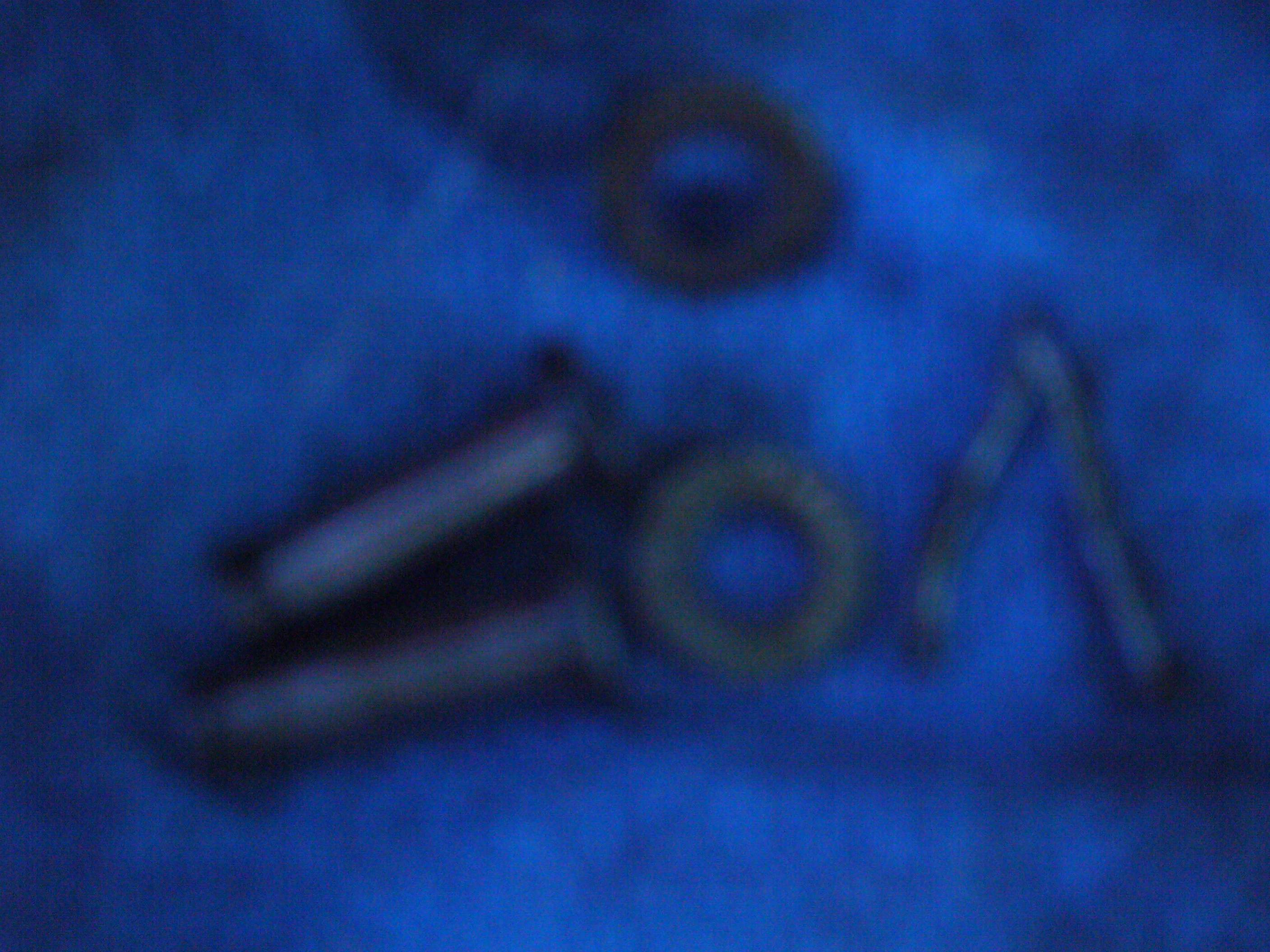

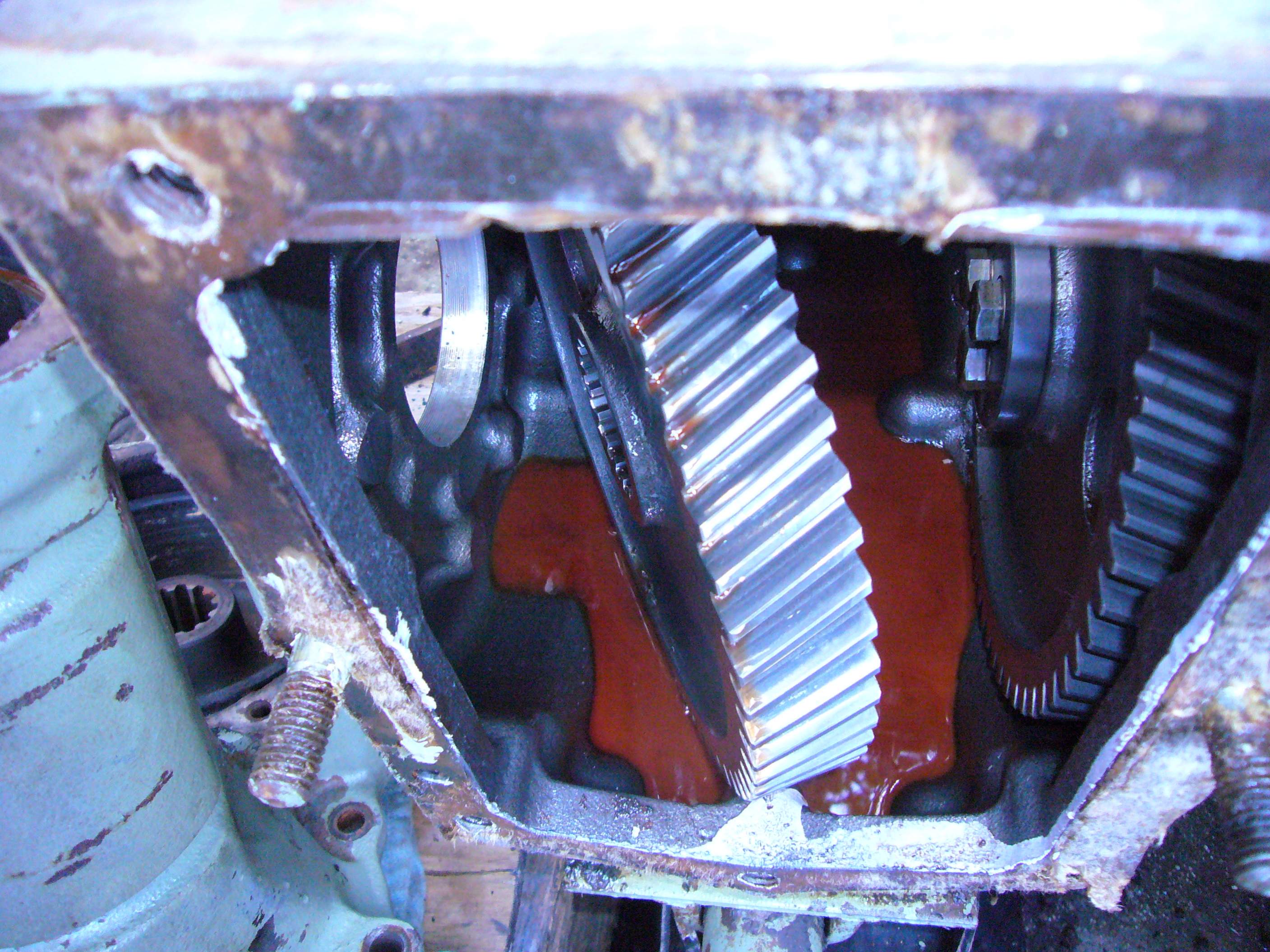

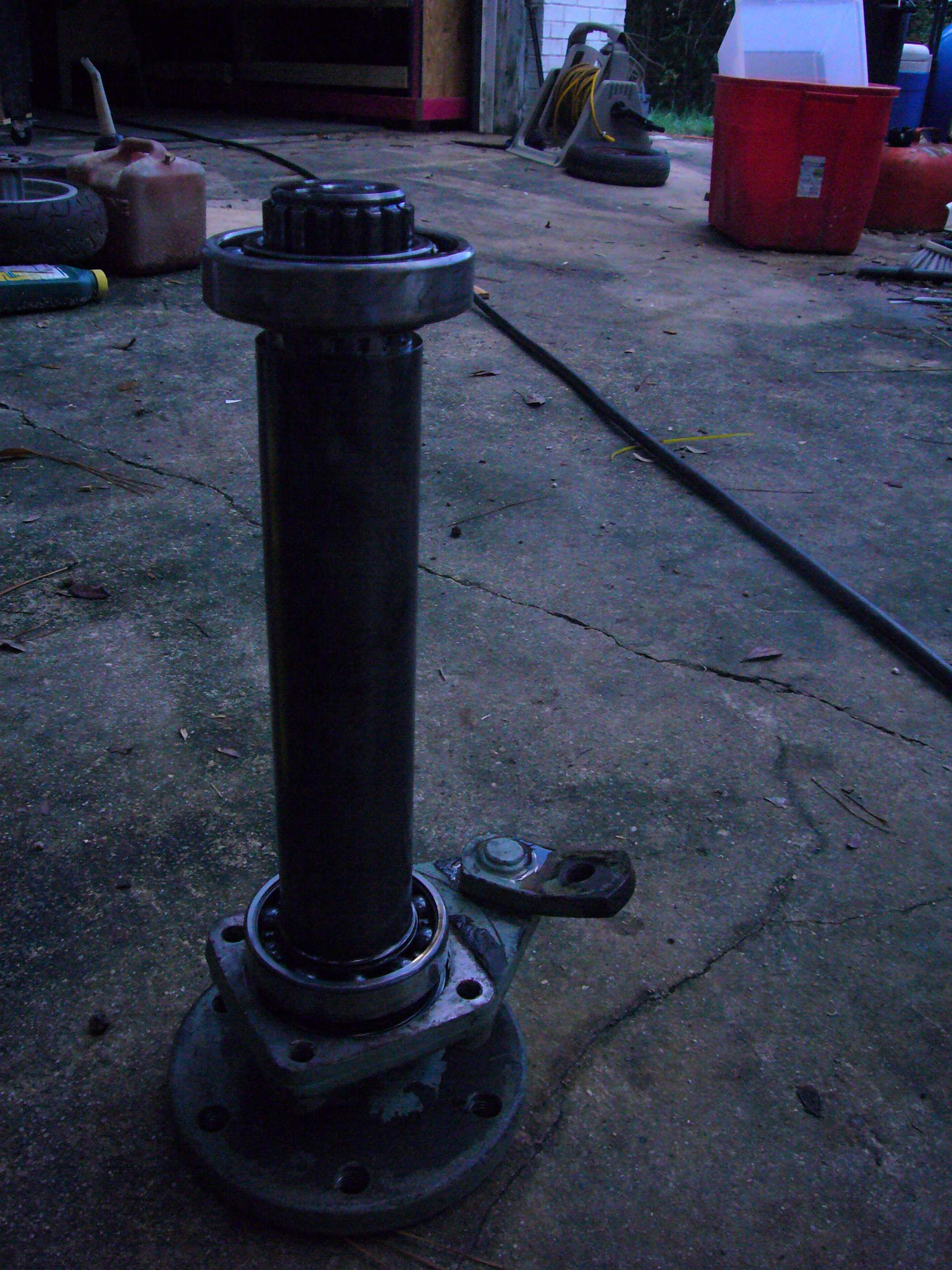

well, not quite as bad as i thought. Could have used some advice, and my thanks to "buck" @eccequipment. for the help in responding to a call from the wilderness. I took his advice and easily carefully pryed the rear pto plate off, detached 3 items. 1. spline collar 2. Pins, washer, cotterpins.(#2). After the removal of these 3 items the whole pto came out as one unit. 3 bolts on the end of shaft removed and tried to pull entire axle housing and axle at one time, wish i would have known that the brake drum had to be removed 1st. The axle easily came out of the housing, but the Inner bearing and spacer would not come thru the housing or go back into the differential housing, causing me to have to remove the axle housing to get to the bearing. Here are the pictures, so no one has to go thru this with0ut some pictures.

Well, finally got it all back together. Some words of warning that might save some time for someone else. I replaced all the seals on the rear axles, pretty straight forward. I reinstalled the "wear" rings that the seals ride on. To remove these units I used a very sharp cold chisel and taped them free from the axle shafts. I replaced these rings and had to drive them on to the axle using the "pipe" like spacers to tap them into place, inserted the O-rings and used the same method to drive on the bearing and spacer ring. Had to have these spacers made locally as they are no longer available. 60X50X5 mm
Before driving on the 2nd inner bearings I used the Pipe spacers to drive on the rings, bearings and spacers on the second axle. These axles were then inserted into the axle housings before the inner bearings and spacers were installed. The axles and housings were then inserted into the housing and a second pair of hands were needed to align the large drive gears on to the shafts. The retainer bolts were inserted and tightened, both sides.
Now the worse part of the entire repair is hooking up the PTO linkages. When installing the PTO and plate as one unit, *****be sure to attach the pins, washers, and cotter pins on the lower outside linkage first, this should be done before the entire pto unit is inserted. The pins go into the linkages from the center to the outside with the cotter keys facing out. This allows the pins not to interfer with each other. I got pretty good at doing this as I dropped the washer, cotter pins too many times and had to remove the pto again as I couldn't see the items from above. What a pain!!!!!!! The center spline union has to be aligned to completely insert the pto. After that just put everything back together. I am waiting for about 24 hours for the "form a gasket" to cure before adding oil to transmission case. Then just check for leaks....... time apart, about 2 hours with power tools. Part replacement about 45 min. installing axle and housings about 20 min. PTO hook up and install, 5 attempts, 2hours. 1 hour for reassembly, brakes , tires, fenders, 3pt parts.
