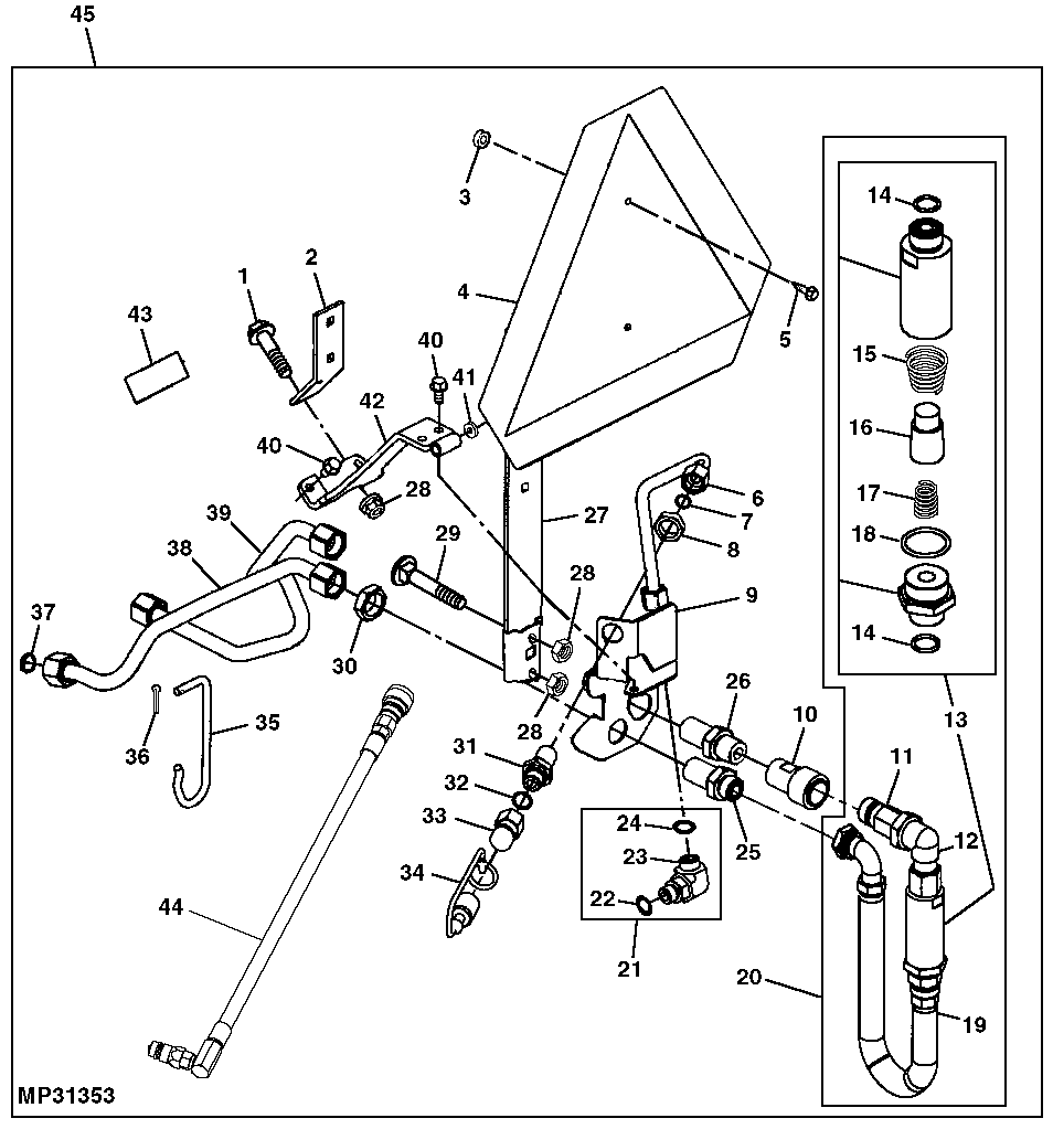

I am currently powering the splitter through the power beyond but of course when I do this I lose my 3ph & is nice to drop the splitter for the big pieces which I currently don't have the option to do.
There a solution for this...you must have the original PB kit. The newer version of the kit provides 2 returns, 1 like you have that bypasses the 3PH and goes directly to the tank, and another on that goes into the 3PH to allow it to work.
If you look in JDParts, you will see the "old" and "new" kit listed. Below is a picture of the "new" setup.
