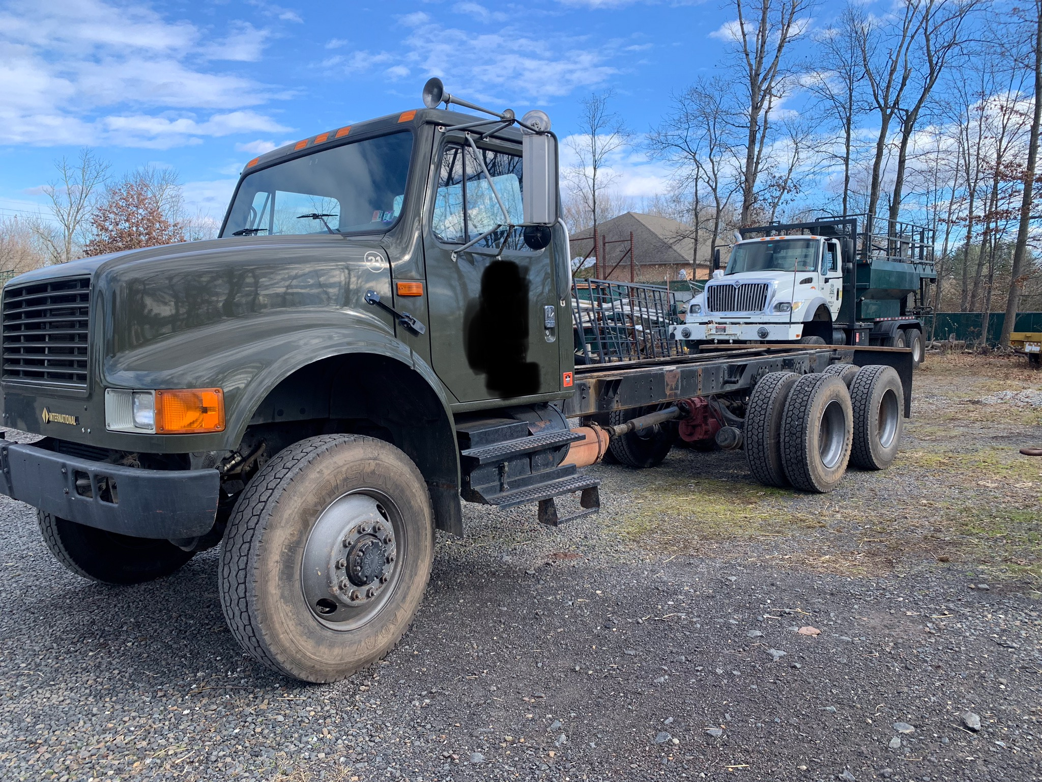

Went to see & drive truck today. Other than 6x6, automatic and aftermarket AC, it’s very basic.
But everything works and it’s in good condition.
Rear axles have Detroit lockers
It was used by the Seabees on a Navy base in Florida, then brought up north 15 years ago. Not used in winter.
Well that's certainly different than your first truck pic in your first post. I guess I missed the part where you're looking at this one now.
This one may well do what you're looking for more efficiently then the army truck.

The tires may be ok, depending on how severe the off road conditions are. The rest seems minor. The no parking pawl on the A/T is actually a good thing. Way too easy to break off a parking pawl with a load on it. All of our medium duty wreckers were set up with no park on the trans, but either air brakes (and the air brake "park" if you will) or there was a separate park brake on the driveline. I would prefer using the air brakes for "park" myself. I'm guessing it's air brakes on this truck?
Engine exhaust brake can be added more than likely, but yeah, that's not going to be cheap.

Air brakes
S Cams on back
Wedge up front

On the IH, I would ask the current owner how the tires perform in the field. From the pic, it would seem to me that they would mud up? Does it have dual brake chambers to provide the emergency brakes? If so, as long as the brakes are properly adjusted, you won't have to worry about a parking pawl. I have only driven a few auto's, none had a pawl. Nothing wrong with a used body that a little paint and maybe a little welding cannot fix. Good luck with your search.
