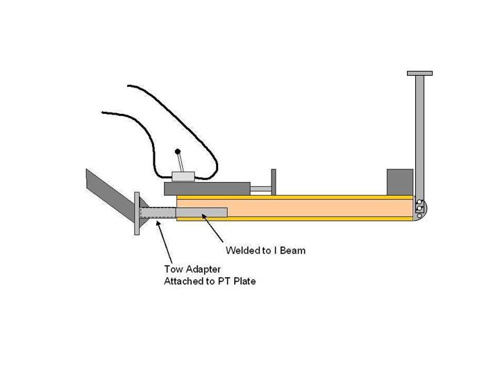

I thought about buying that splitter too. I was going to weld a 2" square tube to it and remove the 3pt hitch assembly. I would mount it to a receiver plate that I welded up in class.
This would also allow me to rotate the splitter 180 degrees to pick up logs and split them.
I finished the mounting plate, but have not taken the second class yet. That will come over the next two months.

Here's what I was thinking of doing with the Northern splitter, or one that I would build myself.

You may want to put a foot on it to relieve some pressure and as a safegaurd for when you are not sitting on the tractor when using the splitter in the "traditional" position. Never know when someone will bump the joystick and drop it on someone's foot. /forums/images/graemlins/shocked.gif
   / Ready to but woodsplitter; a few questions #6
I think the foot/support would be a good safety precaution/forums/images/graemlins/cool.gif, but with my luck I would have my foot under the splitter foot when someone hit the joystick. /forums/images/graemlins/frown.gif
   / Ready to but woodsplitter; a few questions #7
Actually, that's a pretty good idea. The foot could be on a pivot and able to swing 180 degrees and lock. This way if the splitter is upright or upside down, it can still act as a support. It could also be removable for those times when you are only working from the tractor and are picking up logs to split.

I have used one of these 3pt splitters for several years now. I really like the stand design that takes all the weight off the tractor.
#9
That's a nice idea!
It would work great. How hard was it to fab that up?
   / Ready to but woodsplitter; a few questions #10
Really not hard at all, did it an a few hours. My intent was to have something that would work with attachment slike the wood splitter.
