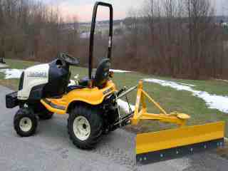

Yes I am. I use this 6' blade to clear 500' of driveway.

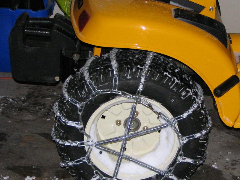

Bob55 - Great pics- I have the same set-up. Works fantastic. Didn't miss a beat with the 10 inches we got last week. Two questions though - when the lift bar is used to raise the housing, how far down the fender does the handle go. Mine is almost to the foot rest and hits the fender. Second, my chains fall off constantly. I think they are too large (I got them from the dealer). I have overlapped two cross chains. Not nearly as "neat" as yours. Any trick? Did you cut the chain to size?

Welcome.... Ya the lift bar does go down low (see pic) I think I'm going to put some thing on the fender to keep the lift bar from hitting and scratching the fender. The chains were fitted on the wheels at the dealer. You can cut them so they fit tighter. I also put springs on the out side to hold them tighter. I picked them up at Home Depot. The ones I bought are a little long but they work. Keep in touch. This is a great board for info. /forums/images/graemlins/grin.gif

Let me try the pic again.

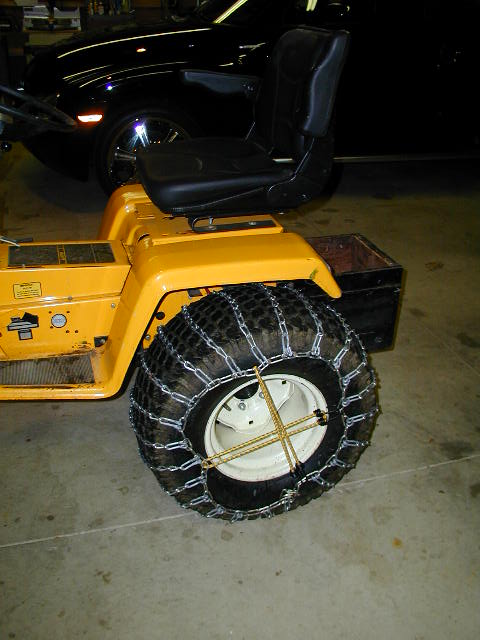

MDC,
This might help with your chains. Mine seemed sloppy enough I was afraid when I was haulin butt to get back to the garage, they were going to catch the fender on something else in the wheelwell.
So... I strapped two bungee cords on the outside of each wheel, just ran them through the chains pulled them tight and hooked them to the other side of the wheel.
Check the picture.
It seems to be workin fine
Curt

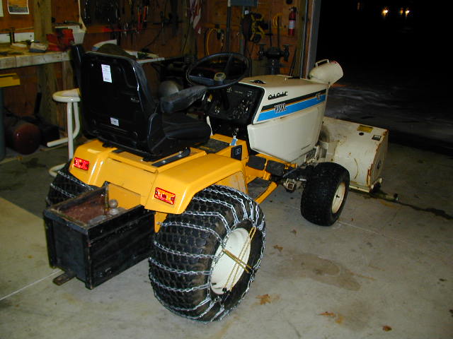

Hey Bob,
We posted our "Chain keepers" simultaneously, it must be that great minds thinking alike syndrome.
Nice Cub!
Here's another pic of the trusty 1872
Curt
