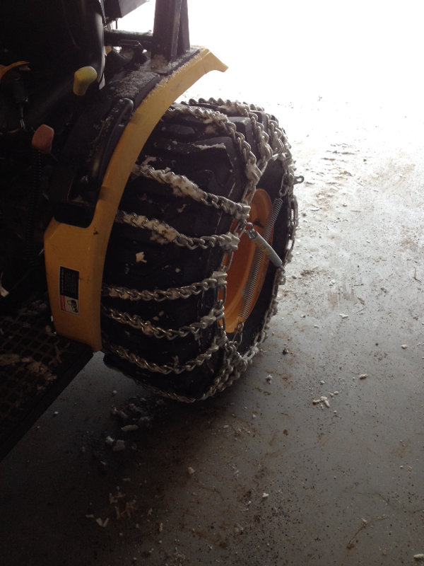

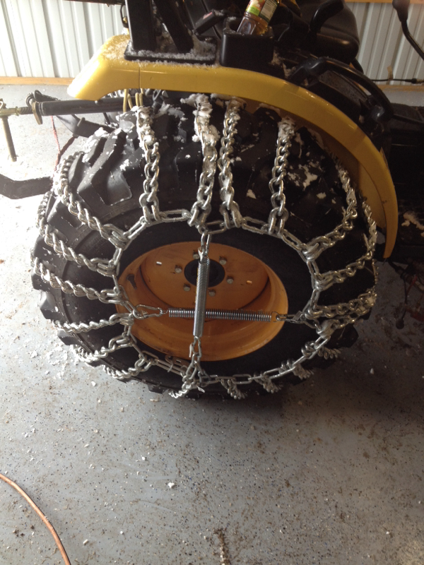

We got about 4 inches of snow a week ago so I got to test it out. I didn't have chains yet. Needless to say it was a bad experience. I had no traction and was having trouble just driving around up a incline without the plow down!! So next I put on a set of rear forks and hooked on to a 800# round bale of hay. Surly with all that weight I would have traction now. Nope I could hardly even tell a difference. Went inside and ordered a set of 2 link ladder chains from tirechains.com with 3/8ths cross links. They came today and WOW!! I knew it would be a big difference but it is day and night. I didn't even have any weight on back and I could push piles of snow no problem. My last tractor (sc2400) had chains too but I never tried it without them.

Good to know, I figured the weight alone would of done the trick.

Here are a couple pics of the new chains.

Re your traction issues, unfortunately that's what I've heard about R4s without chains. Sort of related to that, this is my favorite Kubota video.
