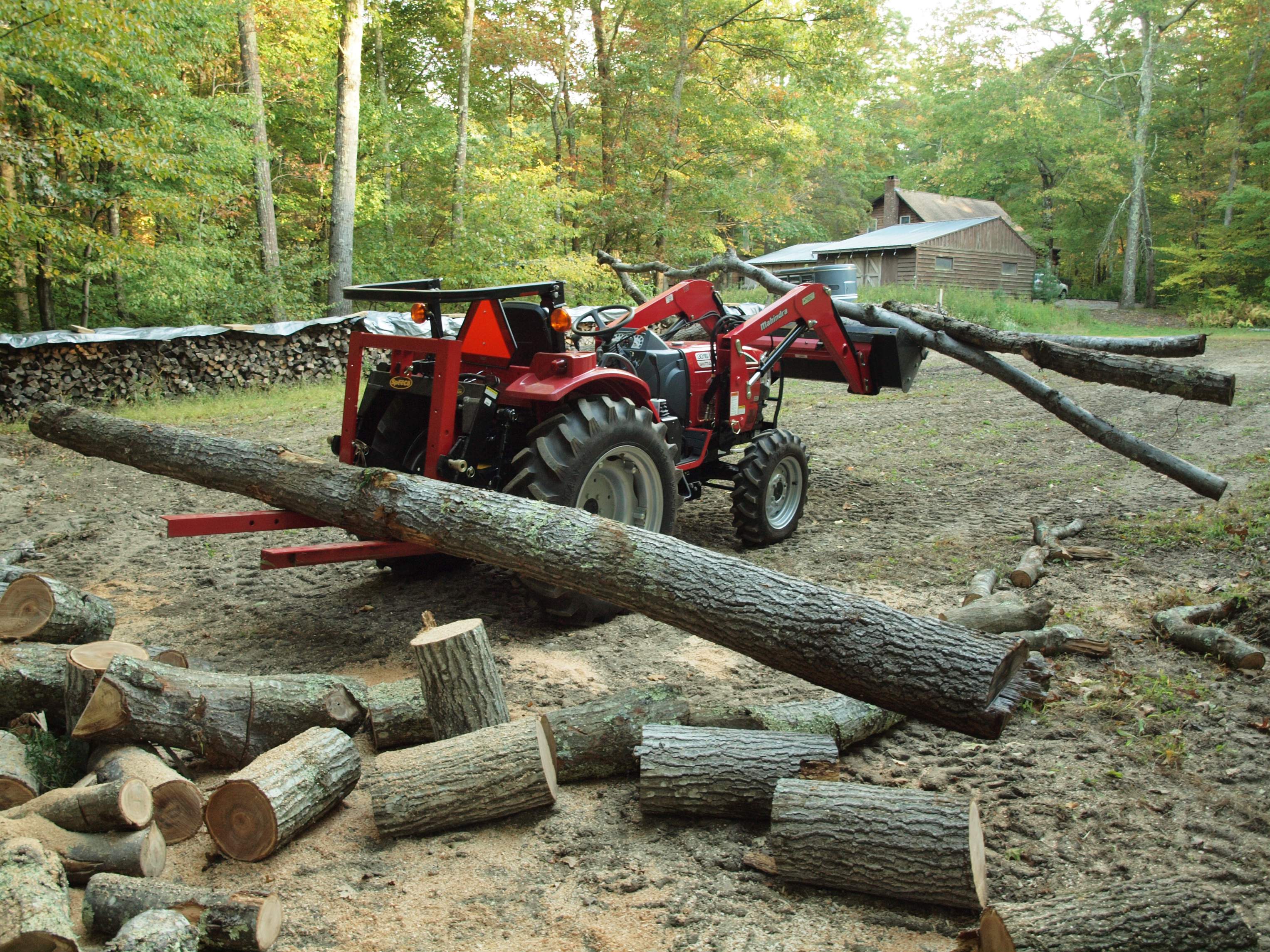

The front axle on a tractor is usually rated just about twice what the fel capacity is. The problem arises when the tractor is traveling as motion brings in a whole bunch of other stresses that can surpass axle rating with a heavy weight on the fel especially if the weight is beyond bucket width. This is why when I want to move something the fel can indeed pick up , I do like the pic shows.

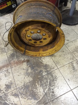

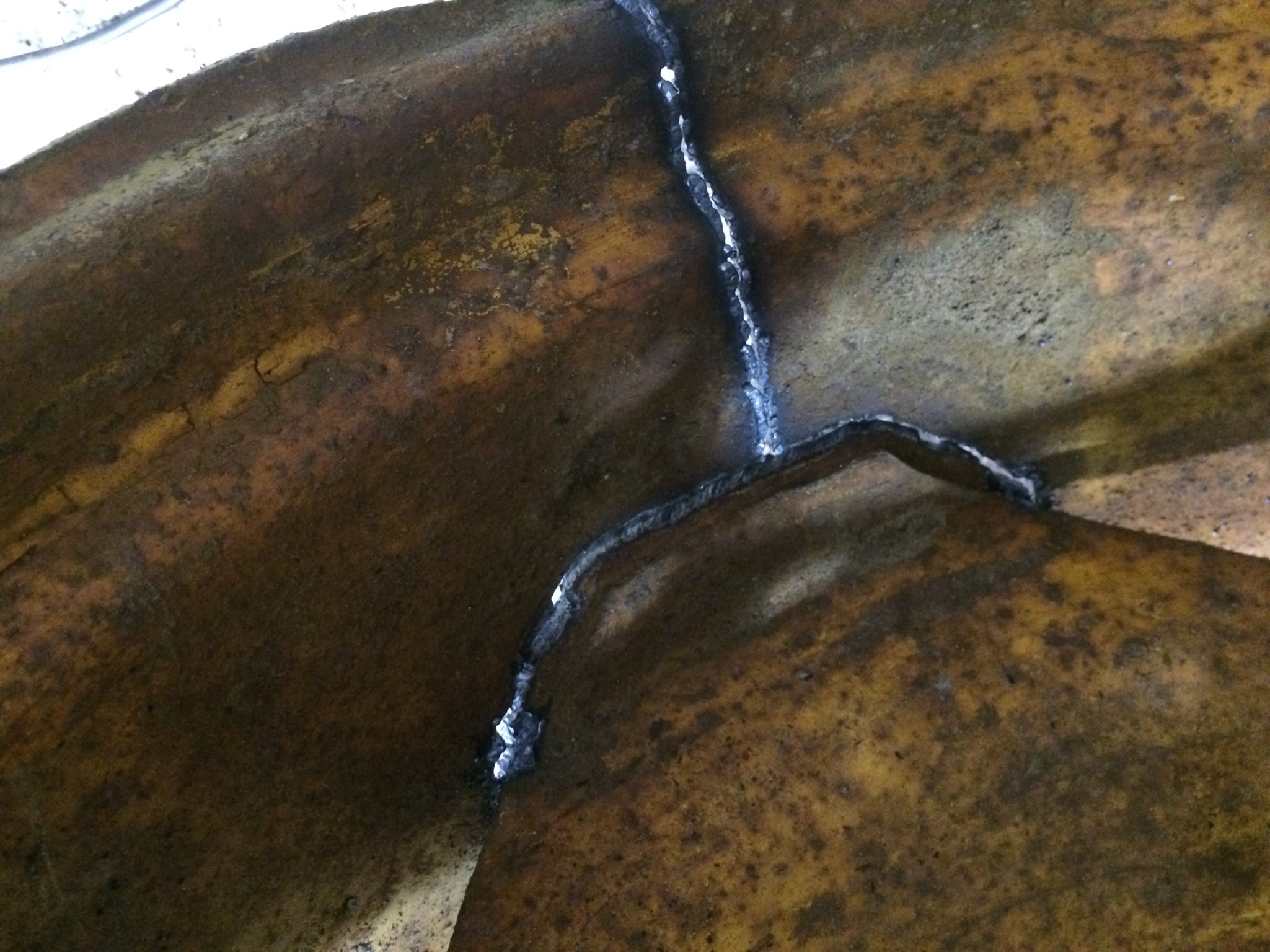

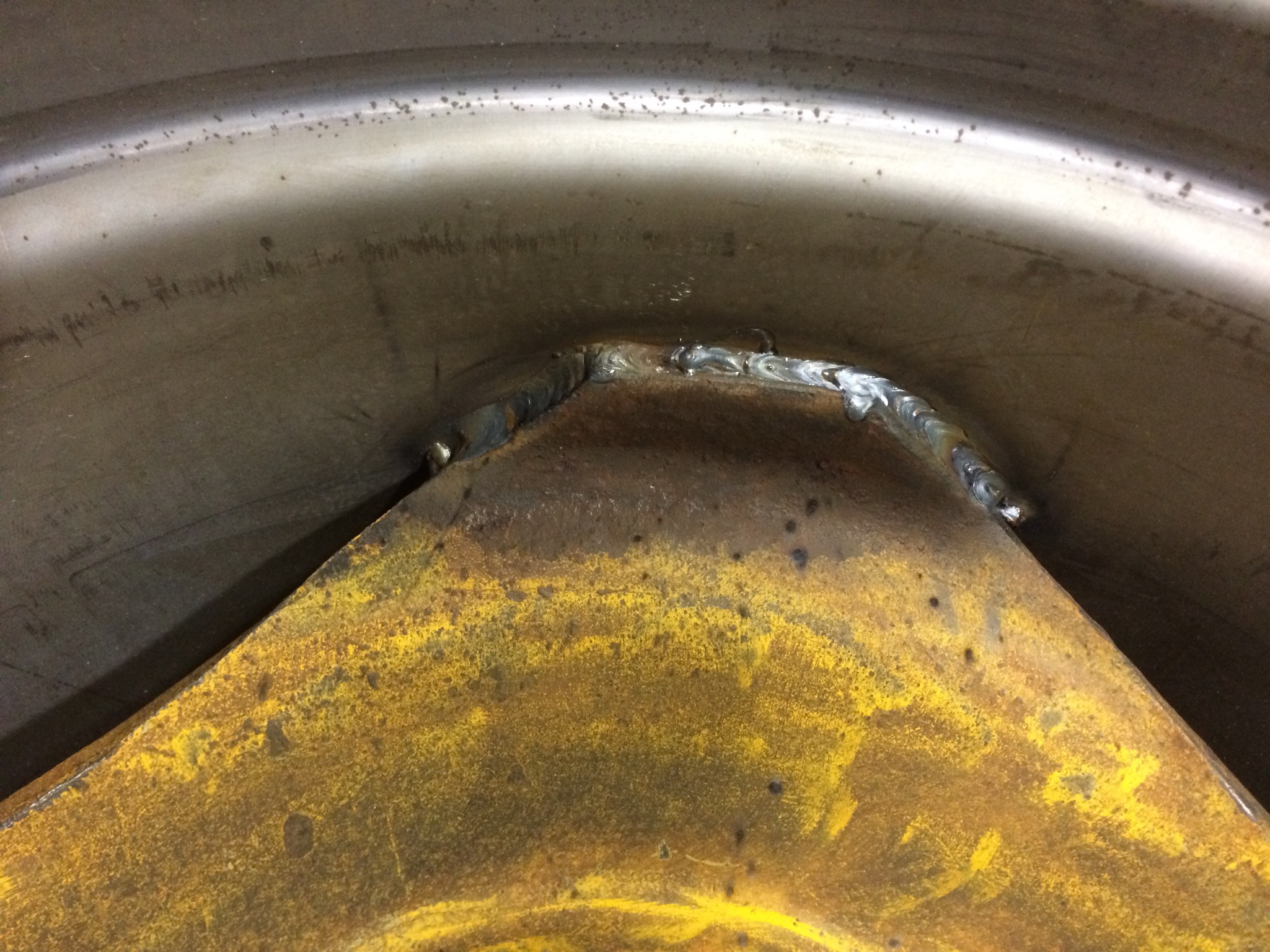

Adding weight to the rear tires or rear wheel weights does not add weight to the front axle unless you were driving around with the rear tires off the ground before adding the weight.

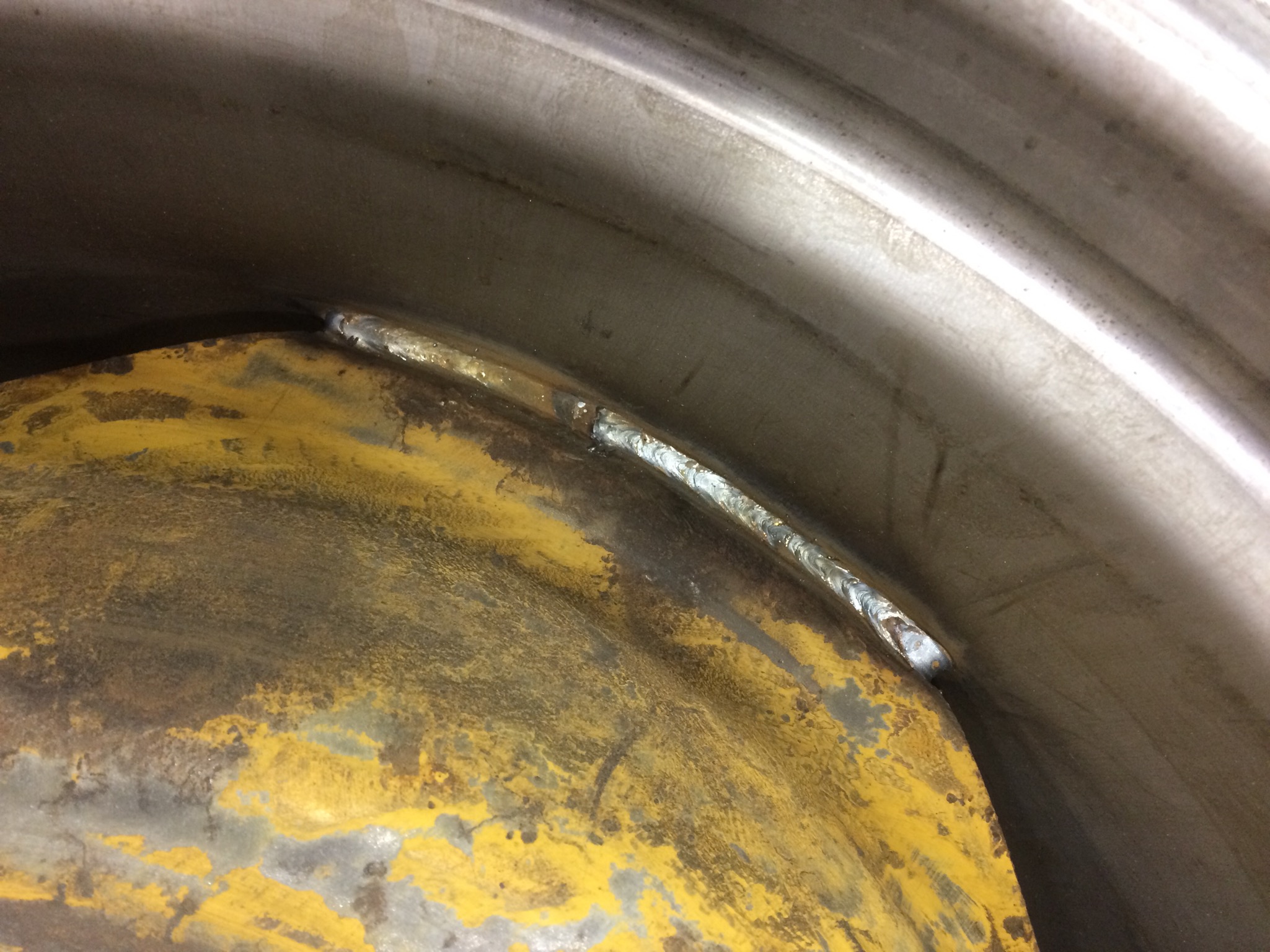

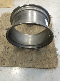

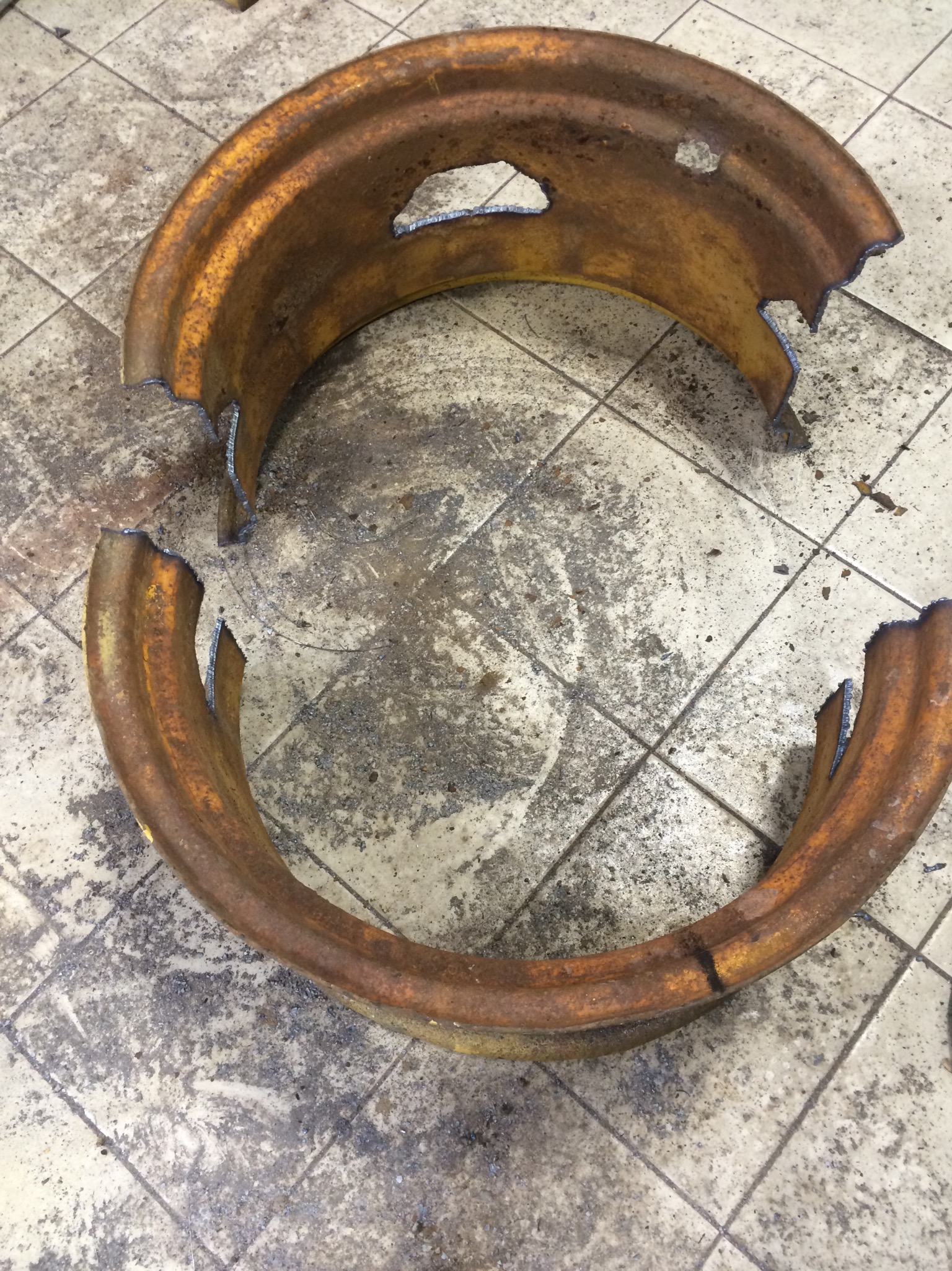

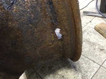

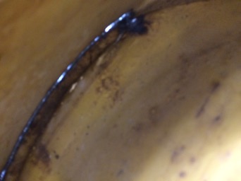

Here is what salt water can do for you.
That's why you need good tubes, and when /if you get a leak, you was the rims and retune. Intact paint helps too.
Paint dont rust and neither does rubber.
Poor maint routines lead to rusted out rims.
