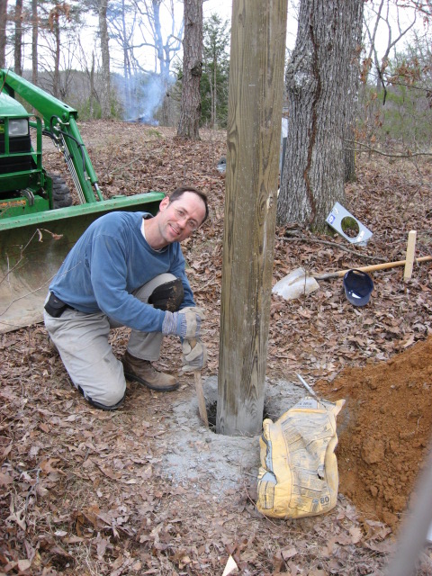

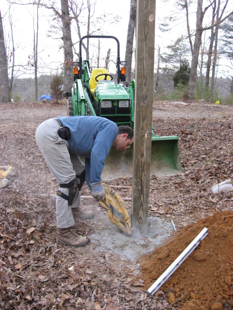

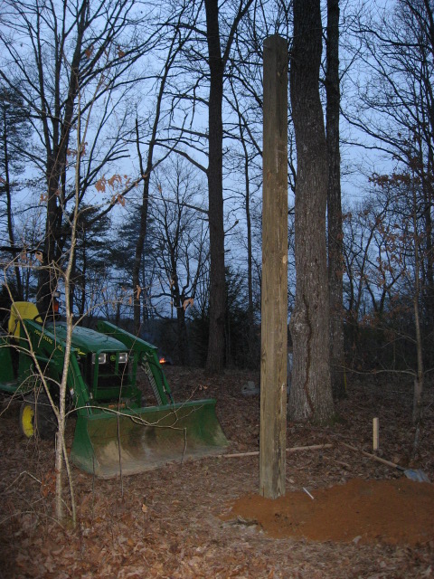

After using all the Quikcrete, I tamped dirt into the top half of the hole. Here's the bar pole standing. I was very satisfied in knowing that this pole was set correctly and should last a good long while.
In the background you can see our fire burning. We are constantly burning on the weekends. We have a lot of tree debris that was left on the property before we bought it by some nice folks who ran a tree cutting service without the permission of the owner.

I've got to run for now. I have pictures of re-assembling the electrical panels and will post them soon.

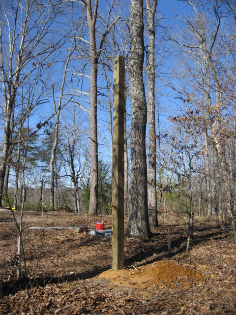

So here's the bare pole in the daylight a week later. I put a level on it and it was standing perfectly straight. I've also included a picture of the parts waiting to be re-assembled.

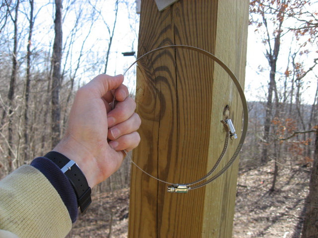

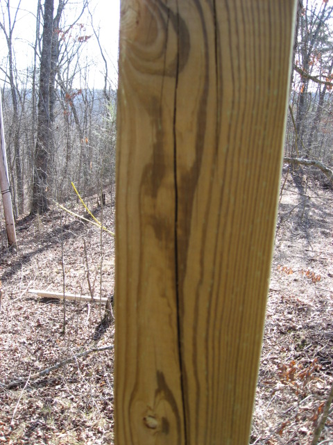

The eye-bolt running through the top of the pole seems to be causing a crack to form. The bolt is probably a little too close to the end of the pole.
/ Re-setting Electric Pole & Panel Pictures
#39
I decided to jury-rig the pole with some large hose clamps to help prevent the crack from growing.
