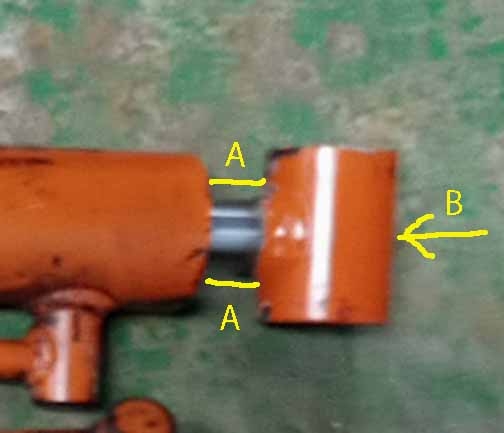

The wire is always stuck in there, so the first thing to do it to free up the gland by pushing it in just a bit.
I use 2 small pieces of steel (A) that will act on the gland, but stay inside the inner diameter of the cylinder barrel. Then I whack gently at B.

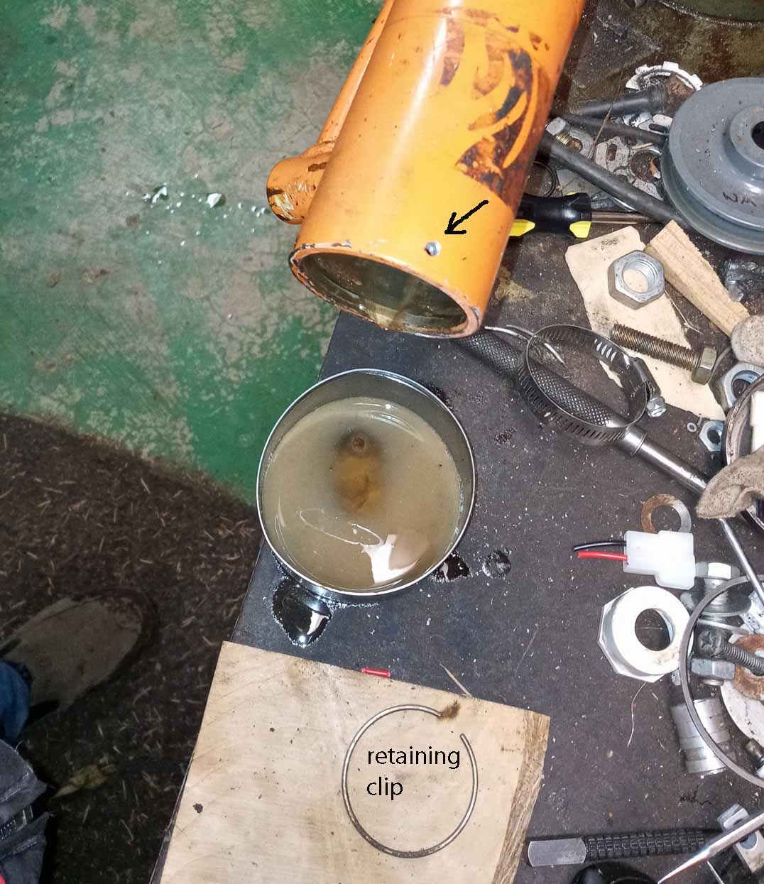

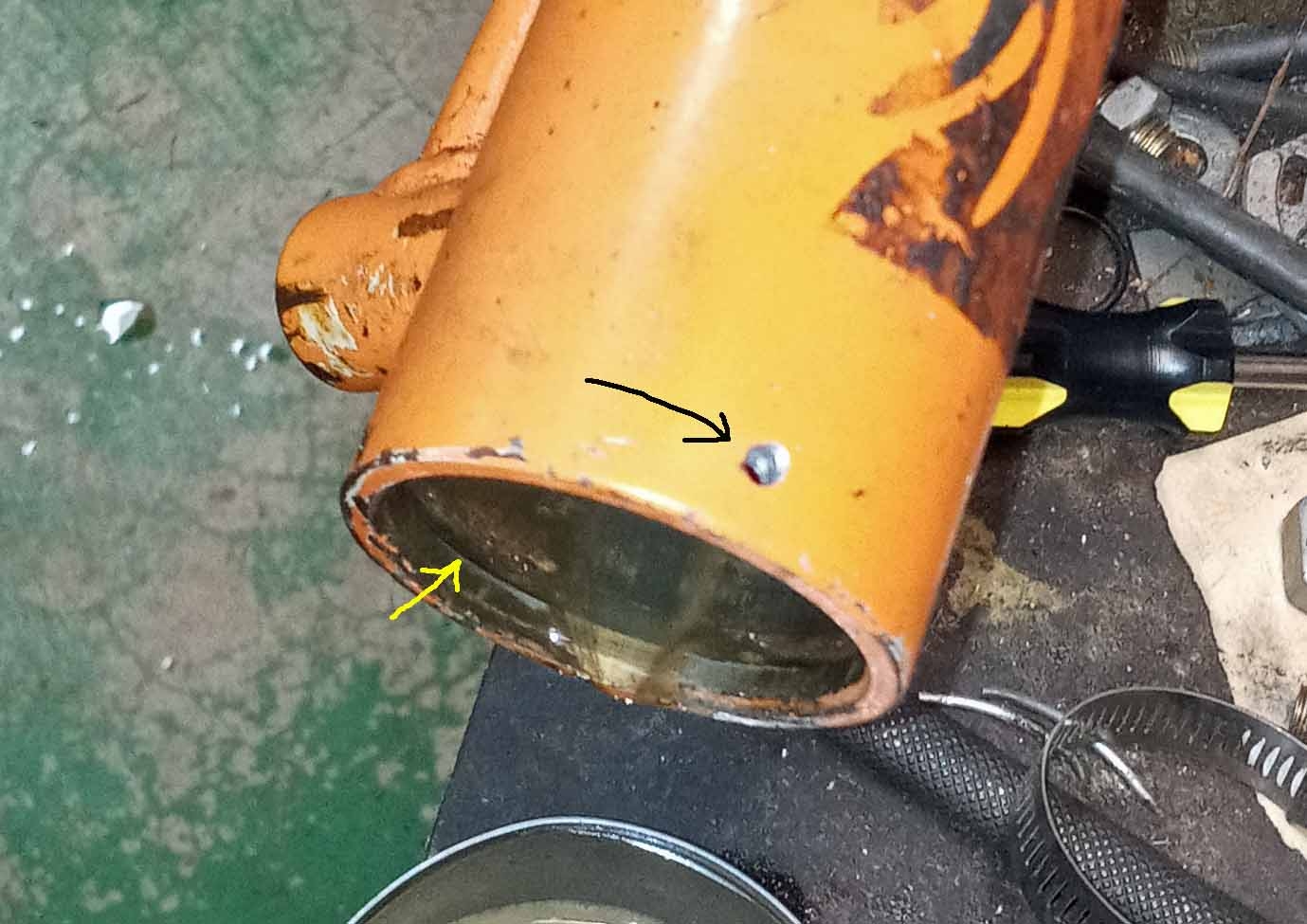

Once the springy wire is freed up, how do you get it out? I am not able get a small screwdriver or any of my dental-style picking tools underneath the wire.
So, I drilled a little hole and pushed it out. Anyone else have a solution they have used?

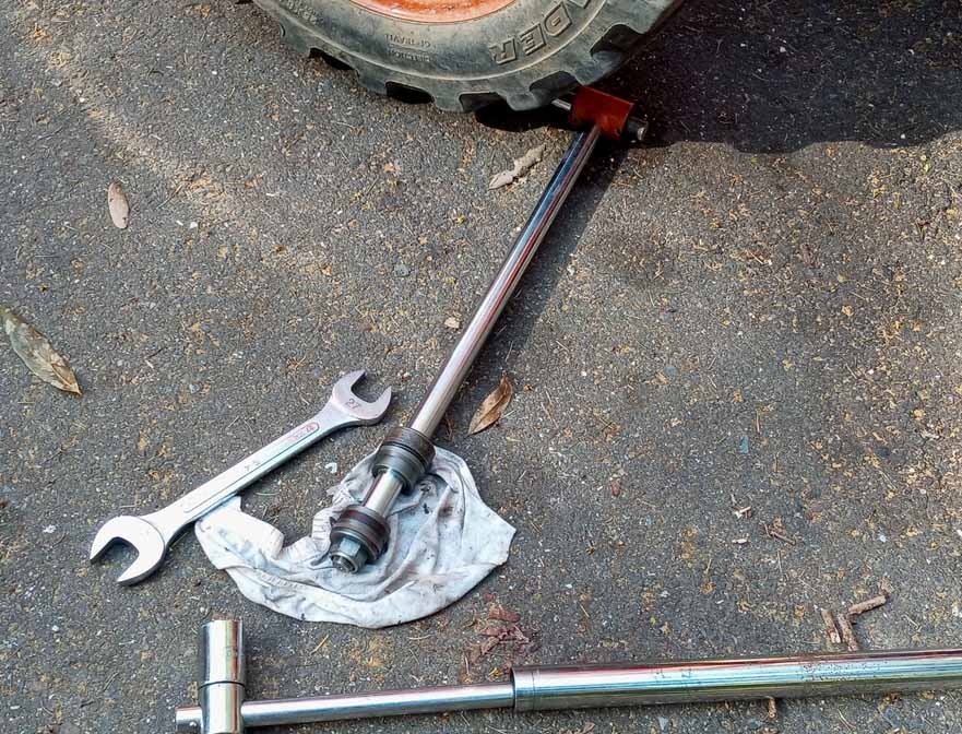

Next, I remove the piston nut.
Since it takes at least 300 ft-lbs of torque, I stick a rod in the cross-tube, park the tractor on it, then use a long breaker bar.

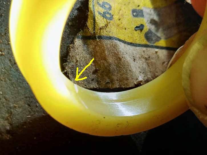

Here is the gland.
Only the wiper (A) and the gland seal (B) needed replacement. The rub-ring (C) seems to be metal, made of plain bearing type material.
Kubota actually still sells a seal kit for this cylinder, but it is listed at $175, or about $200 with tax and shipping! Crazy.
So I just bought A and B, plus the piston seal for $25/cylinder from Hercules.

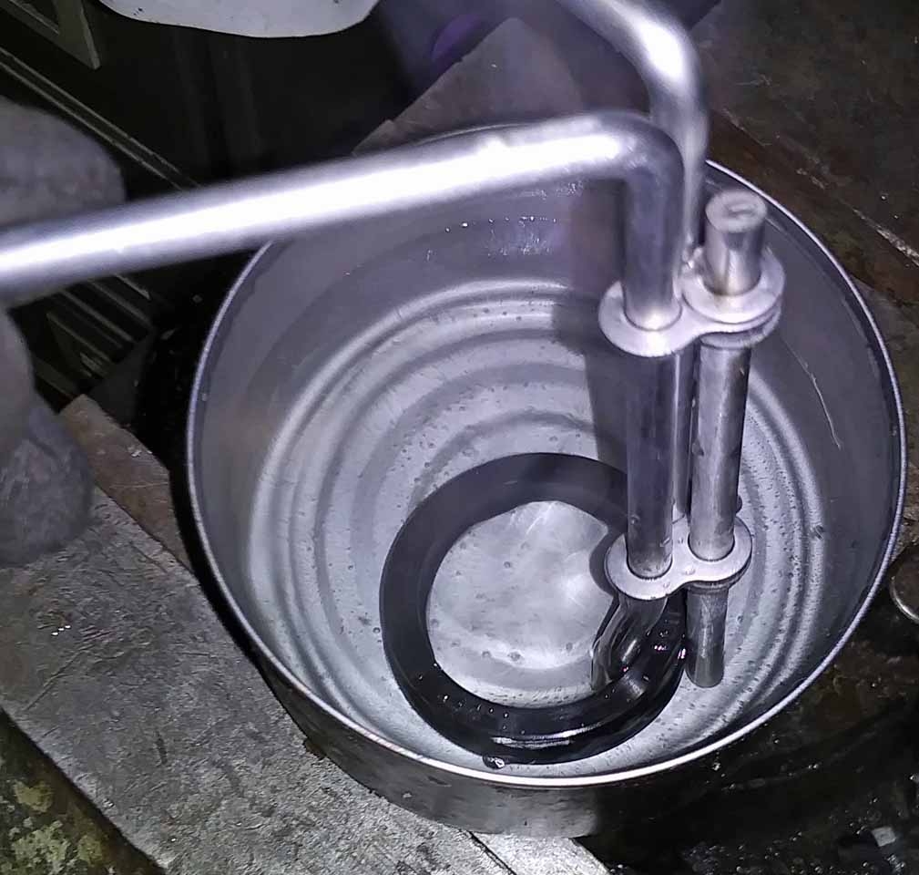

For the piston seal, I like to heat it and the piston in hot water before sliding it on. I then clamp it overnight with a hose clamp to assist in assembly.
