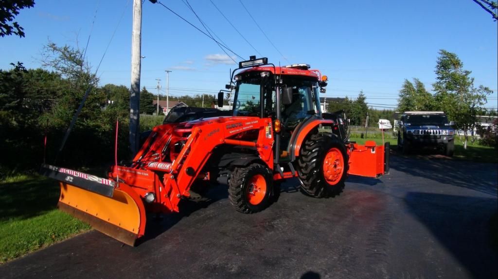

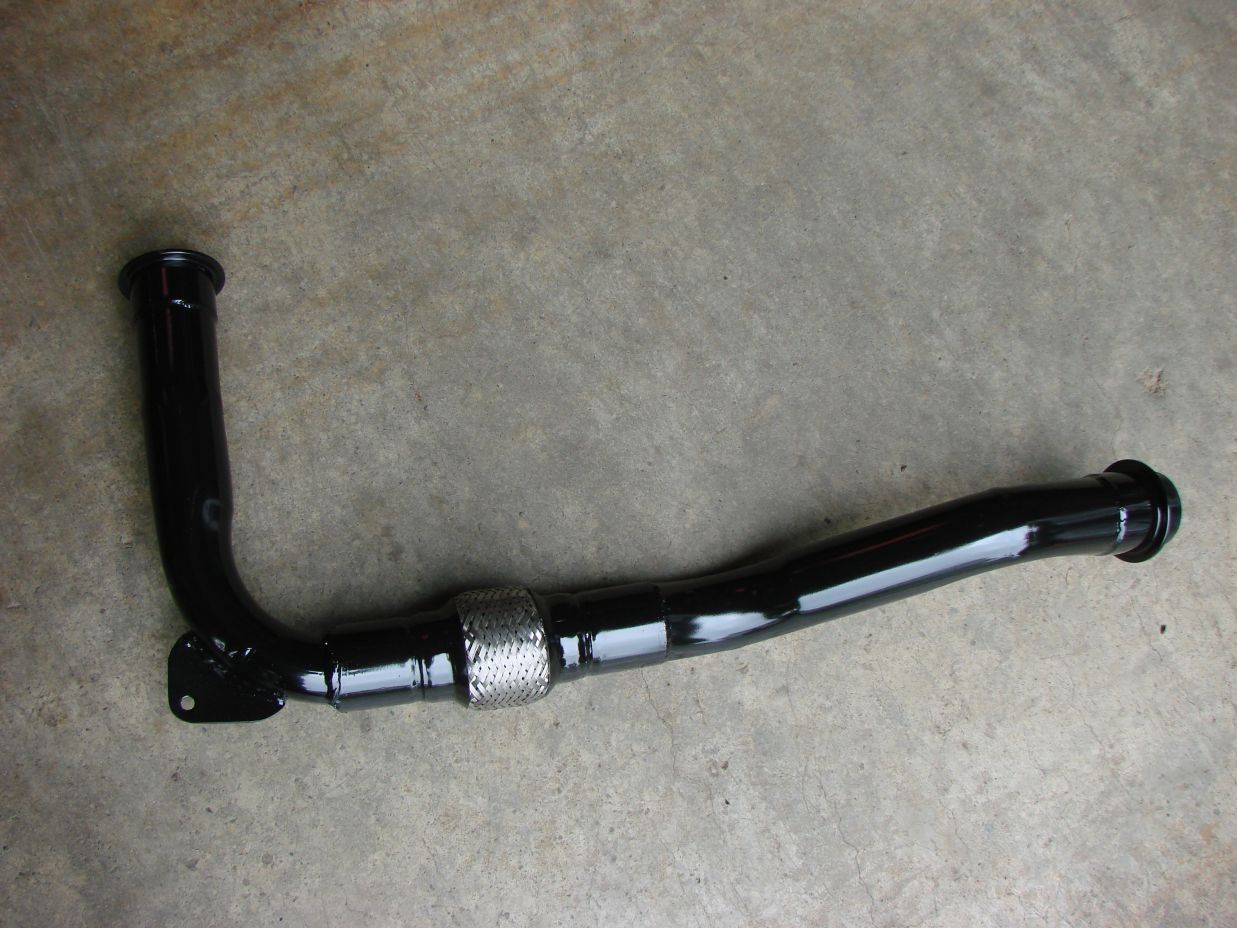

There's been a few of us who took the plunge and attempted to rectify the issue. I did mine two years ago and glad that I did. It's on a Kubota 5740. I used a few stainless flanges on the exhaust exhaust along with one flex pipe and a 3" stack. I fabricated a mounting box that traps any water that gets in the stack and let's it out on the bottom via a drain hose. Here's a few photos of how I did it.
   / Re-routing diesel exhaust system #3
Great looking tractor and mod..... Did you eliminate the muffler?
Thank you. No, the muffler is still there. I also made a few heat shields to protect the AC line close to the muffler but I don't think it was needed due to all the cooling coming from the fan but it was a fun project. :thumbsup:

Thanks, the mounting box was built to add stability to the 3" stack plus act as a catch basin to any water that might get into the pipe. It's been flawless since it's been put there.
