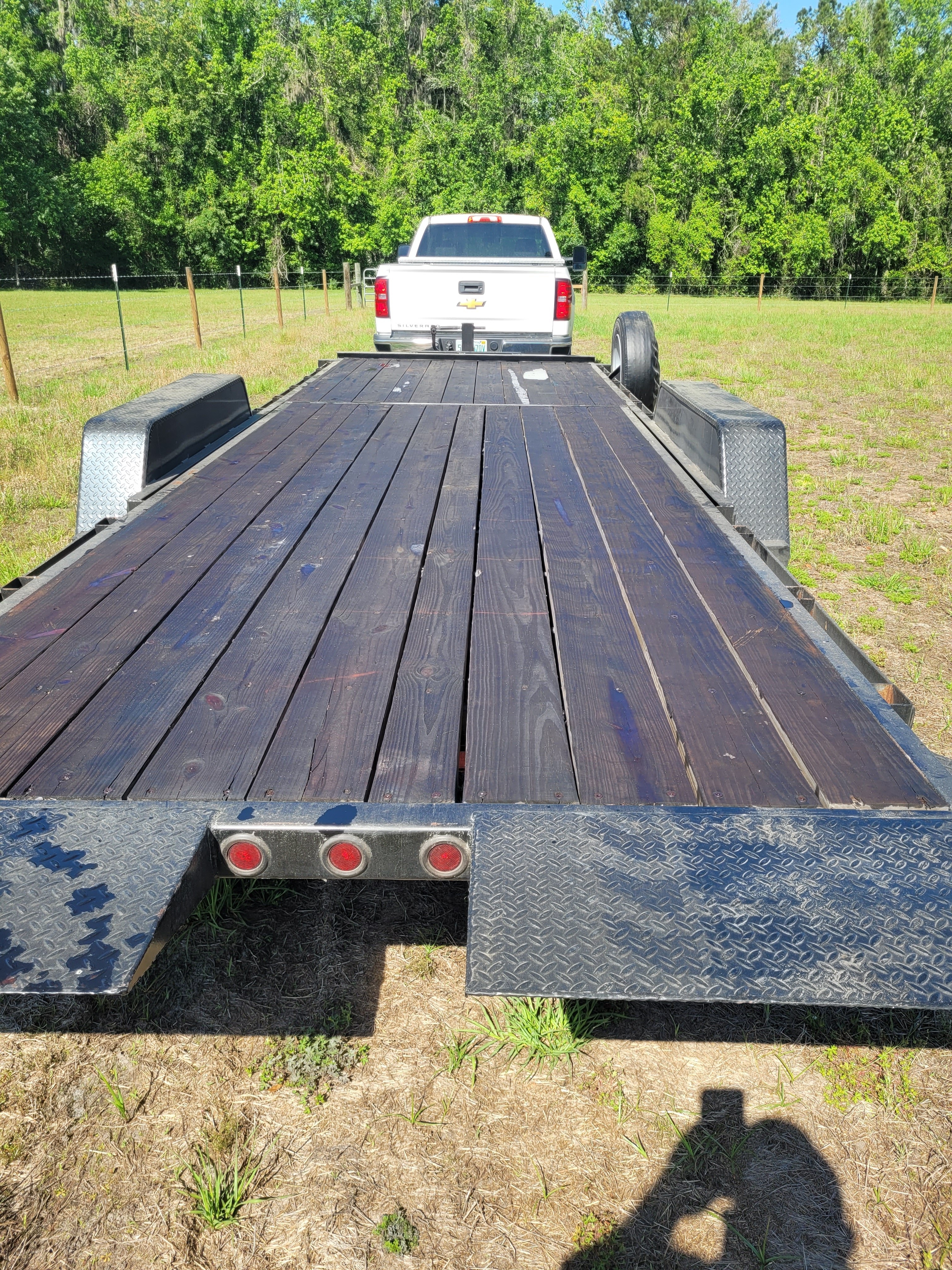

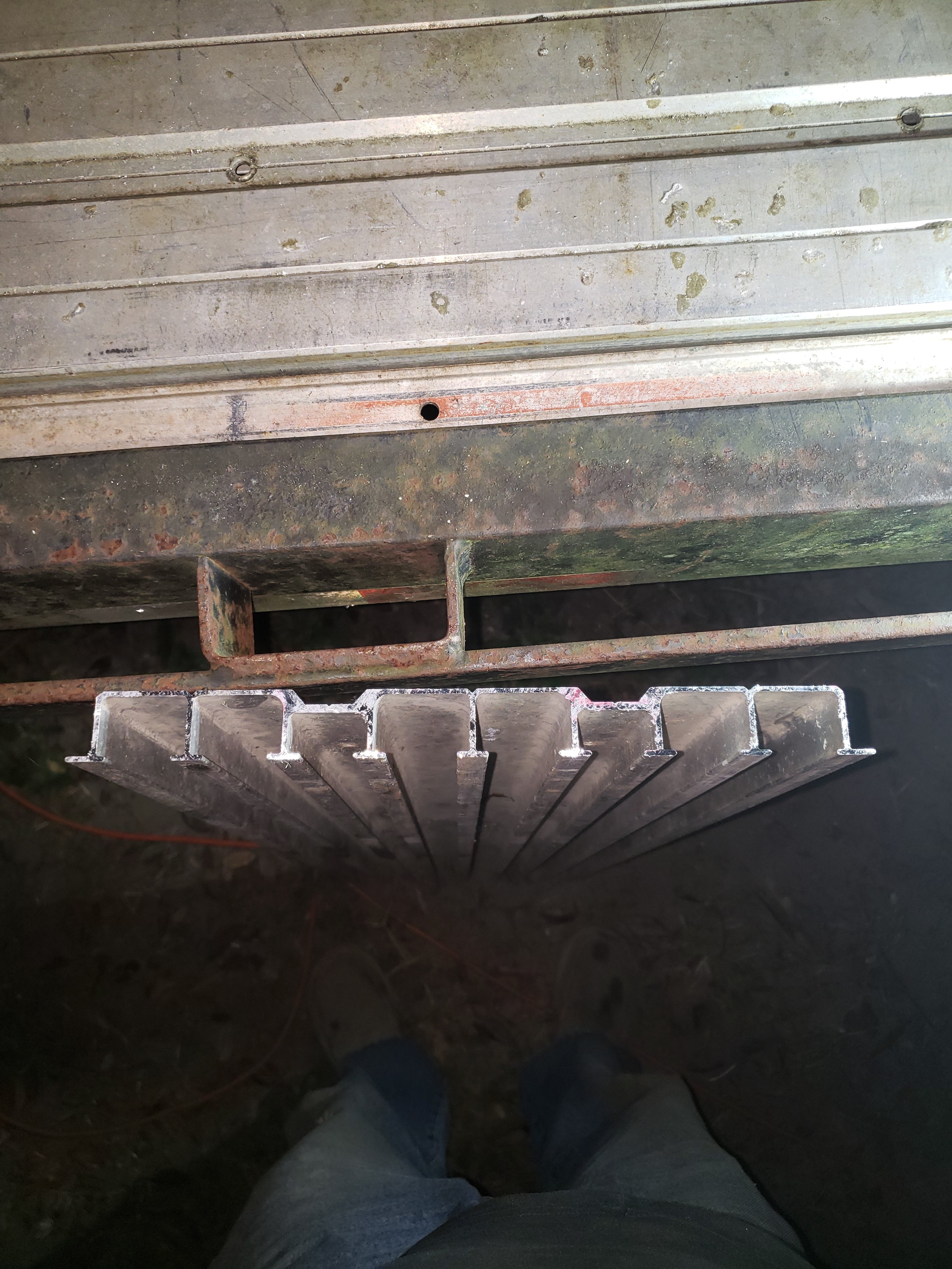

What are we looking at there? Looks like aluminum. But what is it? And is it a readily available product? This is a timely post as I need to redeck my 16'er.
I am about 99% sure that that is aluminum decking off of a flatbed semi trailer, at least that is what I took it to be.
   / Re-decking Gooseneck Trailer #22
You are correct!
Somewhere I had mentioned it before, a couple years ago when I first decked it out.
Years ago I bought a 40 ft flatbed to deck out a trailer I built. Buyer got in a hurry, so I decked it with bar grading. Later I got paid to change it out with the aluminum. Didn't use all of it, and negotiated with a shop owner to buy his drops until I had enough.
It works well for my use, and is probably stronger than most wood floors. Will probably outlast them also.
The trailer shop was in McDonough, GA.
David from jax

Cross section of what the aluminum flooring that i put on my trailer looks like.
David from jax

That's not going to èver trouble you again. 👍
Since my Big Tex sits out in the weather all year long, and seldom even gets used, I figured if I didn't do something serious, every time I wanted to use the trailer I would have to fix the floor.
With no more home time than I get, when I start to do a project, I end up getting side tracked because something I need has sat around and now needs repair. So...I am learning to fix things "long term" when I can.
David from jax
