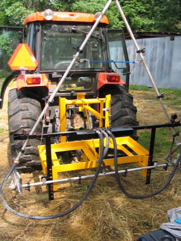

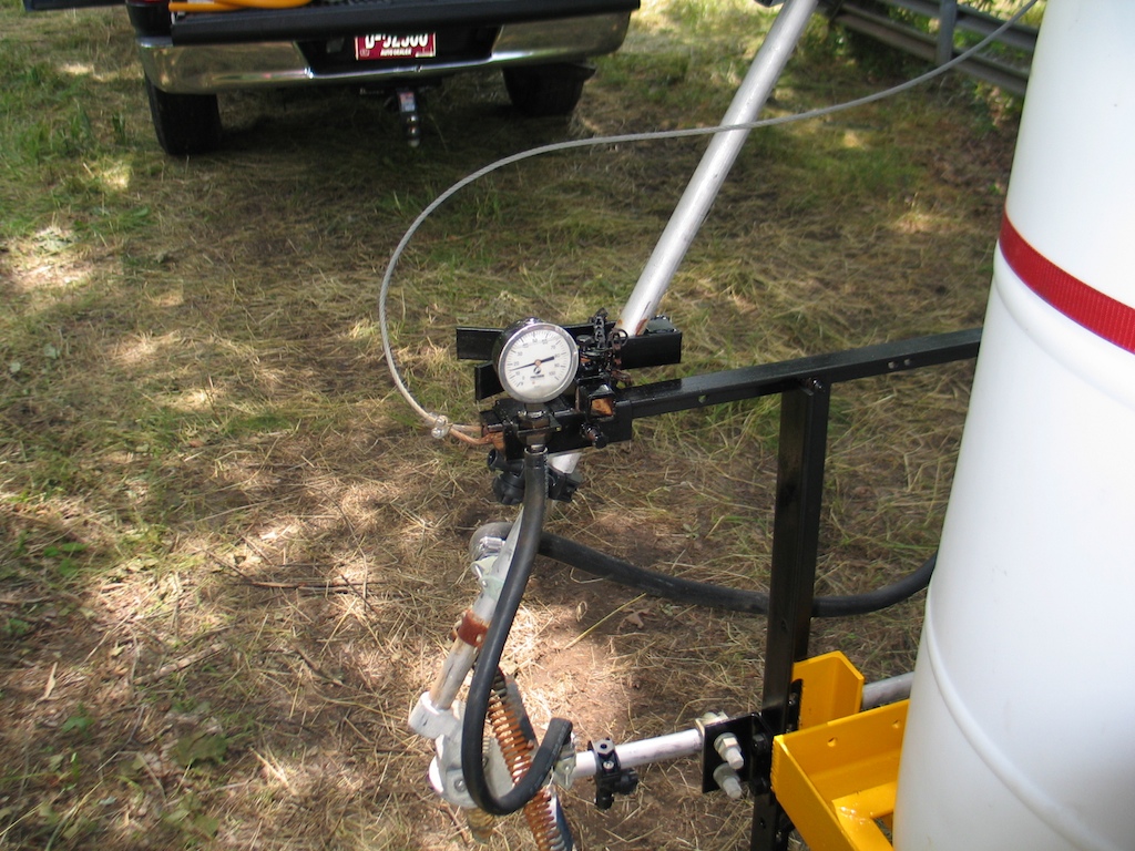

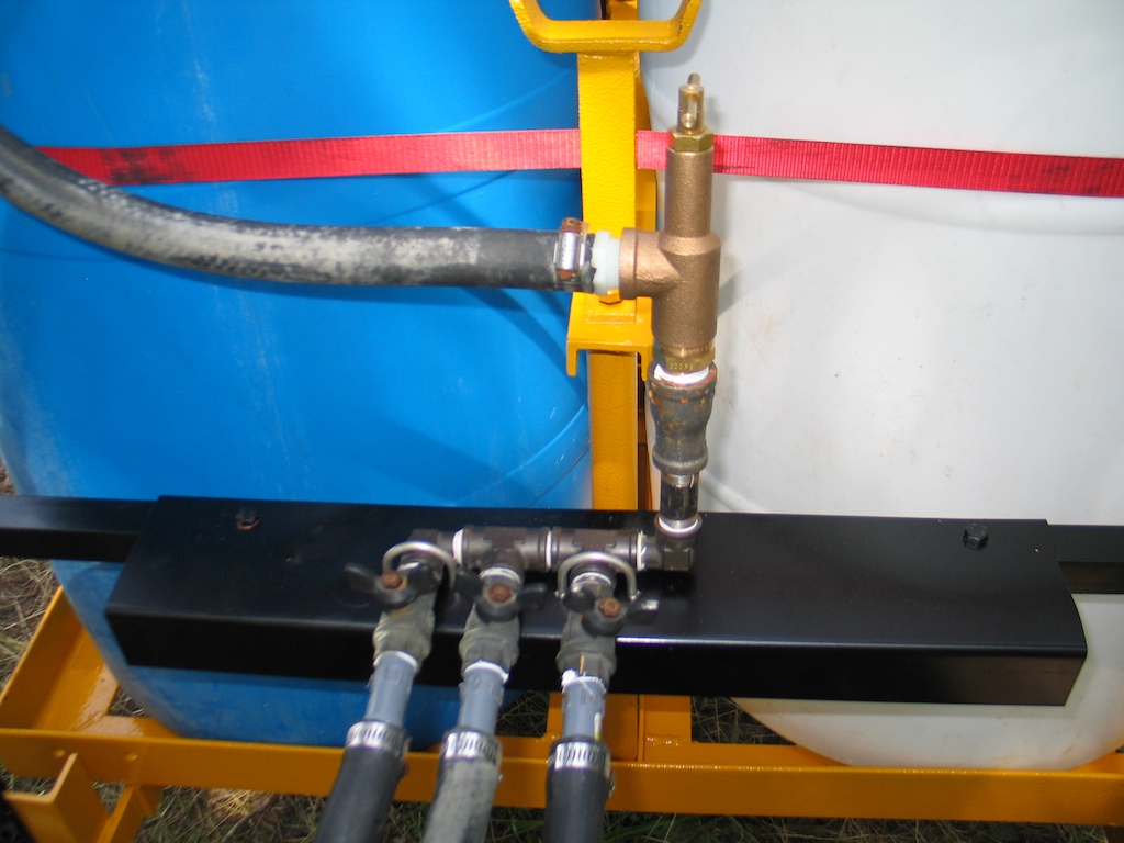

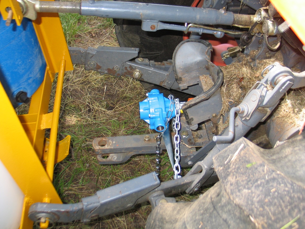

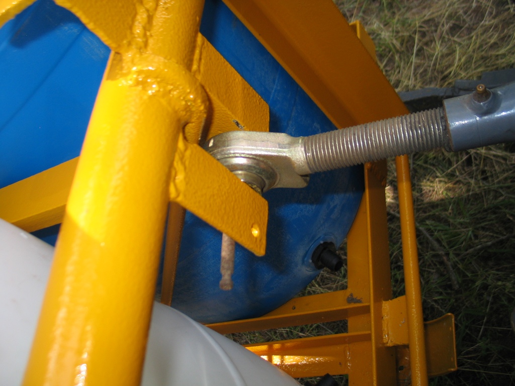

Okay, mostly assembled now with new paint, nozzles(teejet 8003s), 20' width, wet booms. will probably add some ports to the manifold system for a hand held gun and maybe a spray attachment to nuke over grown fence rows.
Here are some pics.
Still have some questions, should I connect both tanks simultaneously or put in an either/or valve? Also, I am thinking I should put an inline strainer in upstream from the pump to keep gunk from the tanks out of the system.

Yes you need a strainer between the tanks and pump.
I may have mentioned it but I install quick disconnects on my pumps and my sprayer ends. This allows for switching any pump to any sprayer or one pump between more than one sprayer. It also allows for quick draining of a system or pump. It keeps them from sitting there holding water or spray mix to prevent rust and freeze damage. I also pull my pumps off and drop them into a 5 gallon bucket of old oil. Since doing that for about 2 or 3 seasons no more pump rebuilds.

I'd valve both tanks into a "T" so you can pull from either or both. Are you going to have recirculation feed in to both to keep the chemical mixed?
   / Re-build Spray Rig
#20
I guess I could on both counts - the feed into the pump and then out of the relief valve back into the tanks(not upstream on the in side of the pump). I've seen the three way valves that let you feed option 'A' or 'B' but not 'A' and 'B'.
