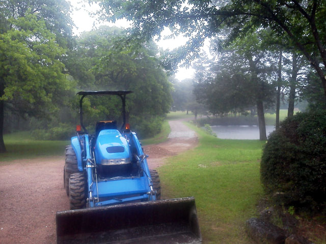

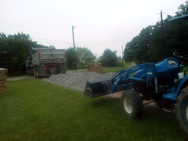

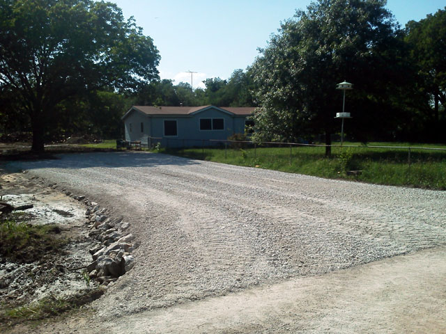

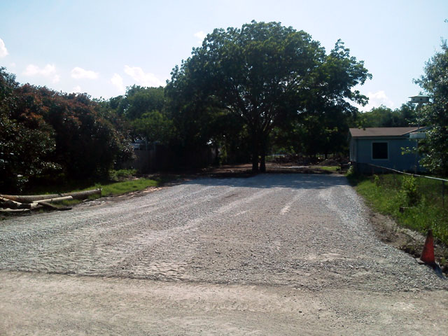

Week after week of rain, flooding, hail and tornadoes...I'm sure not getting a lot done this spring!
I did get the surge rock and driveway covered in gravel at the tree guy's place, so at least they have somewhere to park. Lot's of work to do there still, but the ground is too soft to get it done.

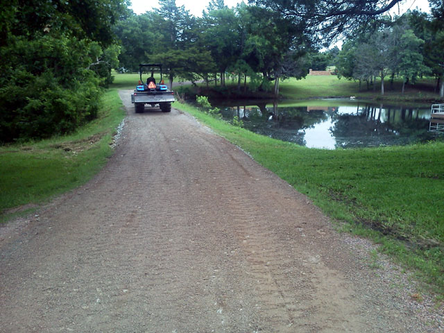

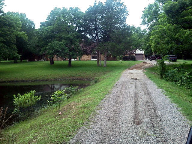

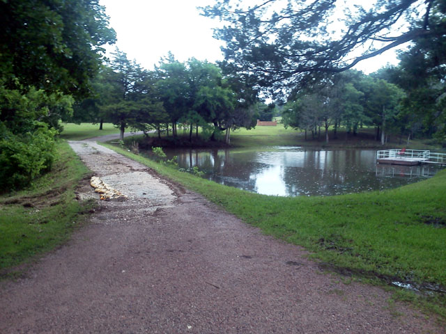

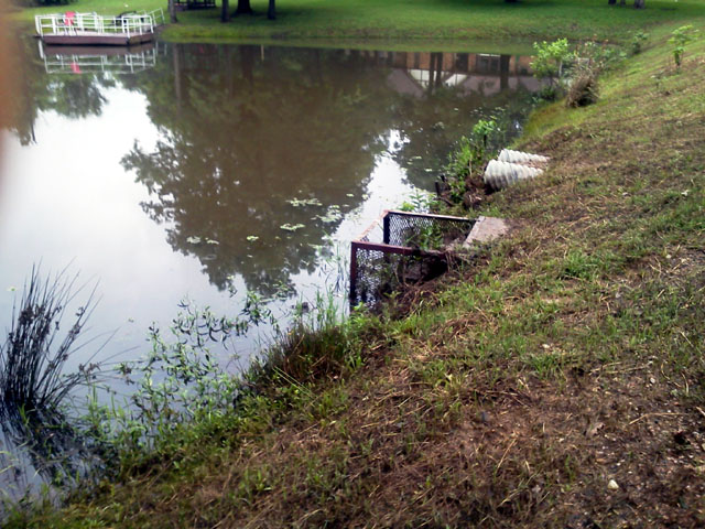

This pond is the last in a series of ponds. The outlet pipes dump into a stream bed. At some time in the past the original pipe was filled with concrete and two 15" pipes added. With so much flooding going on around here the two pipes couldn't handle the flow, so the water not only went over the designed overflow, but also took out the driveway closer to the home. There aren't any seep collars on the original or added pipes, so the dam has begun to leak next to the pipes as well. I have a plan to fix the problem later this spring, but the homeowner is hosting a wedding here in the next week and wanted to repair the damaged driveway for now.

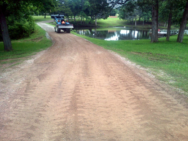

The existing base material here is a brownish 3/4" minus with a topping of useless granite peagravel. The base works in some areas, but it doesn't pack very well if it's laid down too thick. I pulled the peagravel and base back, then used 1.5" roadbase for the repair. After compacting the roadbase and spreading the existing materials back over the top, the driveway should be fine for the wedding. It rained pretty hard for about twenty minutes, so I sat it out in the garage.

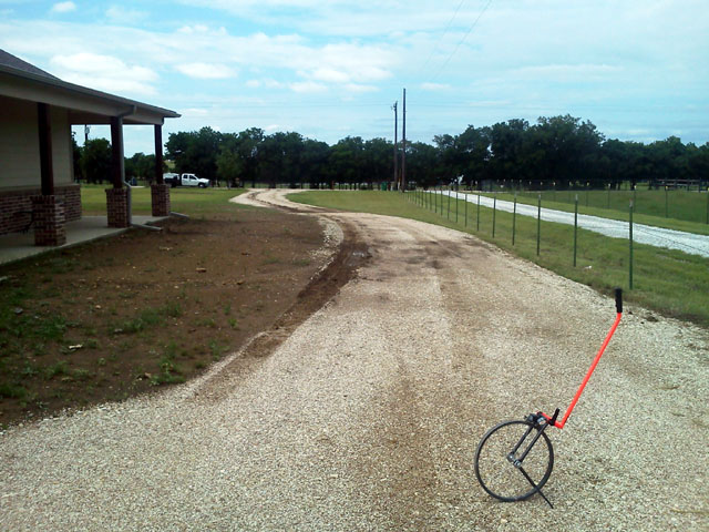

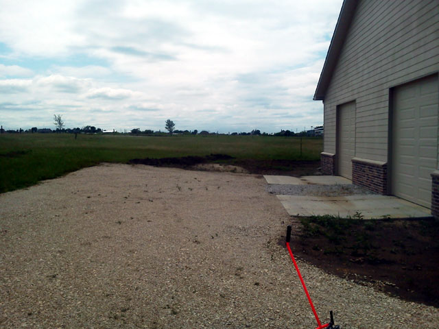

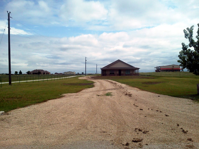

I would like to publicly thank my competitors for selecting unsuitable (cheap) material and showing a complete disregard for proper drainage (as usual.) I set a culvert pipe and precast concrete ends for this customer last year. Their builder included the grading and a gravel driveway in the price of the build. They used a couple inches of uncrushed river stone as a base with a few inches of uncrushed peagravel as a topping. Hard to see, but in the third photo the driveway is sloped more than 12" to the right.
