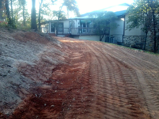

That's another fine job, John. That white brick sure looks pretty on that house, but the red dirt will splatter it badly without grass or something around that foundation. I don't see any gutters and we have rain predicted mid-week. Am I being over-reactive? Maybe, but I just don't like the bathtub ring look of nice new brick that gets mud splattered with our red dirt. Your job is great, but you'll have to let me know if I'm right or wrong about the splatter.
BTW: I've seen several stone retainer walls you've done and love 'em. I need to build at least a couple, and I'm quite sure I can't do it all by myself. There's no hurry and it can be done anytime, but if you are over in this Decatur-to-Bowie area sometime, I'd love for you to look at it and put some numbers to it. I have one short 30' wall with a corner that needs to be done first and then a long wall along my yard at the driveway apron. I'll PM you my email and I can send you some photos to get an idea before your having to drive this far. I've seen enough of your work to convince me I've found the right person to do my work. Also, I have a 'few' pieces of equipment to help with the job.:D
Rain??? No!!! I've got way too much to do! :D
Jim, I agree on the red dirt / brick issue. It's a pretty typical owner/builder "building steps not in the correct order" scenario. The customer is trying to get a final on the home this Monday. I'm putting in a narrow roadbase drive for now, and they'll pour concrete later.
On your wall, shoot me some info and we'll get together and figure out a plan. :thumbsup:

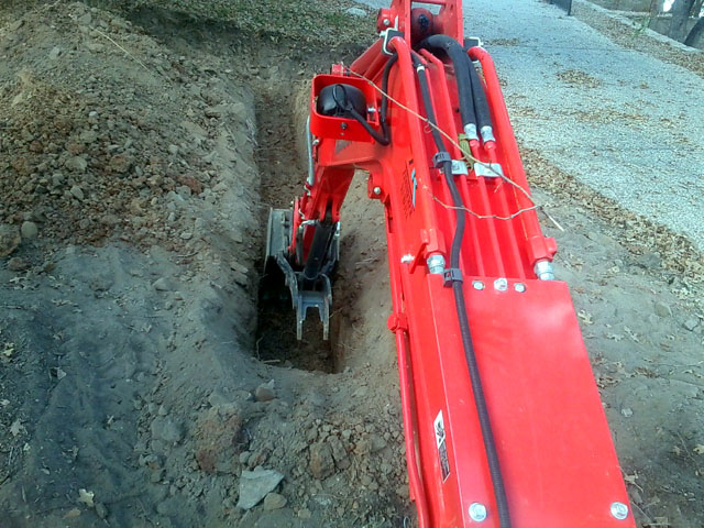

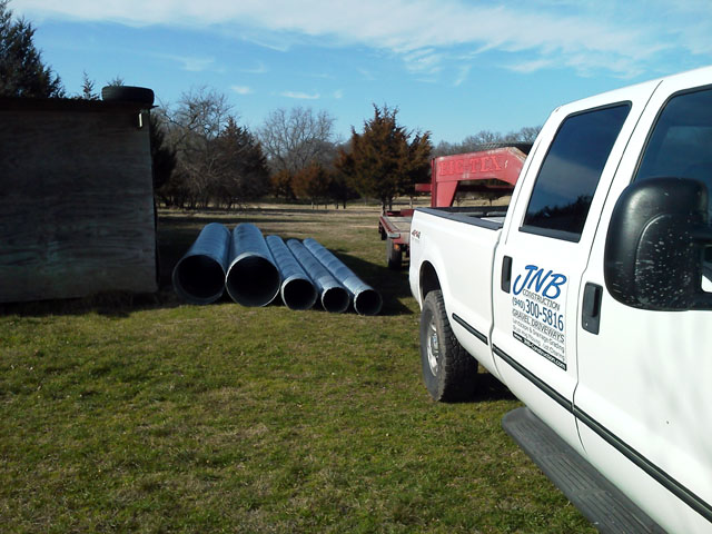

I picked up and dropped off a few culverts for a job today. The project is for a couple of members (husband and wife) here on TBN. Even though the job is quite a ways away from my main stomping grounds, I've been looking forward to it for quite awhile now. Great folks!

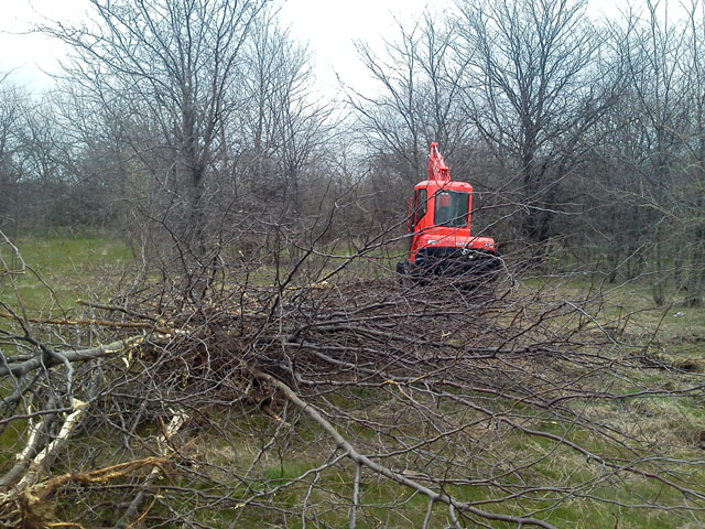

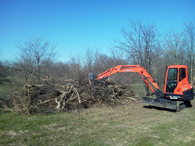

Did some clearing for a new private drive. Mmmmm...forgot to take pics of the big tree pile.

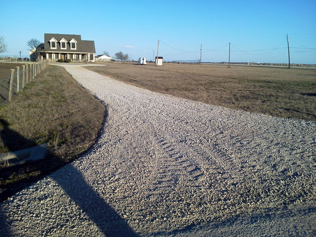

Graded and graveled a driveway today. I'll be back to compact it along with a few others nearby. I can offer better pricing to the customers that way.

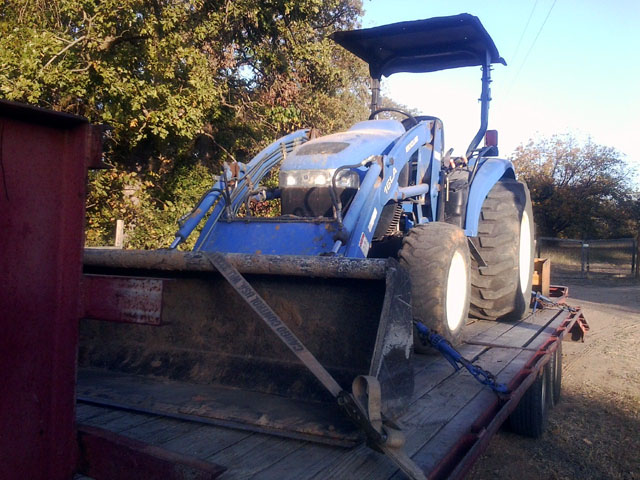

After failing to duck low enough while walking between my truck and GN trailer yesterday afternoon...which resulting in me smacking my melon against it and landing on my back in the parking lot at my local fuel stop...I decided to take it a little easy today. I feel like I got hit by a...trailer.

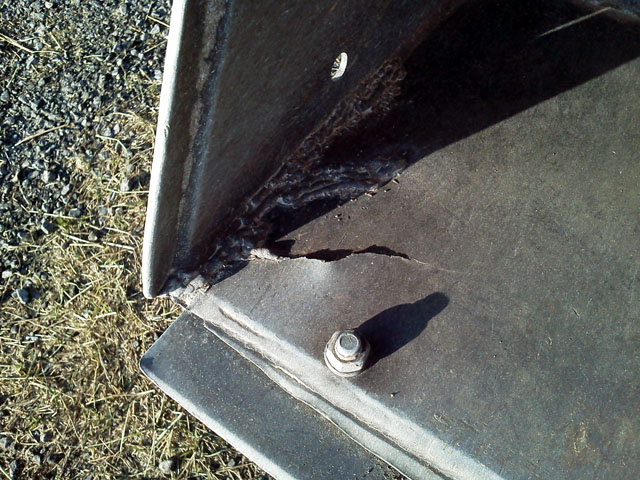

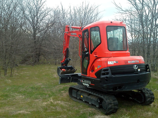

I noticed last evening that I had once again cracked the bucket. It probably didn't help that the bolt on the cutting edge was loose. I'm not a welder by any standards, but I get it done and it holds. I also developed a leak earlier in the day at one of the loader quick connects.
