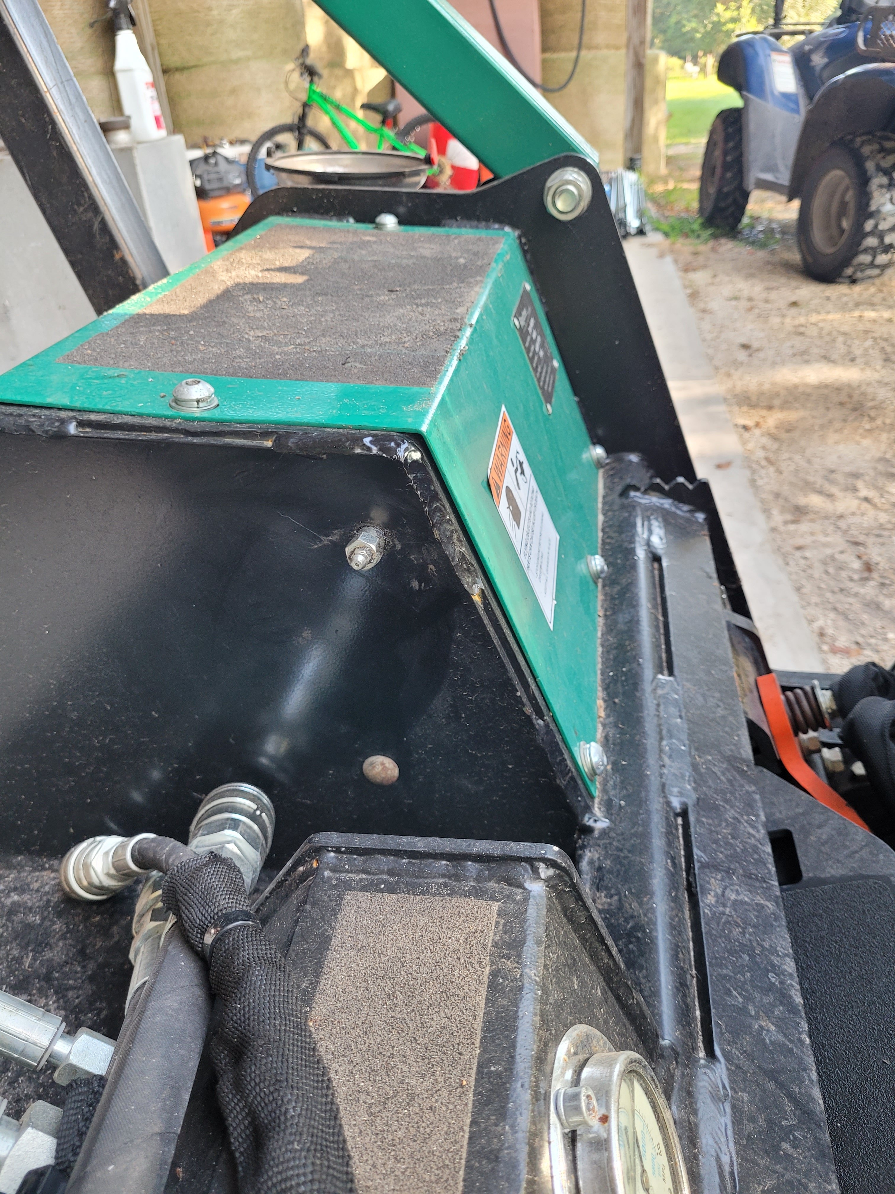

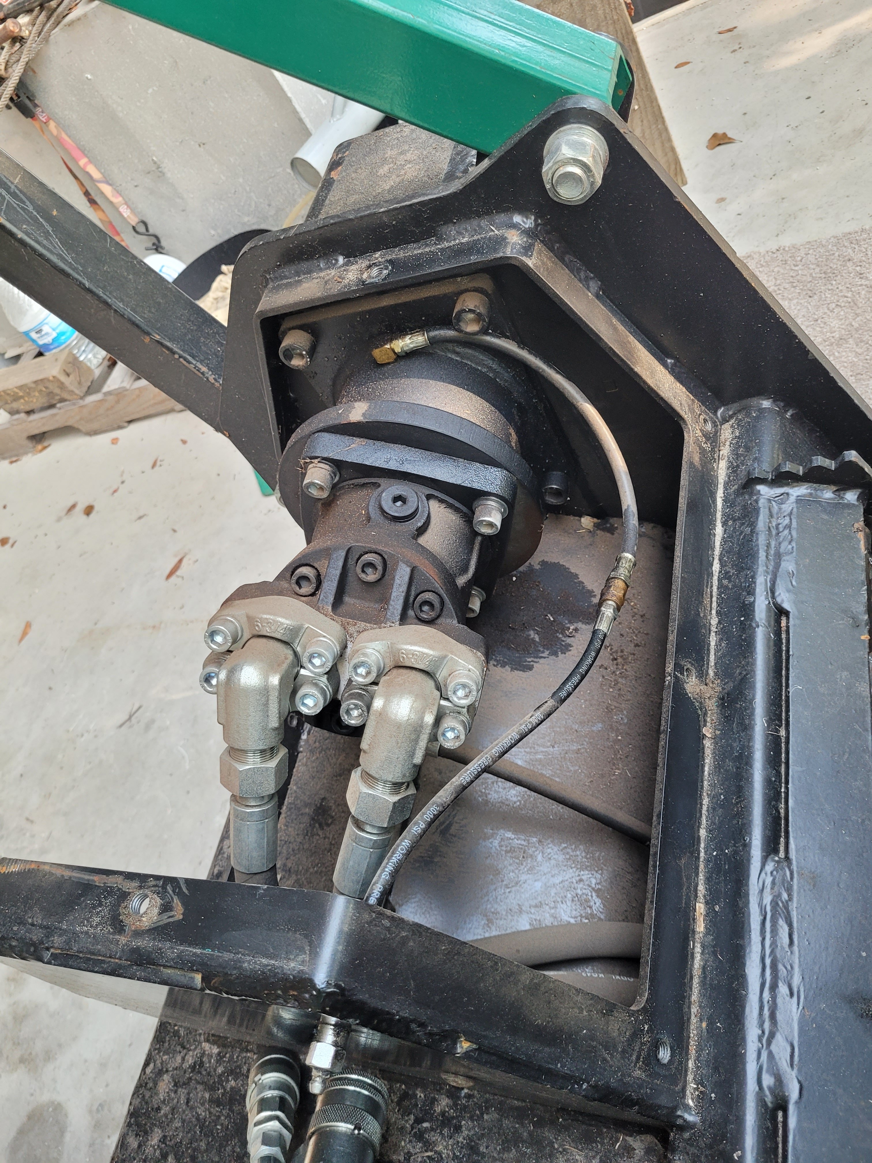

Could you put a pic up to see how you did the grease nipple extender out of curiosity please?
While I was swapping the pulleys this morning I snapped a couple of pictures of the grease nipple extension.
/ Raytree drum mulcher #44
While I was swapping the pulleys this morning I snapped a couple of pictures of the grease nipple extension.View attachment 3981936View attachment 3981937
Well alright Charlie, you will see a big difference in the way it preforms. I just run mine this evening for about 30 min. I wish I had thought about this from the start. The pieces it mulches up are so much finer now. It still isn't a high flow, but I am doing it for myself so I can go slow and do my place like I want to. Great Job !

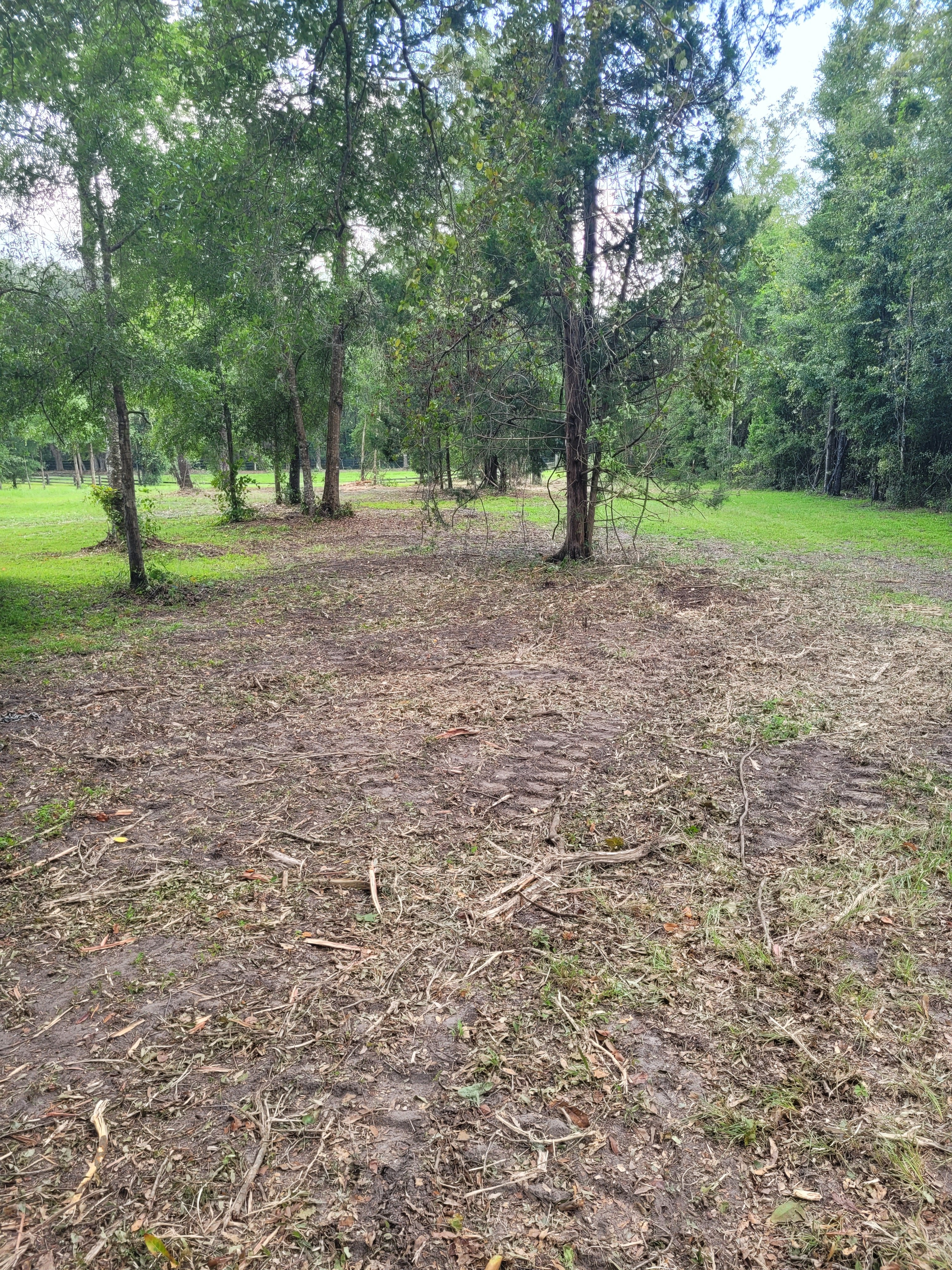

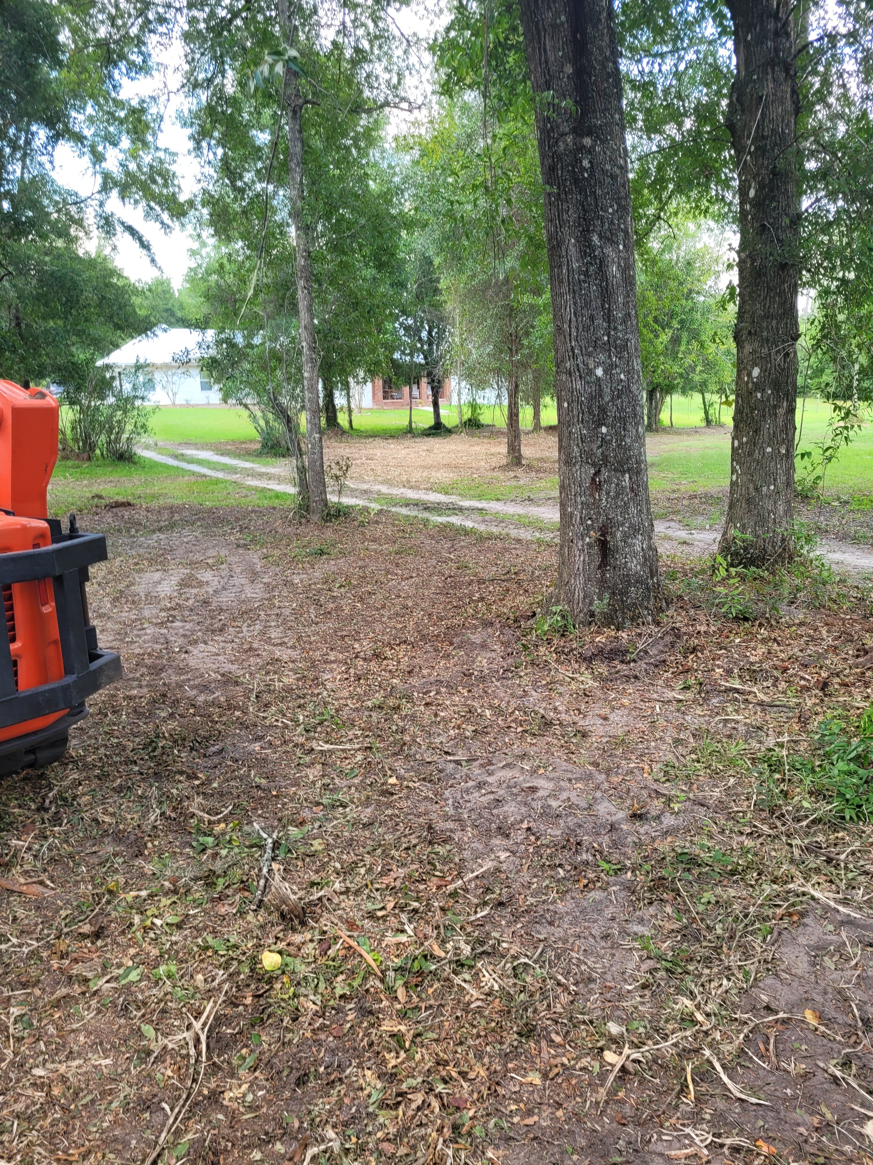

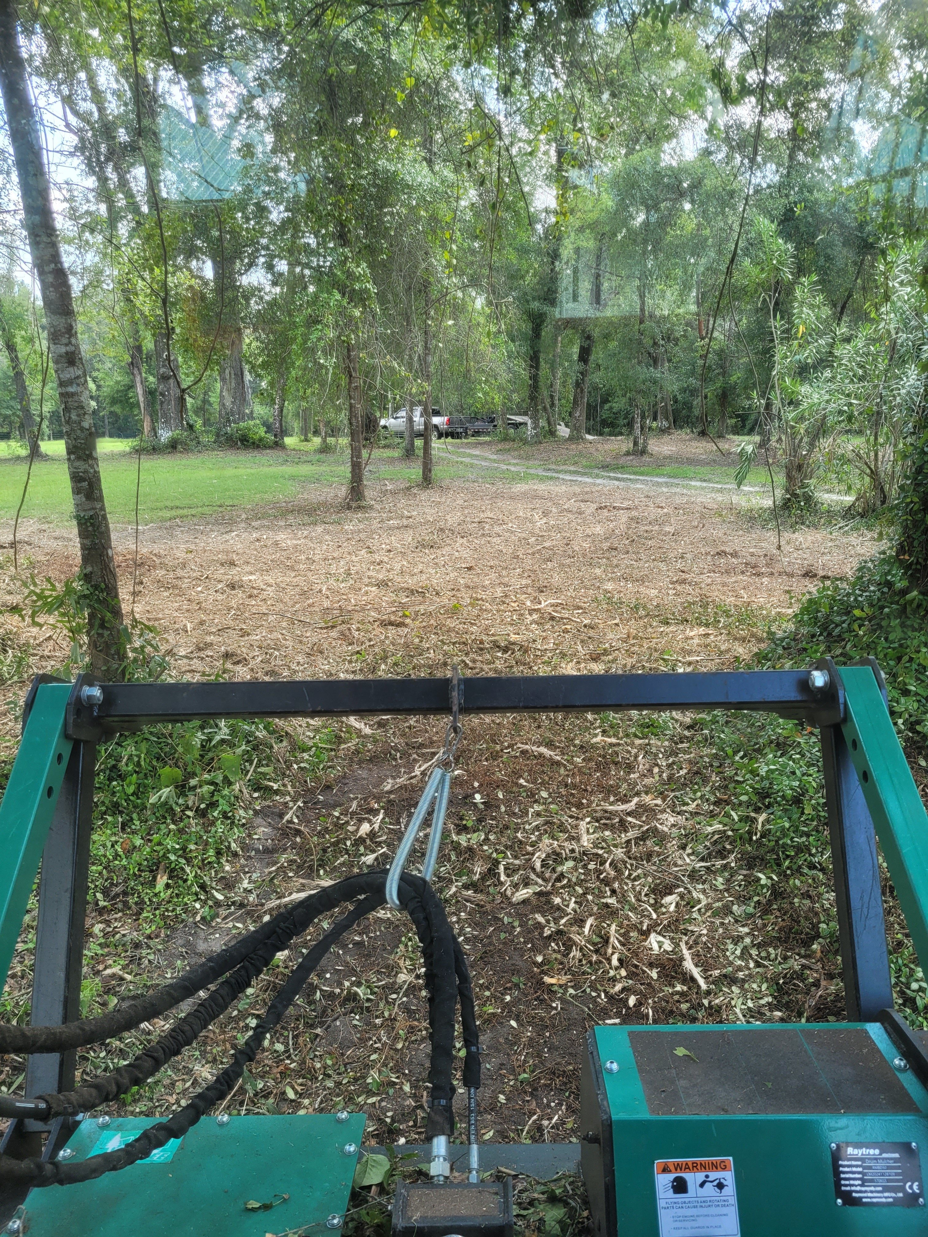

Did a job with the newly transformed Raytree mulcher and it definitely performed much better since swapping the pulleys, it did a good job on some 2"-3" hardwood oaks for a low flow mulcher.
