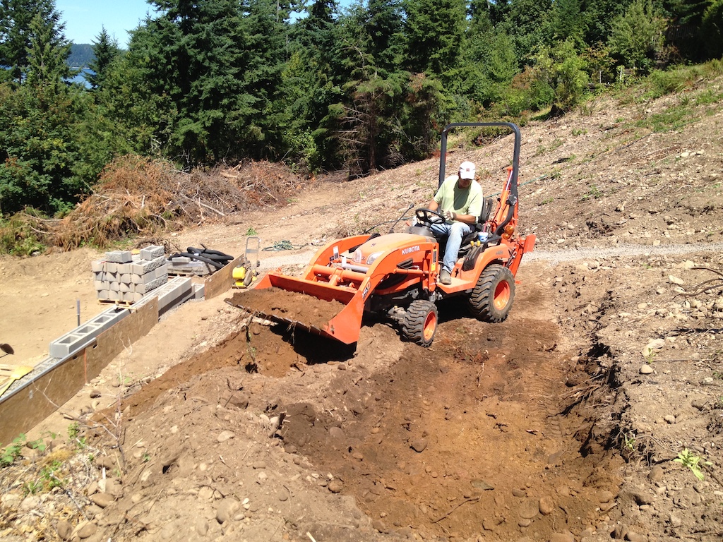

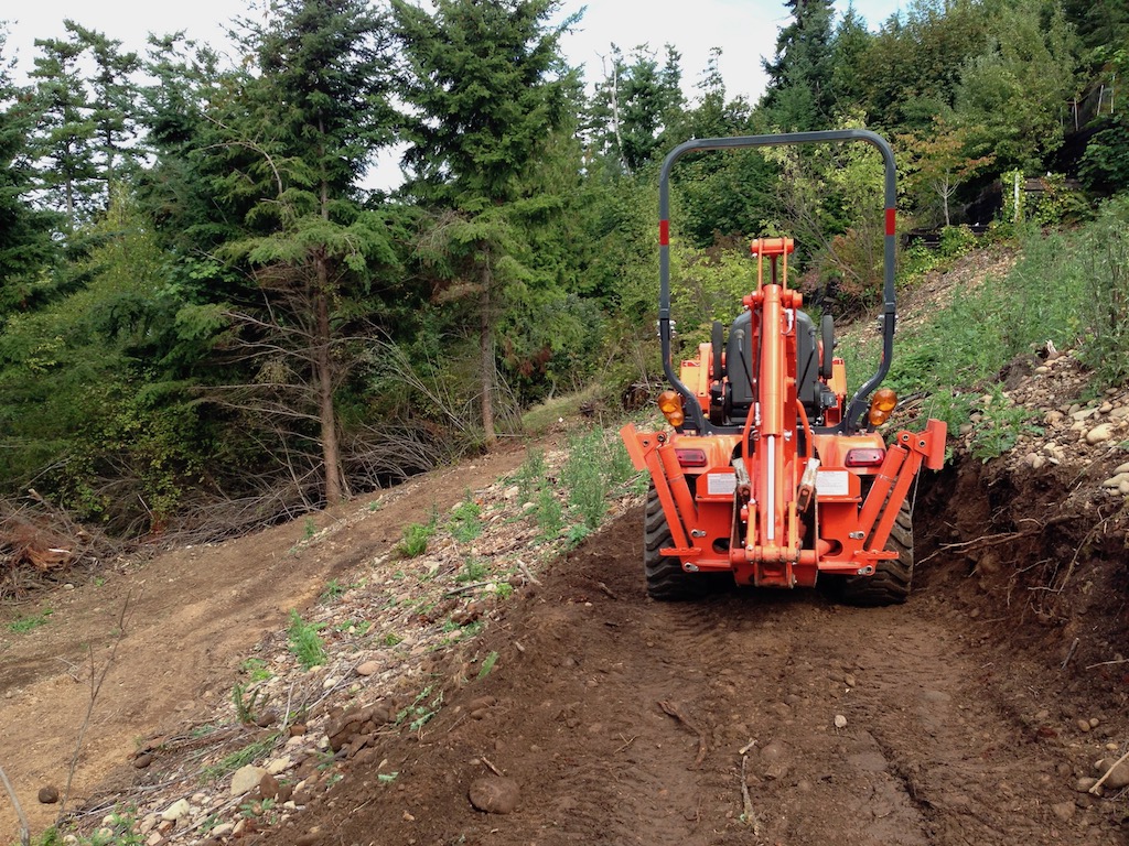

JT, I won't say I love my PTB. Done that many times in other threads. :laughing: It is a great digger. My soil is glacial till so lots of very compacted ground with too many rocks from golf balls to volleyballs common. I have torn out a lot of blackberry bushes and small vine maple and other deciduous bushes that turn into trees if you let them. I go a bit subsurface to really rip out the roots and such because I have turned the areas into paths or grass.
I think the PTB makes a pretty much useless bucket for digging into a weapon. I treat my BX like a bulldozer with it. Actually surprised I haven't messed up the cylinder or bent something because I go as hard as it will take (weight/hp wise). Never owned a RR. My PTB has never come off. I grade gravel with it but that is one thing I imagine the RR would be better. See pics of side hill cutting using my PTB. To me it is a no brainer if you are digging.

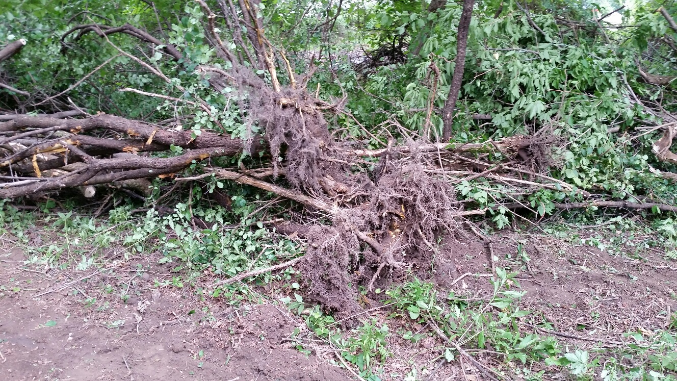

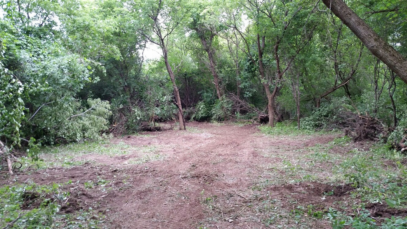

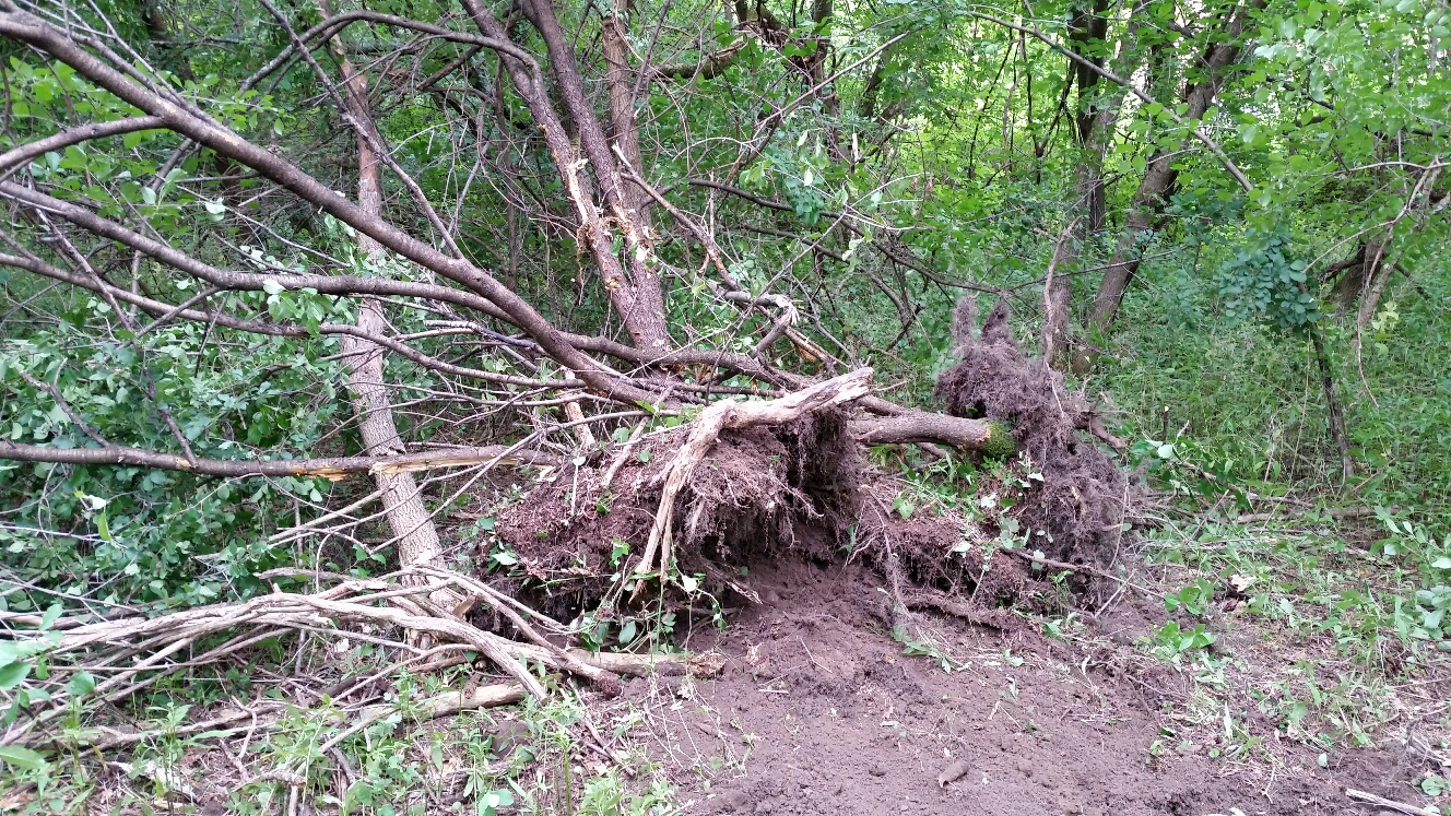

Used the Piranha bar for several hours today. Thought I would post some pictures. Push over sapling/tree (1" to 5" in diameter), get under root ball below ground surface, curl up bucket and push. Shear off roots. Push out of the way. Last picture is the area that I cleared in a couple of hours this afternoon.
Looks great. I've cleared large areas like that using my JDUNN Grapple which is a somewhat slow process. Have to come up to them, close arms and then push and lift and then take the saplings to the closest brush pile. Looks like head on with an attached implement would be quicker. What size/HP is your tractor?
   / RatchetRake or Pirinha for my current needs? #19

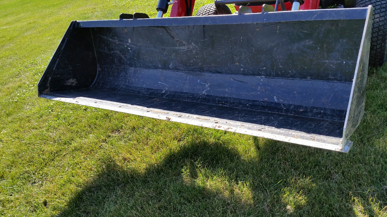

My tractor is a Massey 54 hp hydro. I've been doing this for a couple of years using an HLA bucket with no cutting edge just using standard bucket edge. See picture. You kind of develop a technique as you go. In a lot of my areas, there are several small trees/sapling close together. With some planning, I can push over several saplings/small trees at once. Grab the roots and push. The key is to try to grab the root ball in away that you get the trunk and roots and leave as much dirt as possible. With the Piranha tooth bar, I can easily double my productivity versus the standard HLA bucket. Also, with the PTB, I can handle bigger small trees because the PTB cuts larger roots where the standard bucket wouldn't. One added bonus with the PTB, is I can easily get under the root ball with the teeth and then drag the small tree in reverse to an area where I can push it out of the way. Adds to productivity as I don't have to get out the cab to manually move debris all the time.
