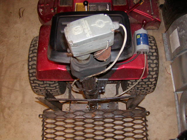

beenthere, Good Idea, I presume you are talking about something like a satellite dish actuator. If someone isn't making one, maybe that should be something for the drawing board. You rang my bell. Attached is picts an old one I put to great use last year. Since I am about over the hill, I have to look for easier ways to do things. I change a lot of air conditioners by my self now & got tired of dollying them around the houses.
Just tried it out of things on the place. Couldn't even find the voltage on the motor, but hooked it up to 12 volt battery & it worked. Someone told me later the actuator was rated at 1500 lbs. Of course, had to add a little concrete & railroad iron to front of mower.

Close up of lift
