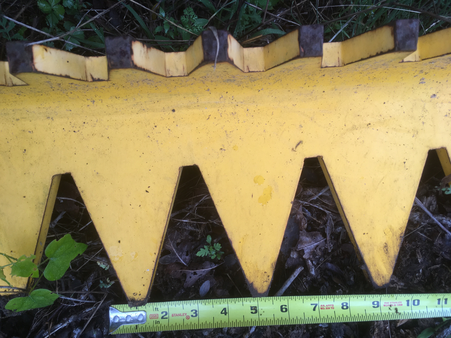

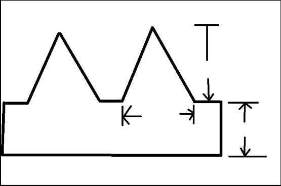

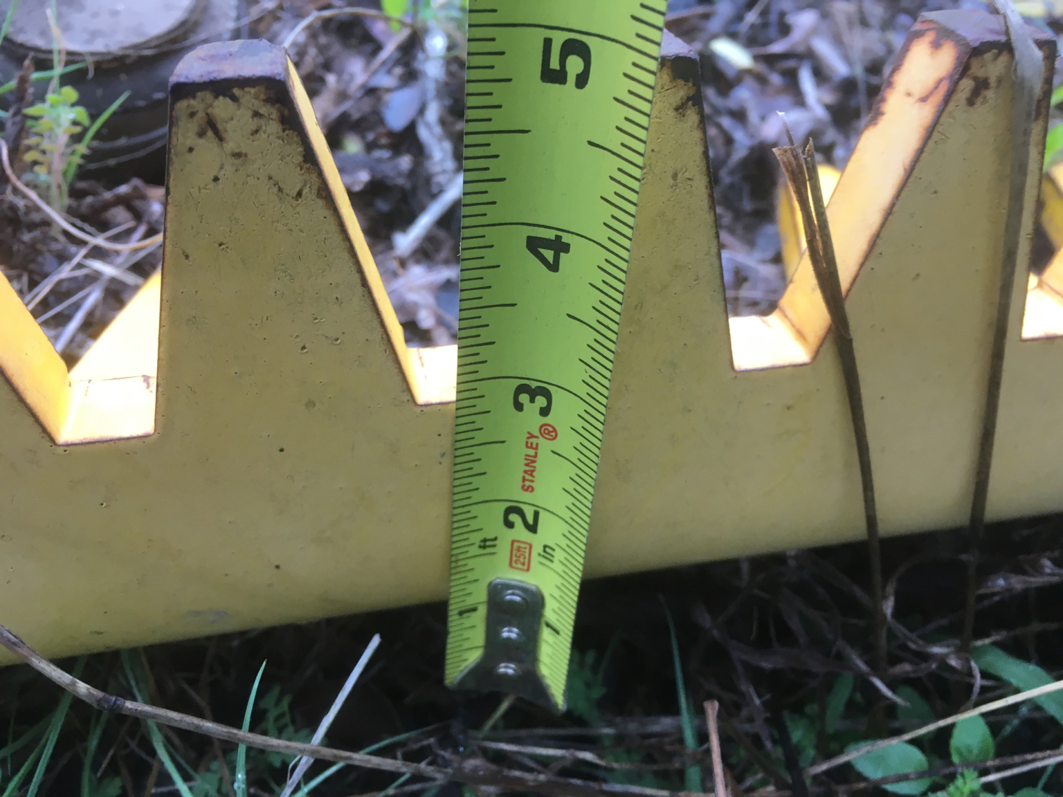

I'm looking to build myself a ratchet rake, was hoping someone with one could provide me with a few measurements. I've already made up a template but I'd like to know how close I am to the original.
I attached a crude picture depicting the measurements I'm seeking, for both the large and small teeth. Thanks!View attachment Image-012.bmp
I attached a crude picture depicting the measurements I'm seeking, for both the large and small teeth. Thanks!View attachment 501686

I'm 4 hours from the nearest border and I enjoy little projects like this. I can get the steel for about $130 and it would cost me over $500 to buy the real deal. The ratchet rake website says they use A36 steel which I think is just your everyday basic steel. Someone please correct me if that's wrong as I don't know much about the different grades of steel, just going by what I read after a quick Google search!
I guess its certainly possibly that they are hardening the A36 themselves during manufacturing.

I'm also on the fence with a ratchet rake. I really want one, but making one is pretty simple.
A36 steel is nothing special. Very common and easy to get ahold of.

I just ordered the 60" from the manufacture wasn't worth the time and trouble to try to build one but I'm in the states. While doing my research I did run across a thread on one of the forums (maybe this one) that detailed someone building one. He showed his progress and posted his upgrades as he discovered what not to do. Sorry didn't keep the link but Google should find it.
I do remember he didn't use heavy enough steel on his first version and it broke, he used a plasma cutter to make the teeth.

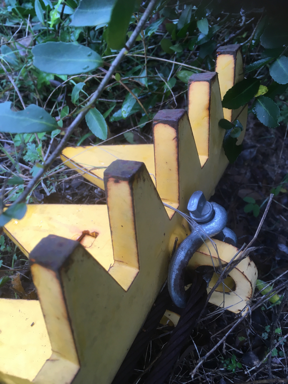

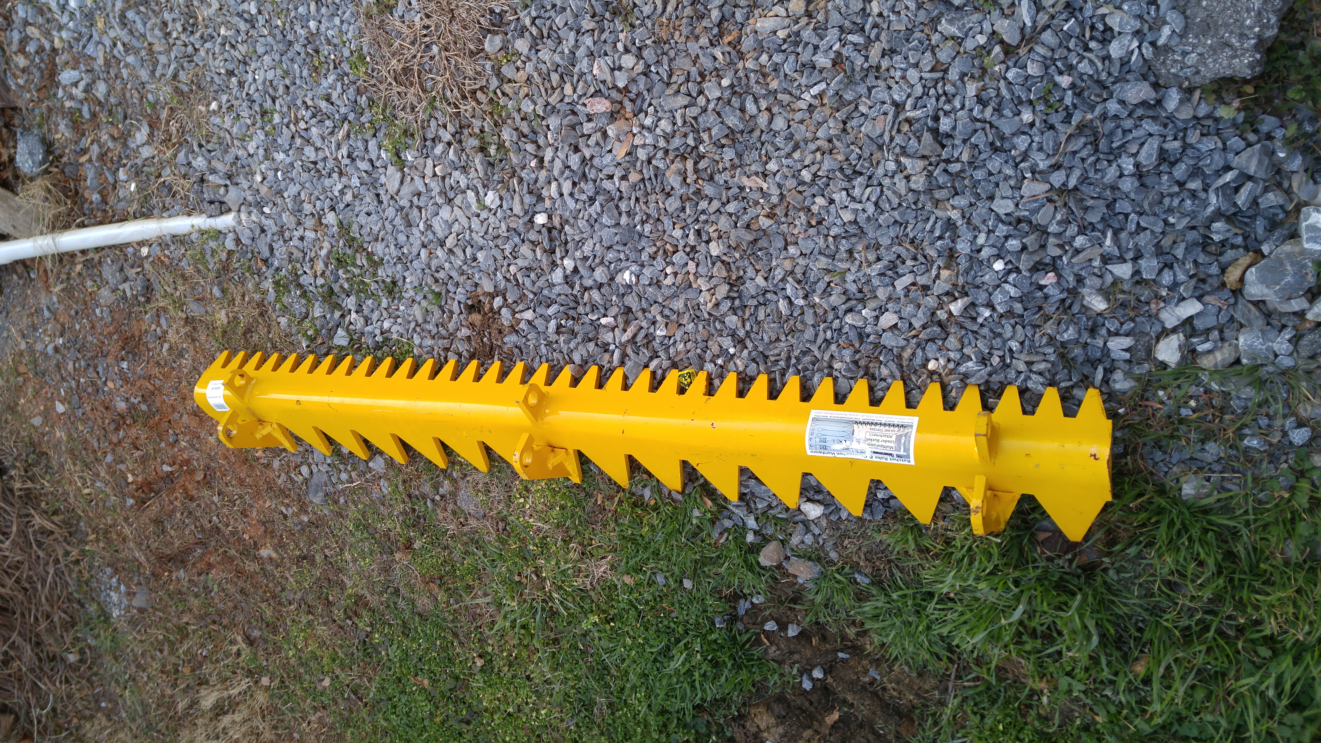

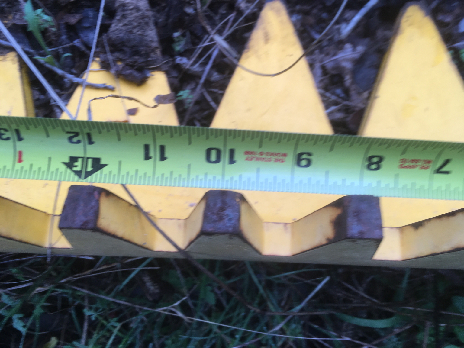

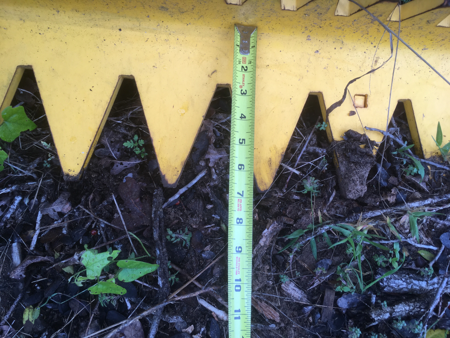

When I clicked your image link it downloaded, instead of opening, so here it is for all to see. :D

I think they have blunt teeth instead of the fully sharpened ones like you have. Edit. The ratchet rake has triangle shaped teeth. It's the piranha bar that I was thinking of with trapezoid shaped teeth.

1489338975527.jpghere's mine
