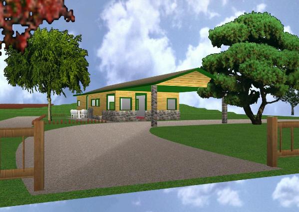

Computers are a wonderfull thing. A friend and I went in half on a Punch Super Home Suite software package. I planned out PHASE I with it. Of course I couldn't get it to mimic log siding, large timber posts & beams or the planned patio roof, but it has worked out well as a creative aid. The attached picture has the future carport and circular drive.
PHASE I:
resturcture walls to 2"x6" and insulate
1/2" sheer wall chip-board
new double pane windows
half-log siding
carport and patio cover addtion

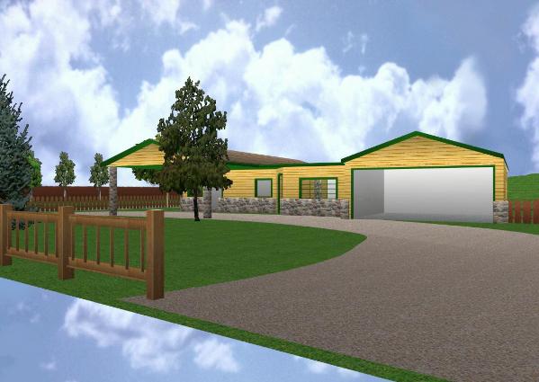

Phase II will make the place a home that I can really enjoy. A large 20'x30' Great-Room and 1/2 bath will be added to the right side relocating the front door at a 45 degree angle. Although I couldn't figure out how to make the software produce a high vaulted ceiling with full glass wall (like so many log homes you see in magazines), that is the planned look for the center section Great-Room. Next to that will be a two car garage with a large master bedroom behind, walk-in closet and full master bath with corner tub-jaccuzi and separate shower. The log home will end up in a horse shoe or "C" shaped ranch house with a center patio off the Great-Room in back.
Dreaming is fun, doing is work! /forums/images/graemlins/crazy.gif
