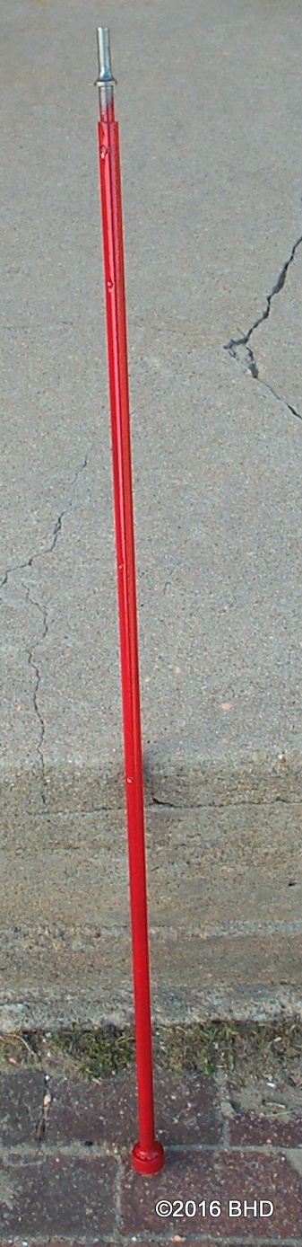

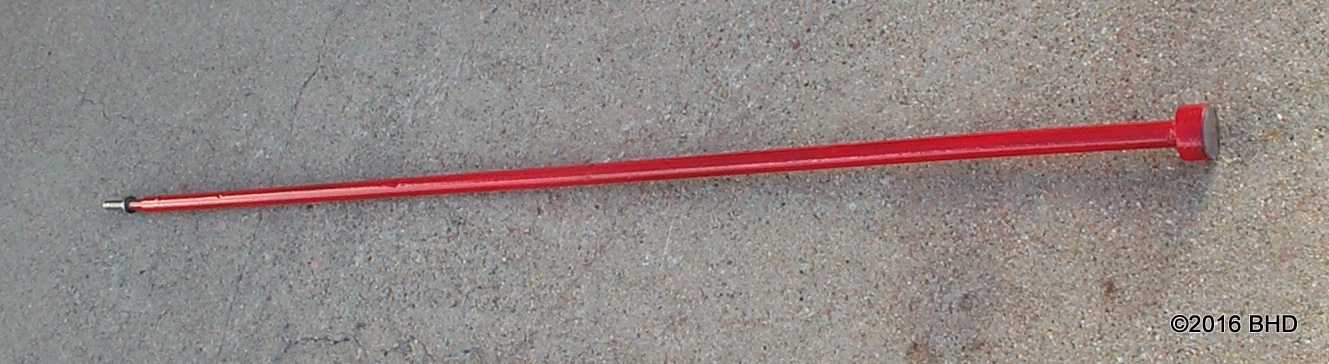

I trued my air hammer tamper today been setting some more corral posts,
Using an Ingersoll Rand air hammer,
it is working better or better had hoped for, it is actually packing the back fill better than I was getting with the manual tamping bar, and reasonably fast.
